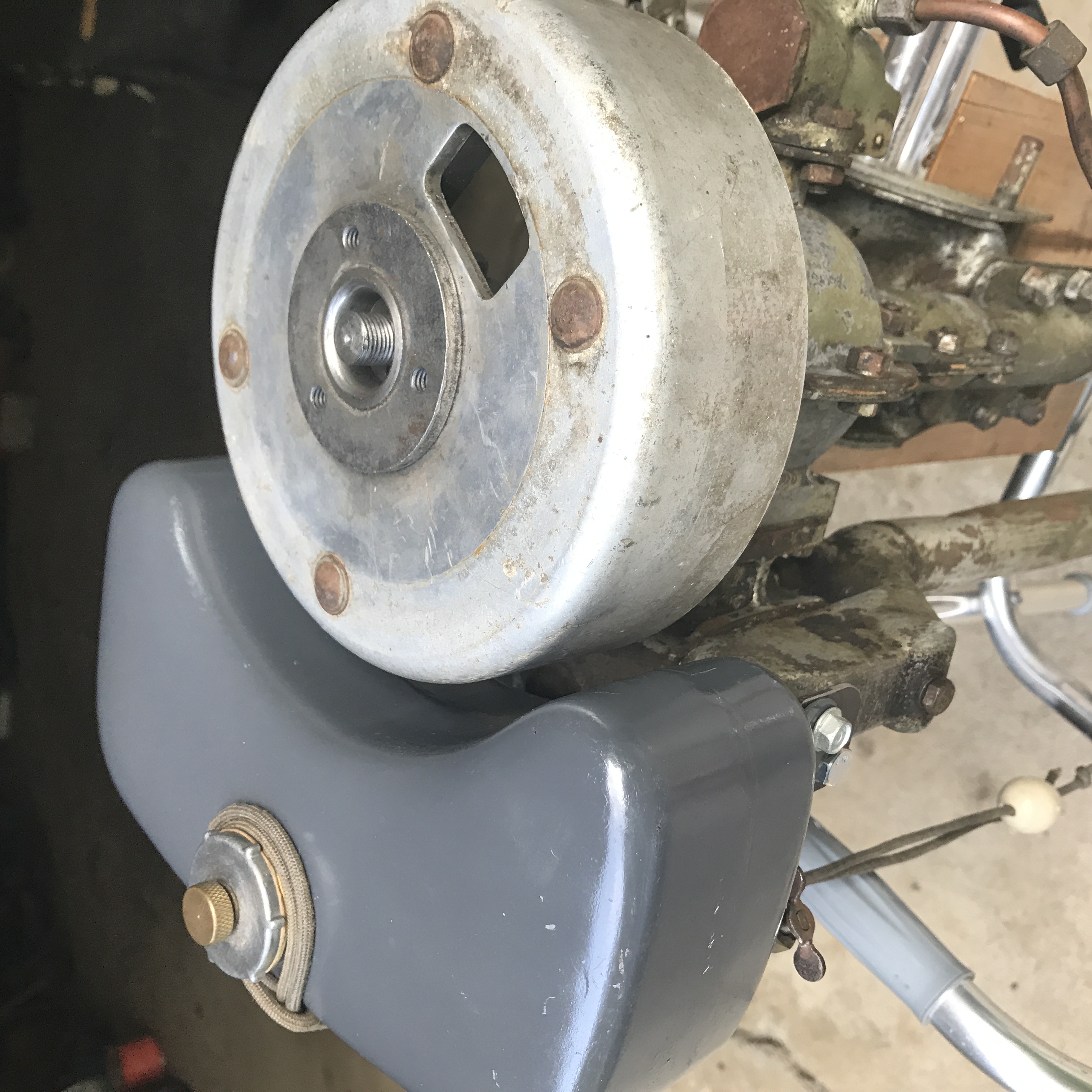

    tom-c
      One more.
      #62558
      brianm
        Another place to look is the transom clamp area, the part of the flange that sits on top of the transom. Some of the other very early sea kings had the serial number of top there.
        #62607
          The shot of the lower looks like this one, identified as a 1937 single:
          at http://www.joeoutboard.com/forsale/thorsingleforsale.htm
          As opposed to the 1939 streamliner:
          And 10519 fits in the 1937 single serial number range posted here: https://aomci.org/forum/viewtopic.php?t=12124#p63946
          #62630
          tom-c
            Looks like we are narrowing it down! I guessed 1935 but you may be right about the serial number. Next question – did all the Thor singles of this era have that rolled steel lip on the back of the tank?
            #62662
            PM T2
              Early THor’s (1935 and 36-ish) had the angled lower unit and a tank without the lip (aka grab handle ledge) on the lower rear seam.
              Later Thors (I’m suggesting 1937 and up) starting using the grab ledge on the tank and almost always had the round steel stampings for the gearfoot.
              Hope this helps.
              best,
              PM T2
              #62677
              ROBERT LAFAYETTE
                #62678
                count
                  So 1937 it is! Just have to figure out why the S serial number. And i need to find the proper tank with the rolled lip on the back.
                  #62686
                    S for single?
