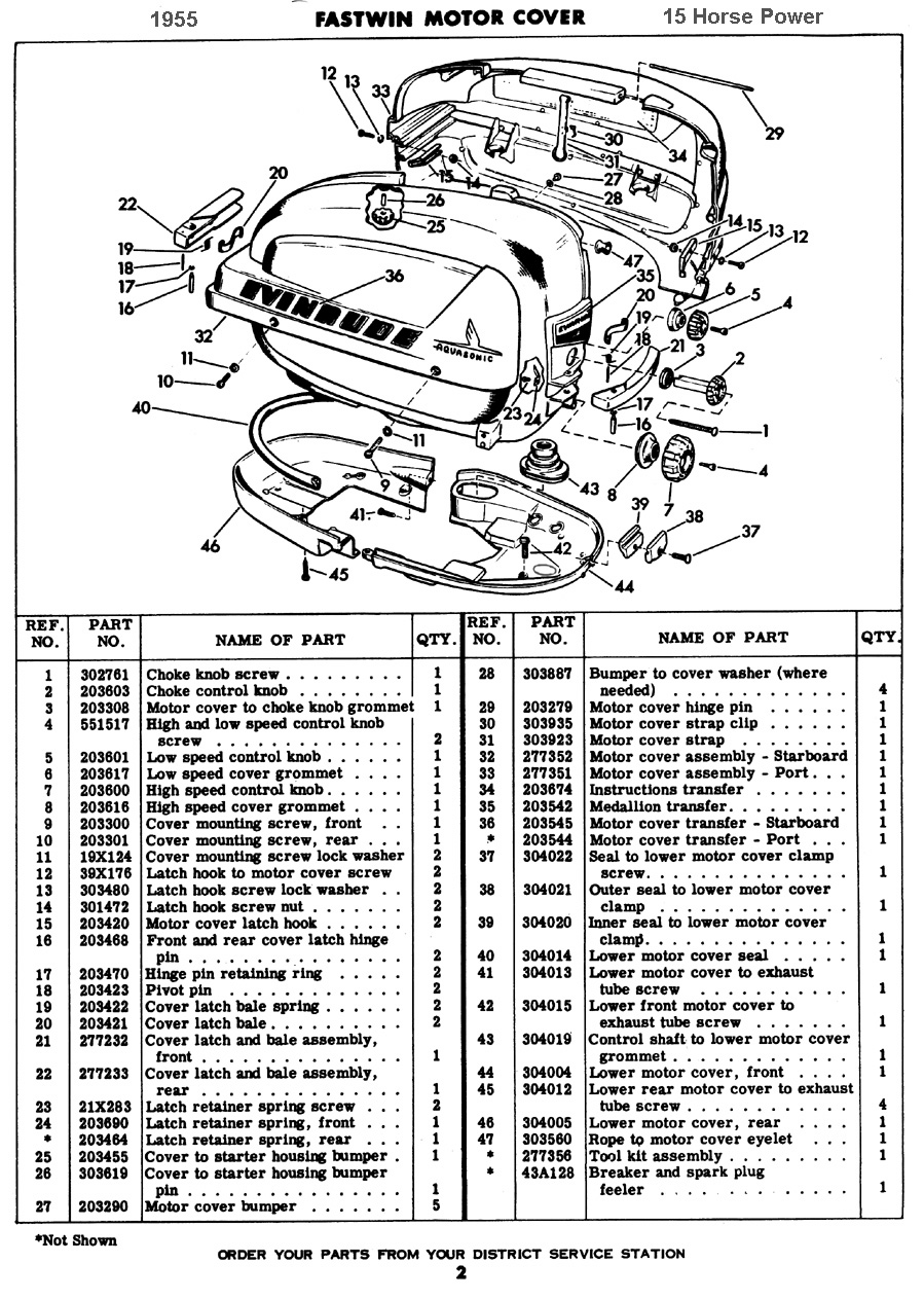

        Well, I think you would have to use a complete electric start flywheel/ring gear/rewind starter along with starter motor/bracket wiring. A big undertaking. The 1955 rewind is a different style than the 56 and newer engines. The only other thing left to question is if the rubber bumper positioning (shroud mount) is the same for the 55/56 models.
        #11756
        weedlessdrive
          That was what I was wondering if it would interchange with the same cowl.
          #11758
            I’m fairly sure the cowl would be no problem. But all the other stuff may be a challenge to gather up.

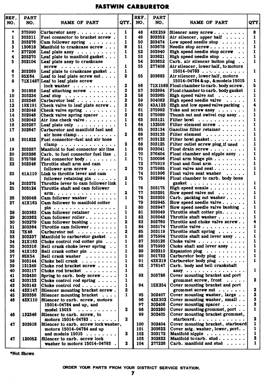

              You would need the starter bracket and starter. The bigger flywheel with the ring gear. A carburetor bowl with a 12 volt choke solenoid.

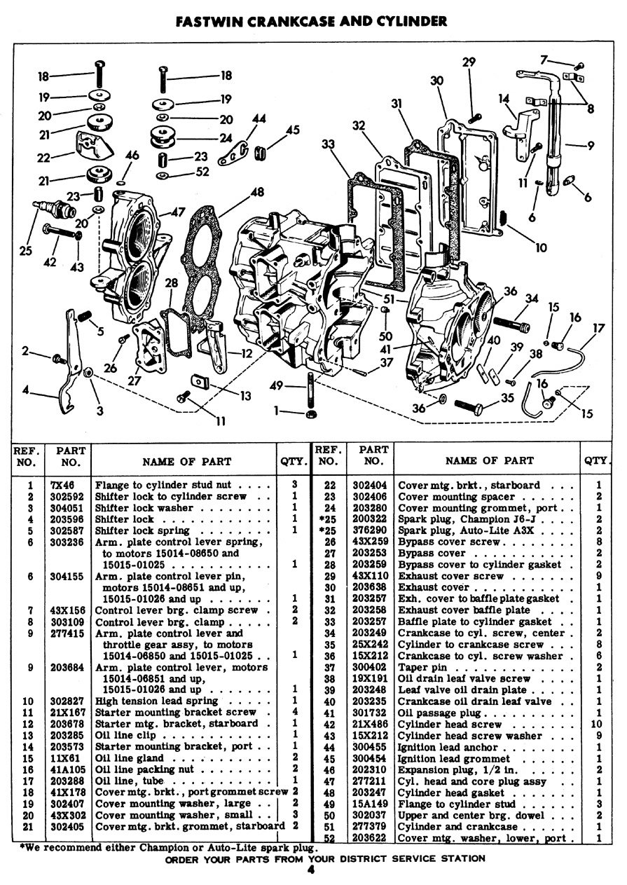

                      With apologies for the above post.  I have been working on a couple of 1956 15HP motors and should have read that the questions were about a 1955 15 HP.
                      I did look at some pages from a 1955 brochure that I had downloaded from the “old OMC” website.  It appears that the factory did not offer electric start on Evinrude 15 HP until 1956.  It should be checked to see if the 1955 crankcase will accept the 1956 bracket that holds the starter.  (Likely it will not.)
