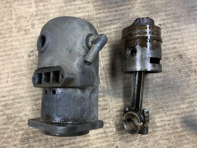

        Coincidentally, Evaporust helped unseize this late 1920’s Evinrude RBM powerhead today. Two days soaking and then a couple heat treatments with penetrating oil is all it took. Admittedly, it wasn’t too rusty inside. Keep in mind this photo is after the Evaporust bath.
