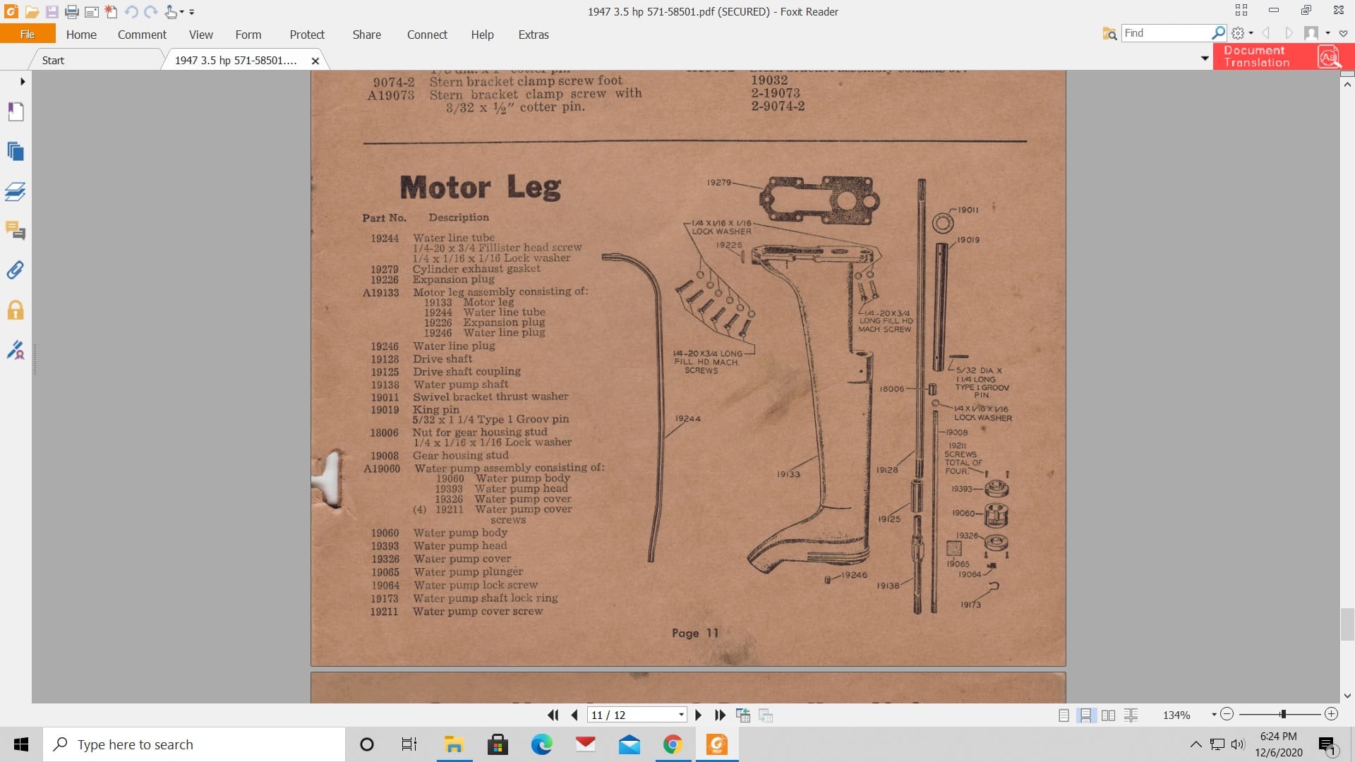

      Working on a wonderful (?) ’46 2 1/2 hp Elgin. I probably don’t have anything which will interchange with the worn out water pump, but I have to look. Okay, how do I get the lower off to find out? One 7/16 bolt exposed, now what holds the rest of it on? Hopefully not something under the powerhead.

          This one shows a long bolt, but not sure how you unscrew it!
          Elgin
          #224433
            You have to remove the powerhead, then the steering pivot pin (19019 King Pin). It is held in by the groove pin at the bottom. THEN you can remove the special nut 18006 from the top end of that long stud 19008. Probably will have to concoct a special slotted screwdriver.

              That is what I was afraid of. Might as well take it all apart, since I’ve gone this far. If I can find or make a pump, I’ll go further. I also have the littler air cooled model, so that won’t be a problem. Thank you for the help.
