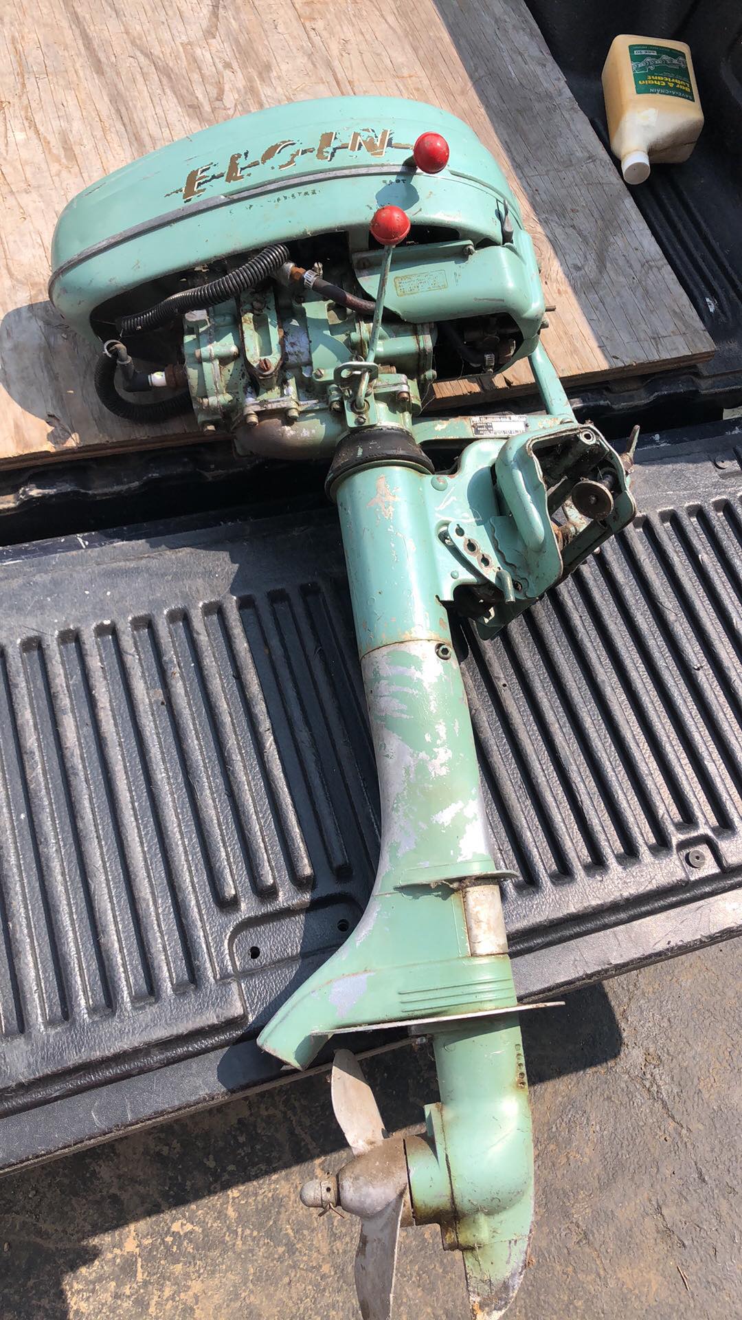

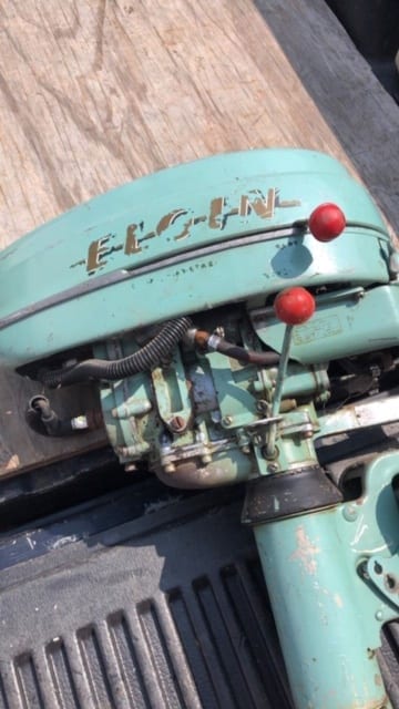

What does it say on the metal tag on the steering handle?
October 13, 2020 at 1:40 pm #218462No idea, pictures are from the seller.
October 13, 2020 at 1:44 pm #218463They were made for several years in the 1950’s. I’d put this one in the late ’50’s.
October 13, 2020 at 8:24 pm #218489Looks to be 5 or 7.5hp outboard with the neutral clutch. It is probably a 7.5hp Elgin. See if the seller can send you the model and serial number on the metal on the tiller handle.

Also, are those red handels common? I can’t find any photos showing those. I did buy the motor for $60.00 the other day. -
