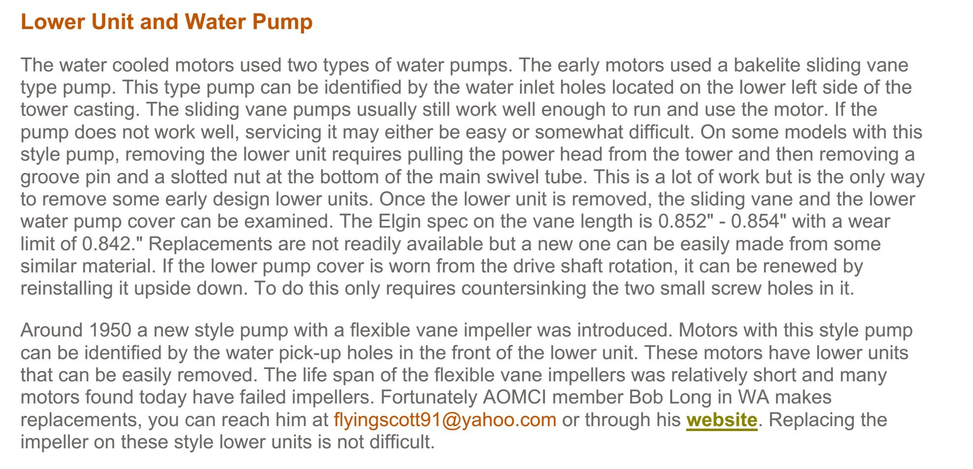

      I have an old pdf file from an apparent “no longer existent” web page
      of Jim Melgin Outboards. (in part below)
      In the file, it mentions that Flying Scott (Bob Long) made the replacement
      impellers needed. I know from memory and searches herein, that
      Bob is in “outboard heaven”.
      Did anyone take over his impeller production, and if so, have contact information?
