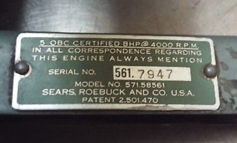

      Recently acquired Elgin but I cannot find what year it is. model 561 11993. any info would be appreciated, thanks
      #72213
        Look again for a number starting with 571.xxxxx or 574.xxxxx. Most likely 571.xxxxx
        Otherwise, post a picture.
        #72263
        ronboonville
          still says 561. I’ll include a pic when I can. it also says sears on the tag.
          #72266
            Pretty safe bet that you have a model 571.58561 1951-52, 5hp
            Go to http://www.yankeeaomci.org/feature_outboard-2.htm and scroll down to the paragraph tilted "Model Identification" to see how I arrived at that conclusion.
            #72268
            wagemaker
              Looking at this tag, I can see how it could be read wrong, especially if scratched or dirty. I agree with the above posts.
              #72380
              ronboonville
                Okay, got the motor upright and in better light and can see all that info nòw. Thanks
                #72388
                  As the tag says, it’s Model no. 571.58561
                  which translates to a 1951 5 hp.
                  Note that the end of the model number is "561",
                  which is the start of the Serial number.
                  Confusing.

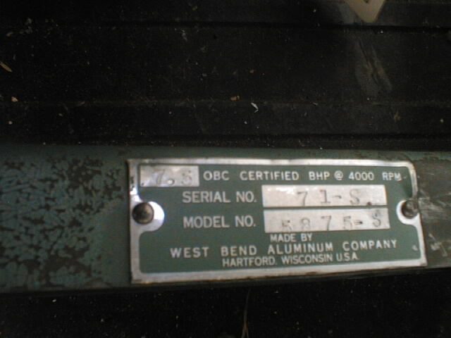

                      Can someone explain this plate? serial # 71-S model # 5875-S
                      #72455
                        FastJohn, Wonder if your outboard is this one……
                        571.58751
                        1951-1952
                        7.5
                        2 x 1 11/16
                        10.6
                        0.020"
                        1/2
                        J11C
