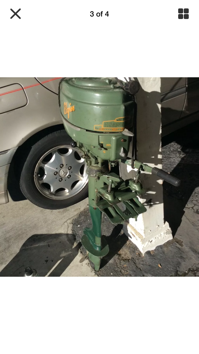

Can he demonstrate that it at least runs? Elgins were fairly good motors, and Sears sold tons of them. But parts are not very easy to come by, depending on what you need. Members here can help you with parts if you post a free want ad on the classified ads forum.
Price is a sticky question, that most of us shy away from. Too much depends on condition, location, and how bad you want it and how bad the seller wants to get rid of it. $100 is sort of borderline, in my opinion. But I’m not wanting to buy one and besides, I’m cheap.
