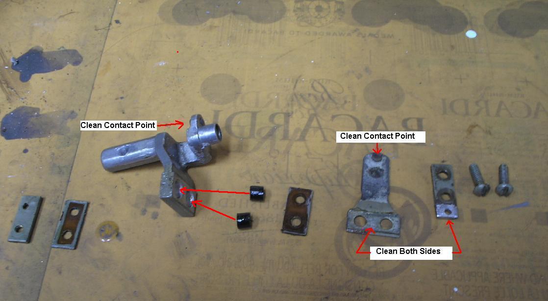

            #64761
              Its pretty common for this magneto
              to loose spark because of corrosion
              in the point assembly. Disassemble
              the points and clean everything and
              recheck for spark. These coils are
              rarely bad. I bet I have had 20 or
              more motors with this magneto
              that wouldn’t spark when I got them
              but it was never the coil. Its always
              good to know if there is an option if
              you do find a bad coil so how about
              a picture Tom?
