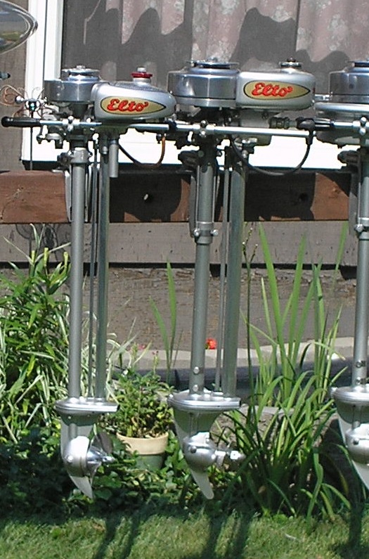

      The magneto on the Cub/Mate is quite a bit
      smaller than the Pal.
      I managed to get one of these in a mate but
      just barely having to file off some of the
      cover. As they don’t make this coil anymore
      either its not much of a solution,

        I was just thinking that I probably didn’t need the spare coil I’m getting, I didn’t realize it was a different size to the Cub. Never seen a Pal and a Cub side by side before, looks like almost everything is different! I thought they’d just tuned or detuned the same engine depending on the model
