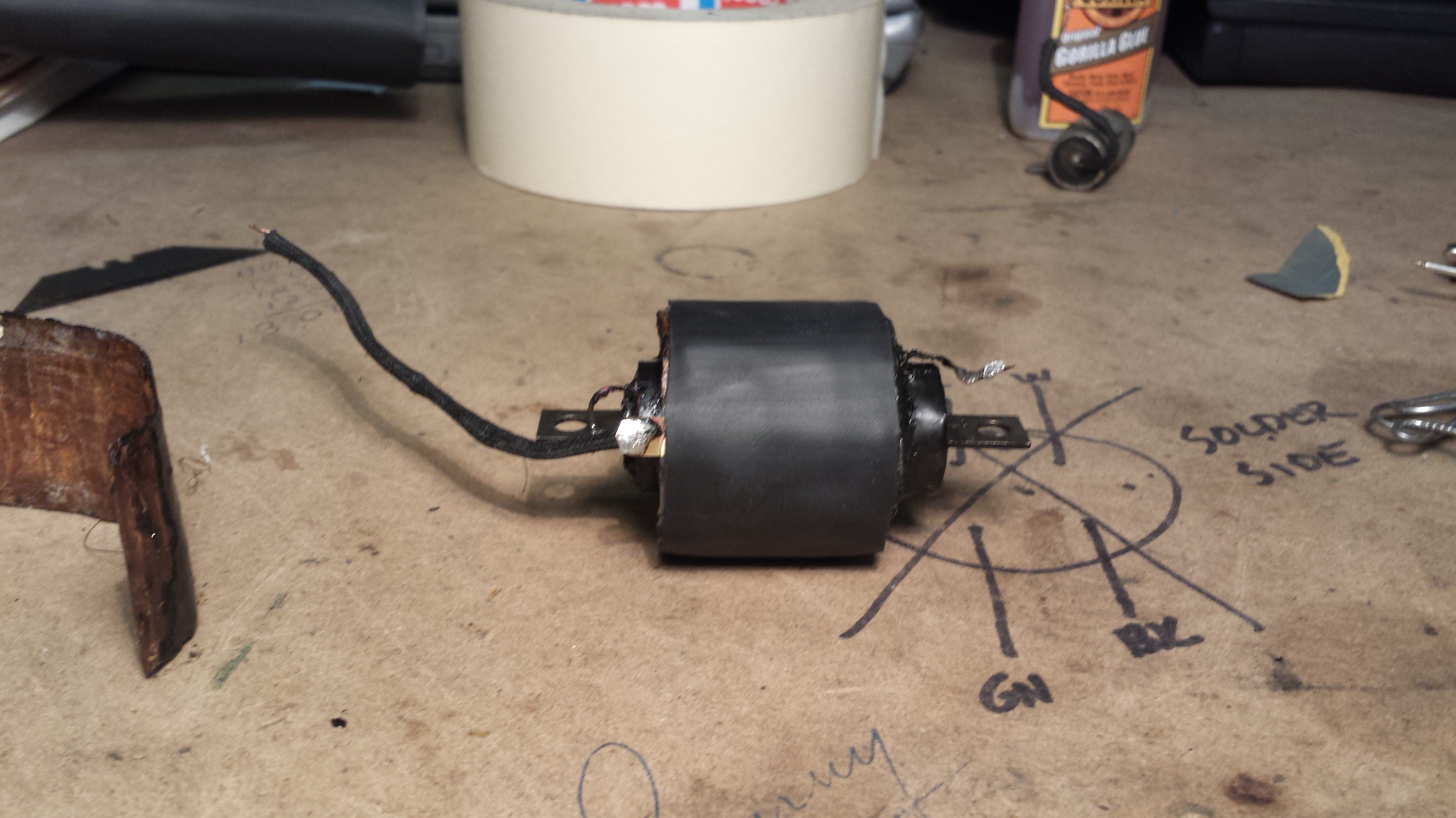

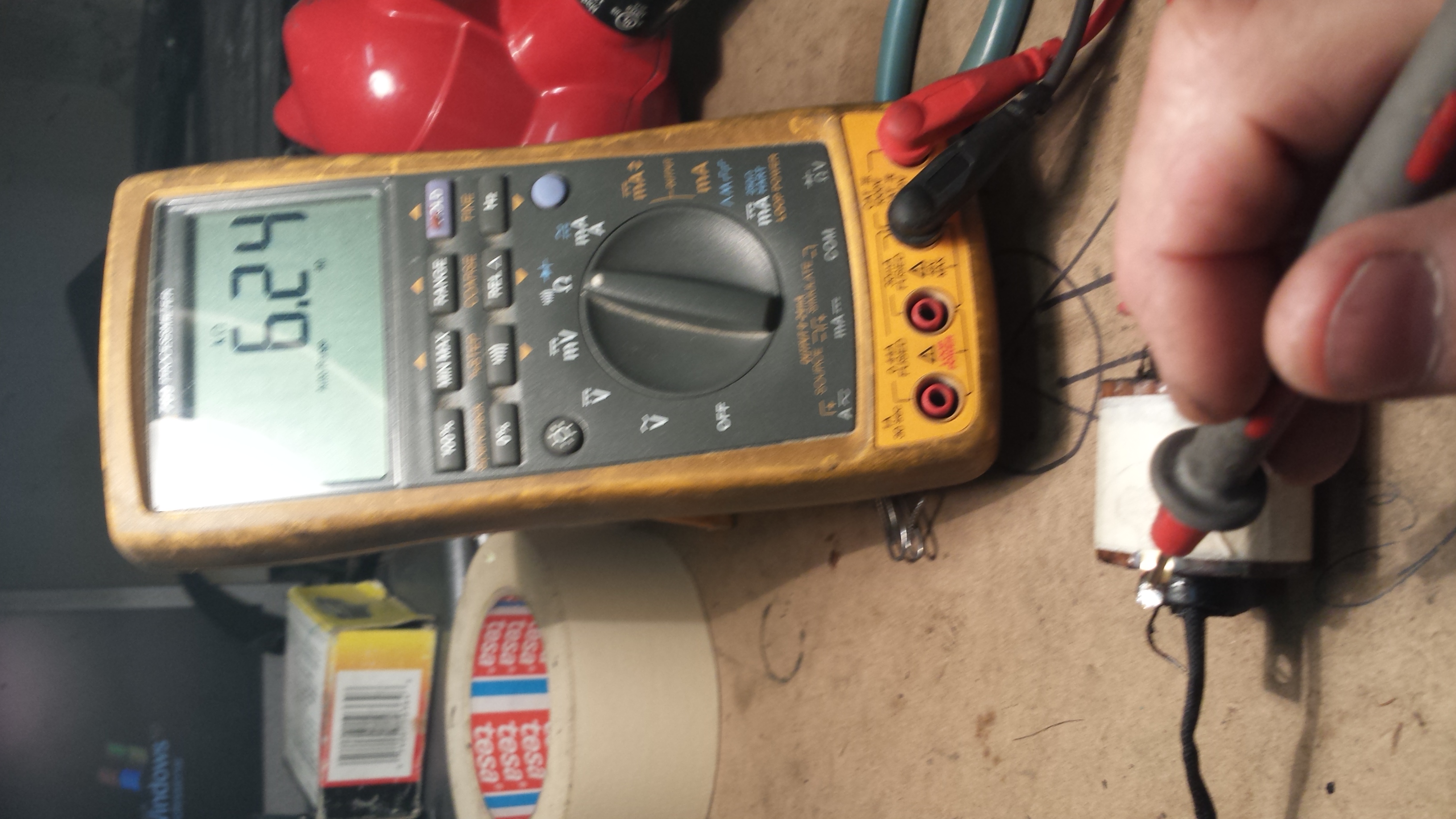

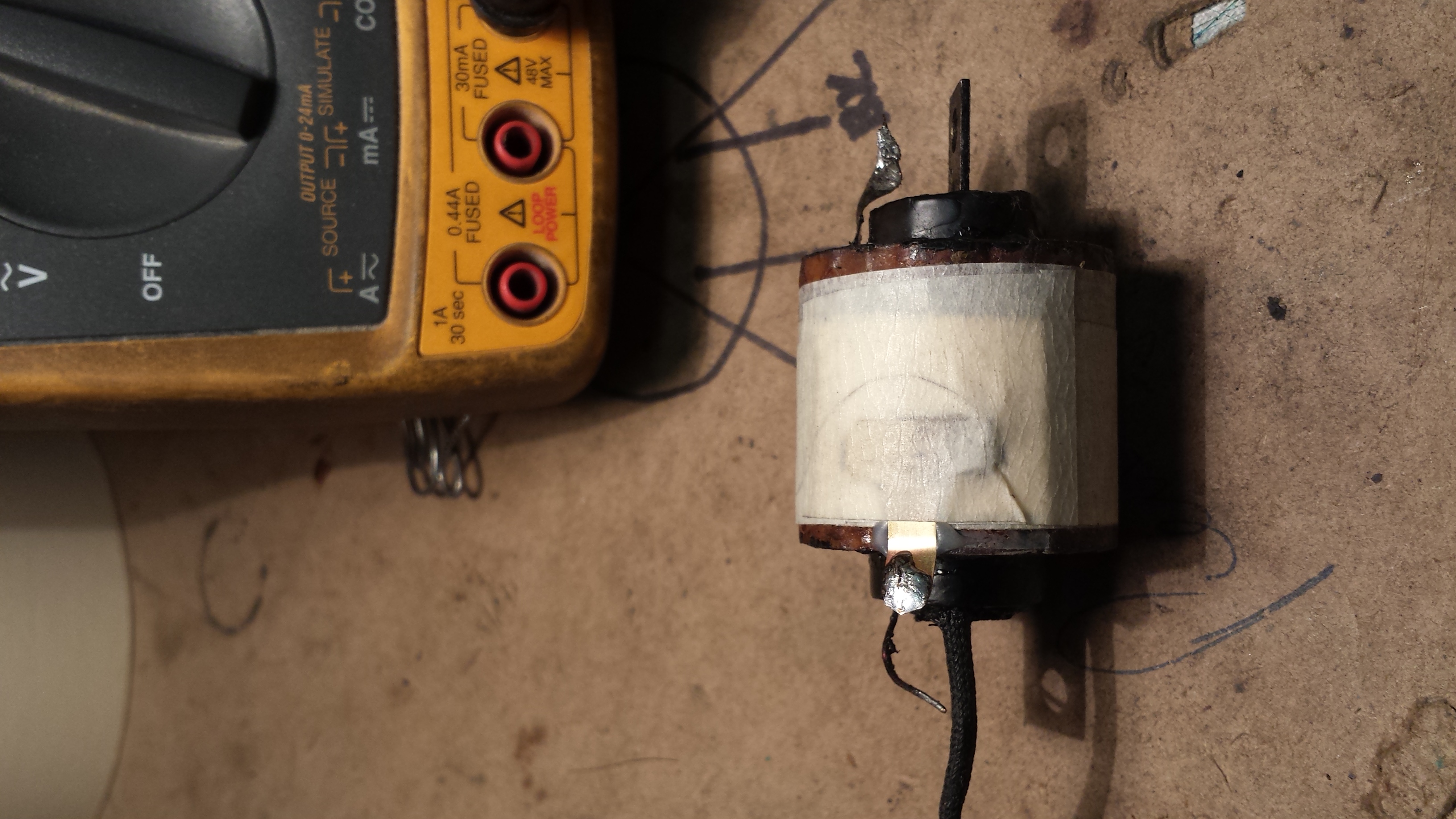

              Well, exploratory coil surgery went ok.
              I was able to find the broken end eventually and now have good secondary resistance.
              I have a new lug made that will anchor better in the coil. The original lugs were way to small and poorly anchored and it didn’t take much to snap the extremely fine secondary wire.
              I’ll post some pictures when I put it all back together.

                Finally was able to put it all back together.
                I made a bigger T shape lug and anchored it well.
                Used dual wall heat shrink as the outside insulation.
                Patience is the key when attempting to do this. The wire is so fine it breaks really easy.
                Will put the mag back together and check for spark.

                    lyks2tinkr
                      Thanks Tubbs. I assembled the mag today and roughly set the points. Got a nice decent spark again.
