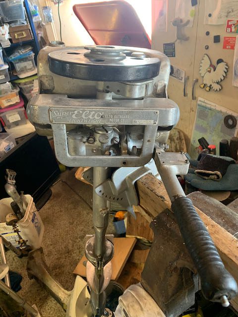

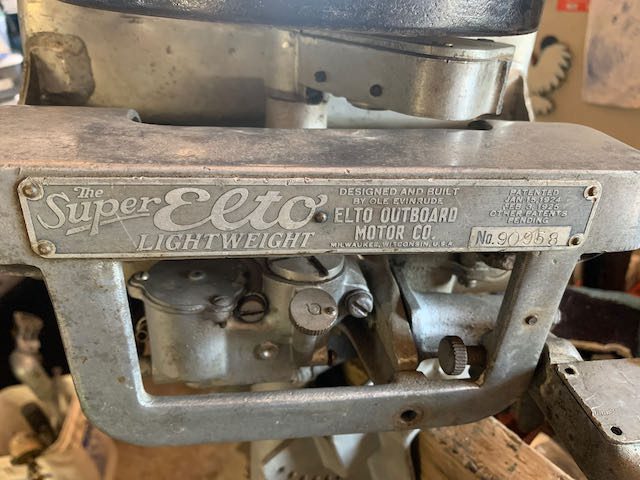

      Got this at the PTBC Chapter auction yesterday.  Anyone know what year and hp it is?IMG_9183

        Whoa!  Top pocket find there for sure!   Is it stuck?  I wanna see that one making smoke.
        dale
        #274715
        Dale
          The old outboard book on page 262 shows an Elto Lightweight 1929  at 3.5 hp.  My best guess, Peter Hunn is THE man.
          dale
          #274716
            David,
            I’ll confirm Dale’s post that you have a 1929
            Folding Lightweight with some serious issues.

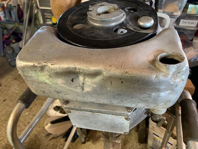

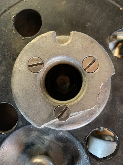

                    Here’s one of the serious issues.
                    IMG_9194
                    IMG_9195
                    I’ve heard there is someone in the club who rebuilds these.
                    -Broken spark advance lever
                    -Broken rope sheave
                    -Banged up tank, missing fuel cap.
                    What others do you see?

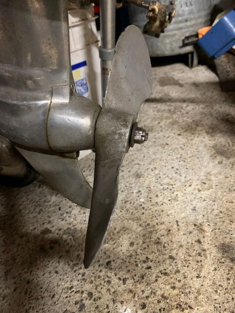

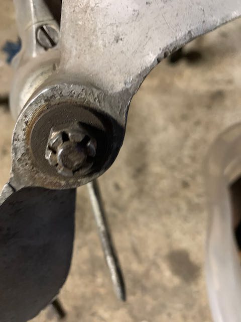

                      Some more photos

                      #274764
                        The coil is no problem.
                        Here are a couple videos on repairing the coil.
                        It would have been if you didn’t have the coil
                        tube. Its a different size than all the other Super
                        Elto’s. Hard to find.
                        https://youtu.be/e2vxDqF_OEU
                        https://youtu.be/xwbTlC1xIlA
