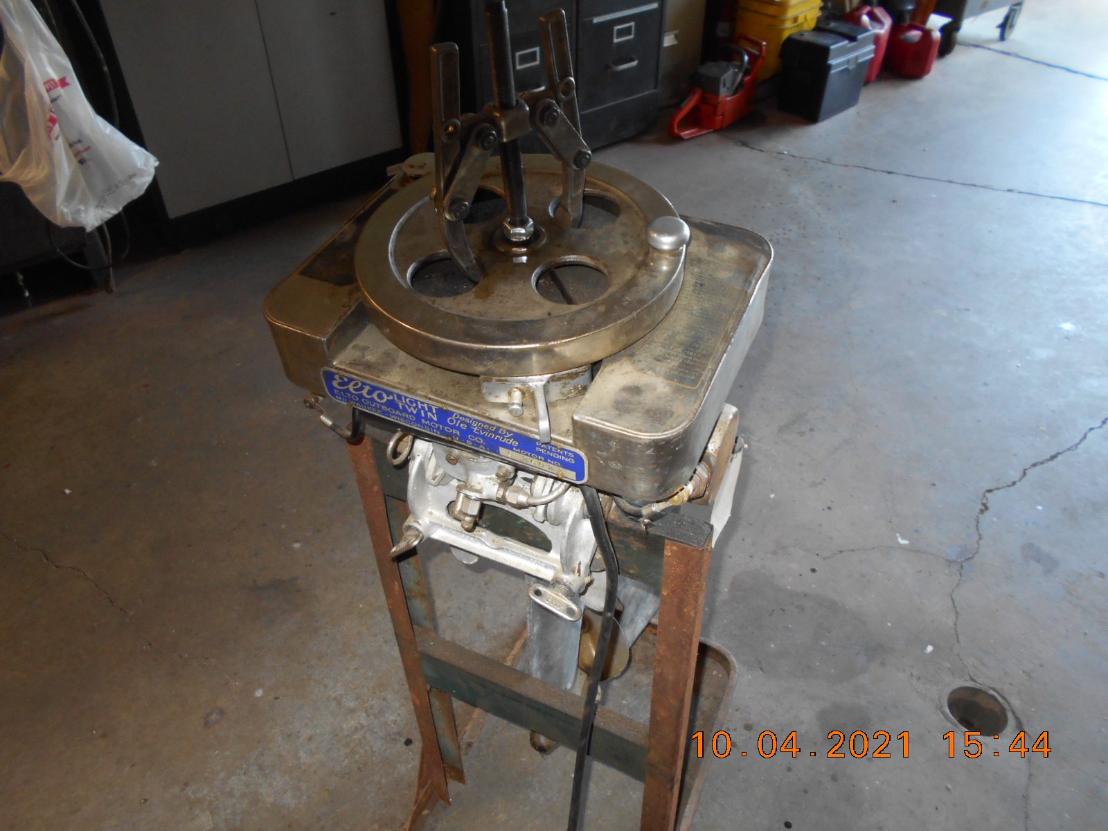

      I decided as long as I had the hotplate set up for boiling coils,
      I’d take the coil out of my other, yet to be worked on, Elto.
      While this Lightwin looks a lot nicer than the first one,
      the flywheel is on a lot tighter.
      I used the puller shown on the first motor, and the flywheel popped
      right off without me being worried about breaking the flywheel.
      This one has me a little worried.
      I tightened the puller up pretty good, lifted the motor off the ground
      by the flywheel, and smacked the flywheel nut, but I did not get
      any results.
      I PB Blastered around the crankshaft, and left tension on the puller
      for the night.
      I was trying to figure out a different way of pulling on the flywheel,
      but there’s no room to get bearing splitter halves under the flywheel.
      The gas tank won’t come off without the flywheel coming off first,
      plus there’s the timer in the way under the flywheel.
      P.S.- I cant get the gas cap off the tank to inspect inside, so
      I hesitate getting a torch near the flywheel…… that might
      not be good for the timer anyway!
      Have any of you devised a safer way to pull these flywheels?
      Thanks.

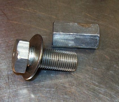

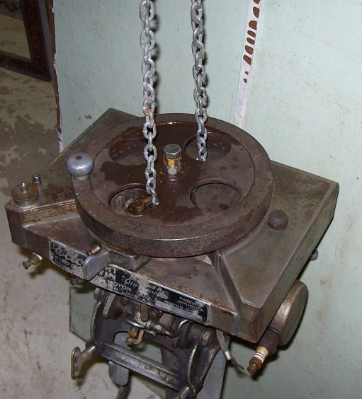

        Don’t use a puller like that on outboard flywheels.
        Use a Knocker on Eltos. Don’t hit the flywheel nut. It wrecks crank threads. Use a Knocker. Tighten the knocker bolt against the end of the crank after every hit if it loosens. Lube the taper, let it sit a couple days, lube daily, tap the knocker daily. Don’t hit too hard. Knocker parts available from Ace Hardware. :One threaded coupling 1/2-20 and a 1/2-20 bolt that length.

              I’ve actually used a homemade “popper” in the past, but can’t remember on what.
              Thanks for the reminder. Using them seems a little brutal on ancient iron,
              but I guess better than breaking the flywheel !

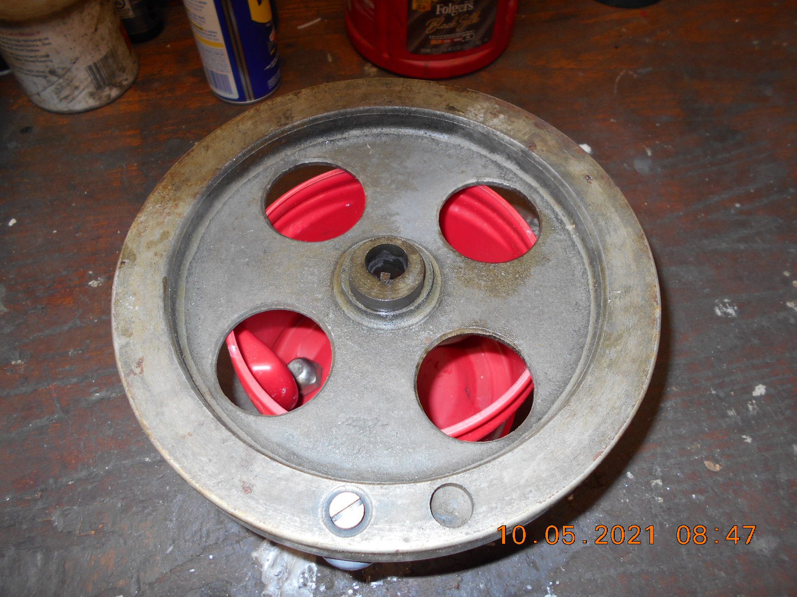

                #247770
                  The flywheel sat over night with the puller tensioned, and PB Blaster
                  soaking in. Happy to say that it popped off on the second blow
                  with the hammer as I was lifting the motor via the flywheel.
                  If I’m smart, I should make a knocker anyway for next time.
