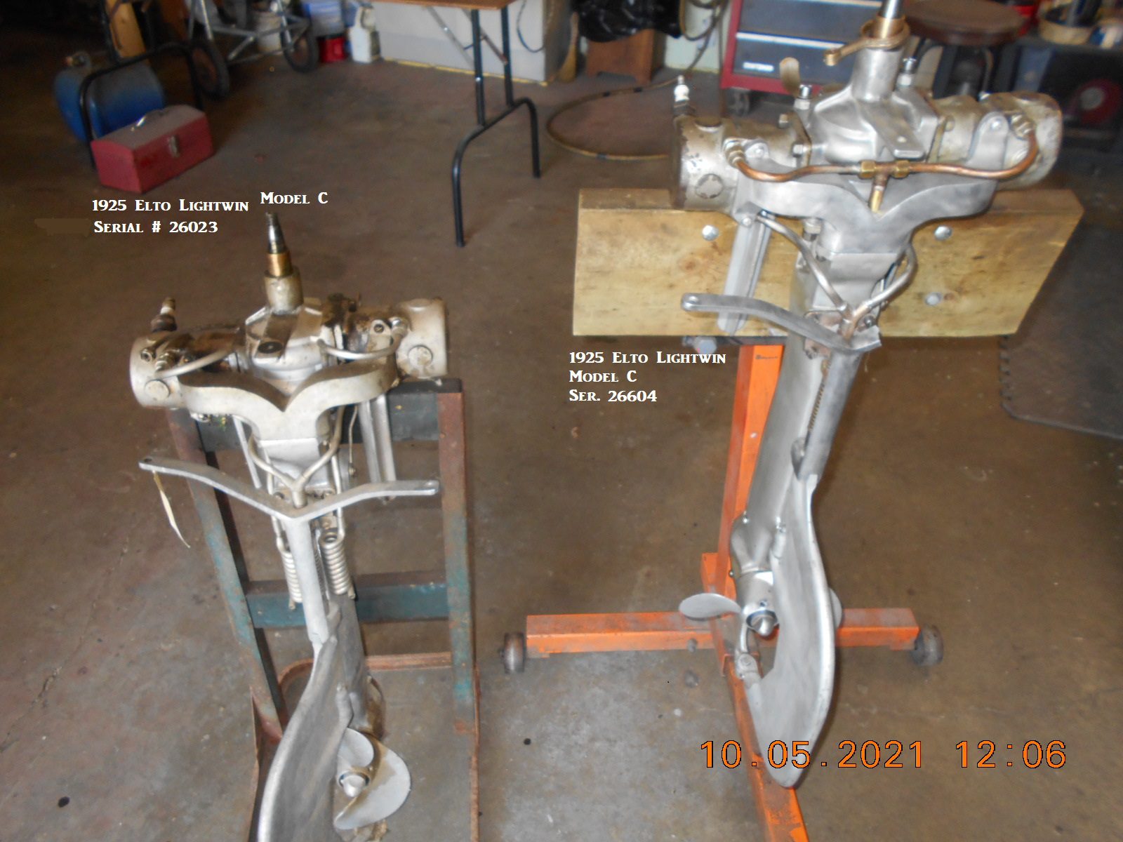

      I have both of these as 1925 models.
      Note that the slightly older one on the left
      has the water outlets go into curly pig tales,
      and water exiting to atmosphere.
      The slightly newer model has the water outlet
      going thru the exhaust manifold and into the
      exhaust stream.
      The first one where you can “see” the flow sounds like
      a better idea.
      Was this a mid year change in design or was the later
      model modified by someone?
      DSCN1885
      #247818

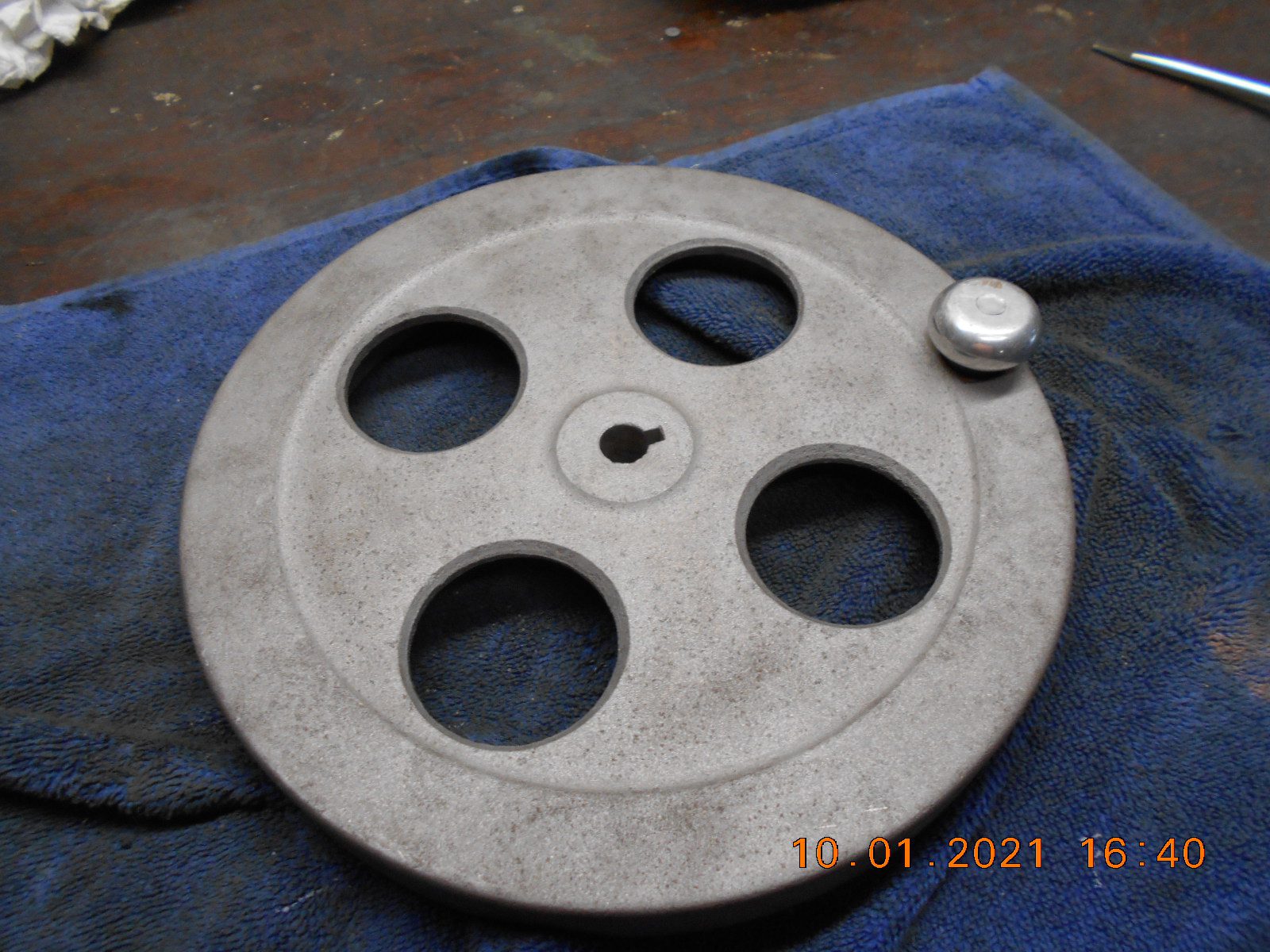

        Does the later one have the same flywheel
        with the large holes?
        #247826
          I would say both flywheels are the same.
          The older, nicer flywheel
          DSCN1872
          The newer, rusty, but sand blasted flywheel.
          DSCN1834-1
          #247836
          TOM GOEPFRICH
            I believe some one has altered the one going into exhaust manifold.
            #247838
            Tom
              The system, as modified with the water going to a common exit, probably won’t work. The reason for the pigtails is to slow the water rate going out, and to assure that BOTH cylinders are cooling. With the system as modified, it’s unlikely that both cylinders will cool at the same rate. I would not run this without constant temperature monitoring of both cylinders.
              T
              #247841
                Interesting. You got to wonder why someone modified it in the first place.
                #247844
                  My guess is they can break off from the vibration.
                  This is how the motor came to me. I don’t know
                  how well this worked or if it was ever run this
                  way. I have since replaced it.
                  #247845
                    Looks like your motor may have proved your point!
