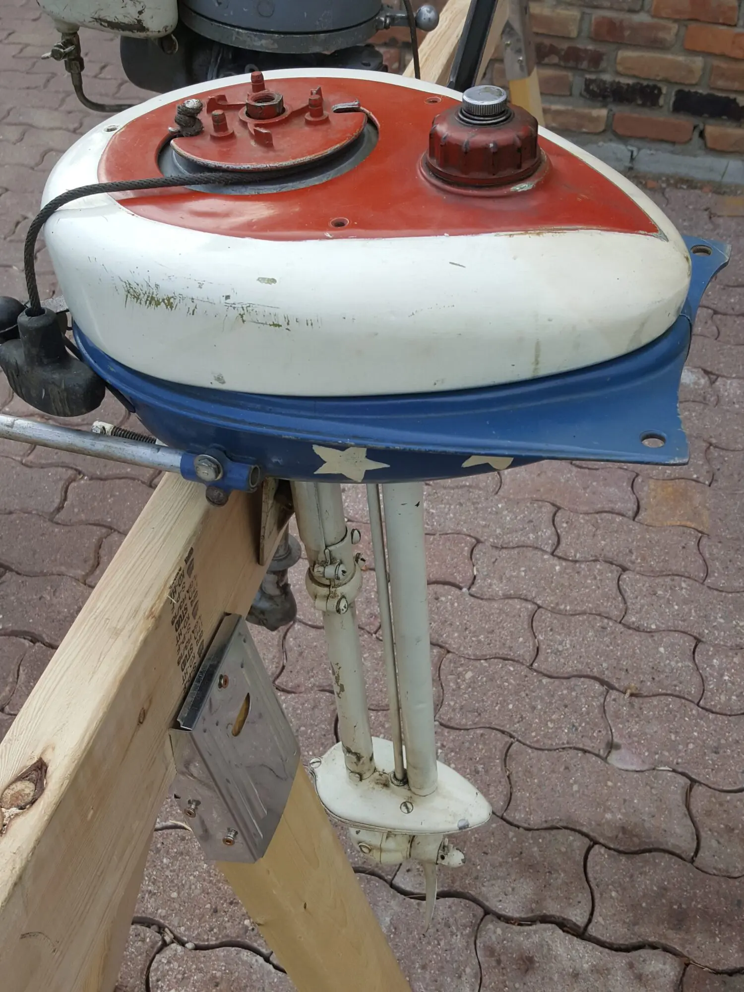

Got my 1938 Pal running quite well, after the addition of a ceramic condenser rebuild.
The good: Runs great, high and low speed. 75 lbs of compression.
The bad: It doesn’t pump very good water. It spits once and awhile but not consistent like my Rangers.
I think there should be a grommet in between the water tube and lower unit, but it is hard to tell.
Any advice would be great, thank you!
1949 Mercury KE-4
1952 Mercury KF-3,-5,-7
1952 Mercury KG-7Q1937 Evinrude Scout
1938 Elto Pal

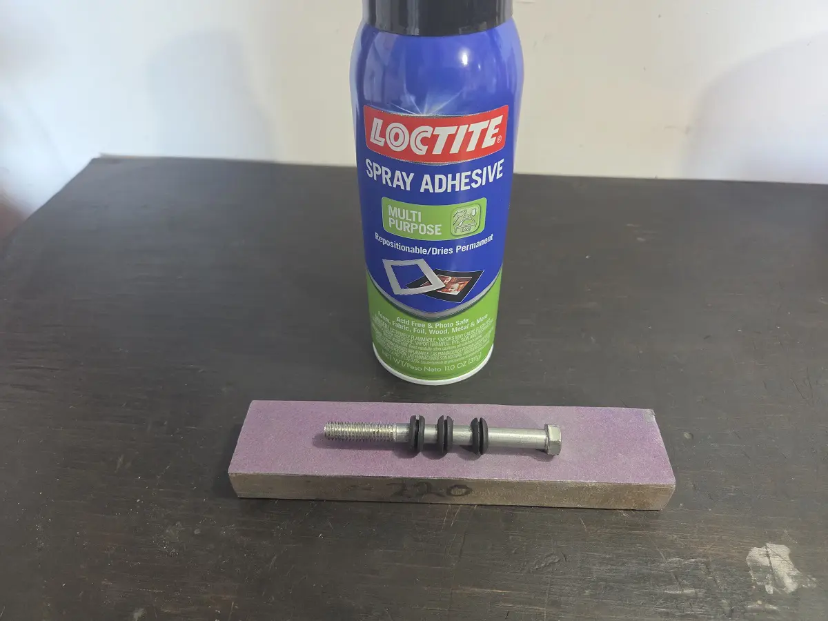

Go to the home center or hardware store and pick out a long 5/16 bolt. Find the grommet that fits tight on the bolt. Get several in case you don’t get it right the first time. You don’t have to but it makes it somewhat easier if you cut of the head of the bolt to spin the grommet in your drill. (special tool) I used contact cement to glue some 220 and 320 sand paper on either side of a piece of wood. Heat gun will soften cement when you need to change the paper. Usually, with heat, you can change the paper several times without adding more cement.

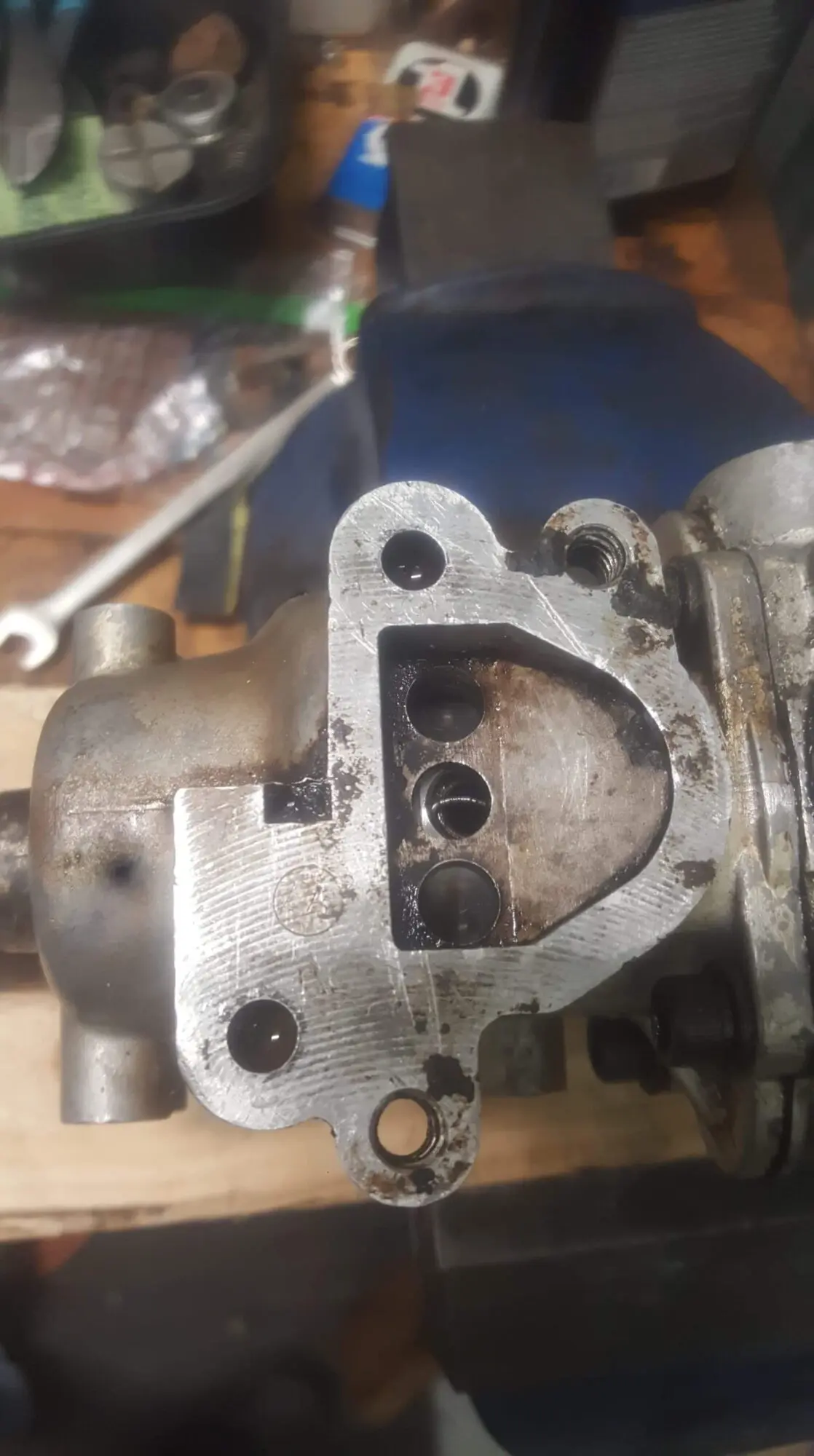

April 16, 2026 at 10:16 pm #315652These motors have a metal pump impeller which is good because it doesn’t usually wear out.
They also have some somewhat constricted water passages in the cylinder, so if you haven’t already done so, make sure that compressed air can flow freely through the cylinder. Blow air in both directions to make sure any rust or mud flakes get broken loose and blown out. In some cases, the cylinder needs to be soaked in hot water for a couple of hours too soften/loosen up silt or other deposits that have dried up and hardened in place. some of these motors have aluminum cylinders, and in those cases the cooling passage is made up of a copper tube that is wrapped around the cylinder liner then aluminum is cast over everything.
I once had a Ranger that wouldn’t move enough water to cool at all well. The cause was an obstruction in the water passage that took me about two hours to clear out by pushing a length of heavy wire into one water port and lubing it with WD-40 while heating the exterior of the casting with a propane torch. Eventually I got the rust/mud ball that was in there to break down to the point that compressed air could finally blow it out.

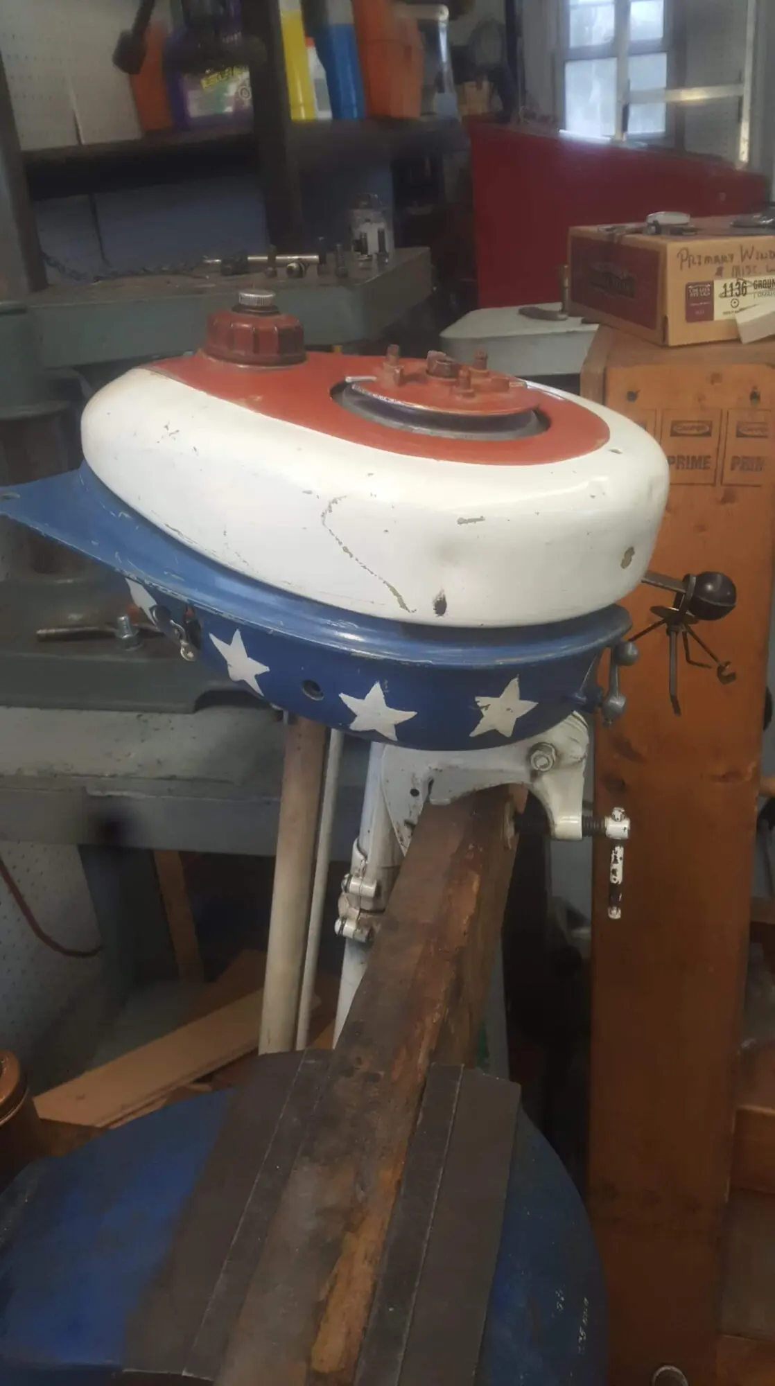

Good ole “Ranger Dave”. He got that name because as received he was painted up in the colours worn by Super Dave Osborne (Or Evel Knievel, whichever you prefer). He was a bit of a joke of a motor, but I did get on the lake with him once.
