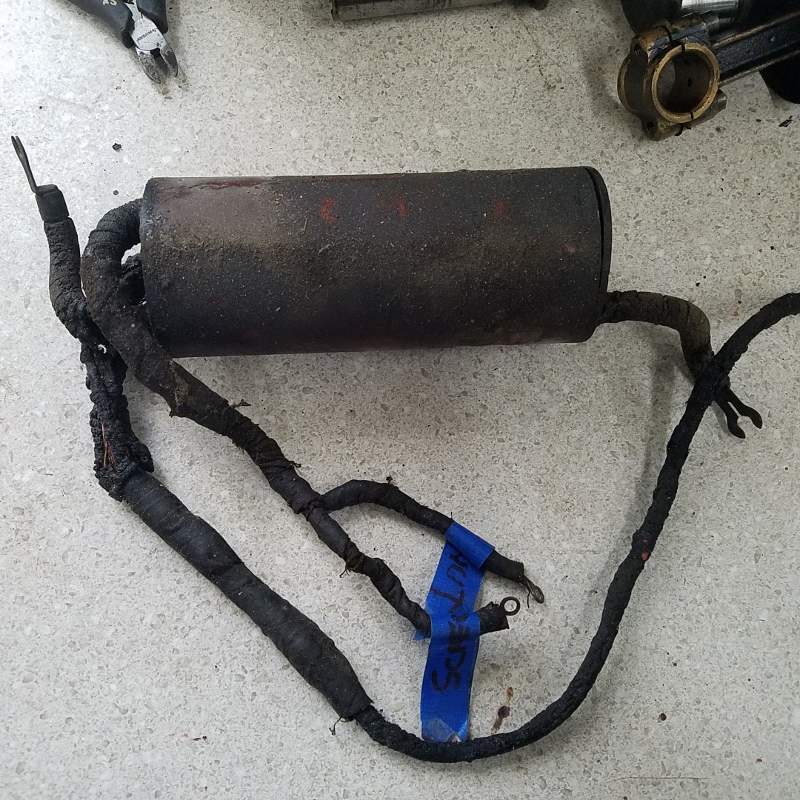

Yes they can be rebuilt. Lots of threads on that here on the forum. Check the coil, if it fails, you can use a zephyr coil.
Most of the work is cleaning out the old material!
Lots of experts on this forum on this
August 9, 2017 at 9:44 am #62707Yes they can be repaired as stated above.
It has been my experience that the common failure mode with them is the internal condenser (capacitor) goes bad.
If the coil secondary is still good then the capacitor and wiring can be repaired and the coil will throw hot spark again.August 9, 2017 at 1:00 pm #62715Here is one option for the coil.

August 9, 2017 at 1:51 pm #62718I followed Tub’s advice and rebuilt a Ruddertwin coil with a Zephyr coil. It seemed to work well. The entire time I was doing it I couldn’t help wondering if there was a more modern coil that would be suitable. I haven’t looked into it, but it sure would be nice to pick up a brand new coil instead of using 70 year old replacements.

August 10, 2017 at 4:05 pm #62789In regard to replacing points: go to Atwater-Kent ignition parts an you will find the points for Ruddertwin, Speedster and ’28-30 Quad under the brand name of 2 dozen teens thru 20’s Auto’s using the same AK ign parts. At present there is a set for $20.00, look at the picture. Jim Ross
