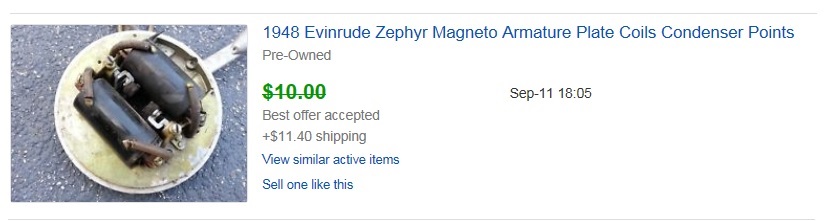

      #67435
        Zephyr coils are VERY available. You can place a want ad and see what pops up. I am sure you will find one….And yes it works very well…

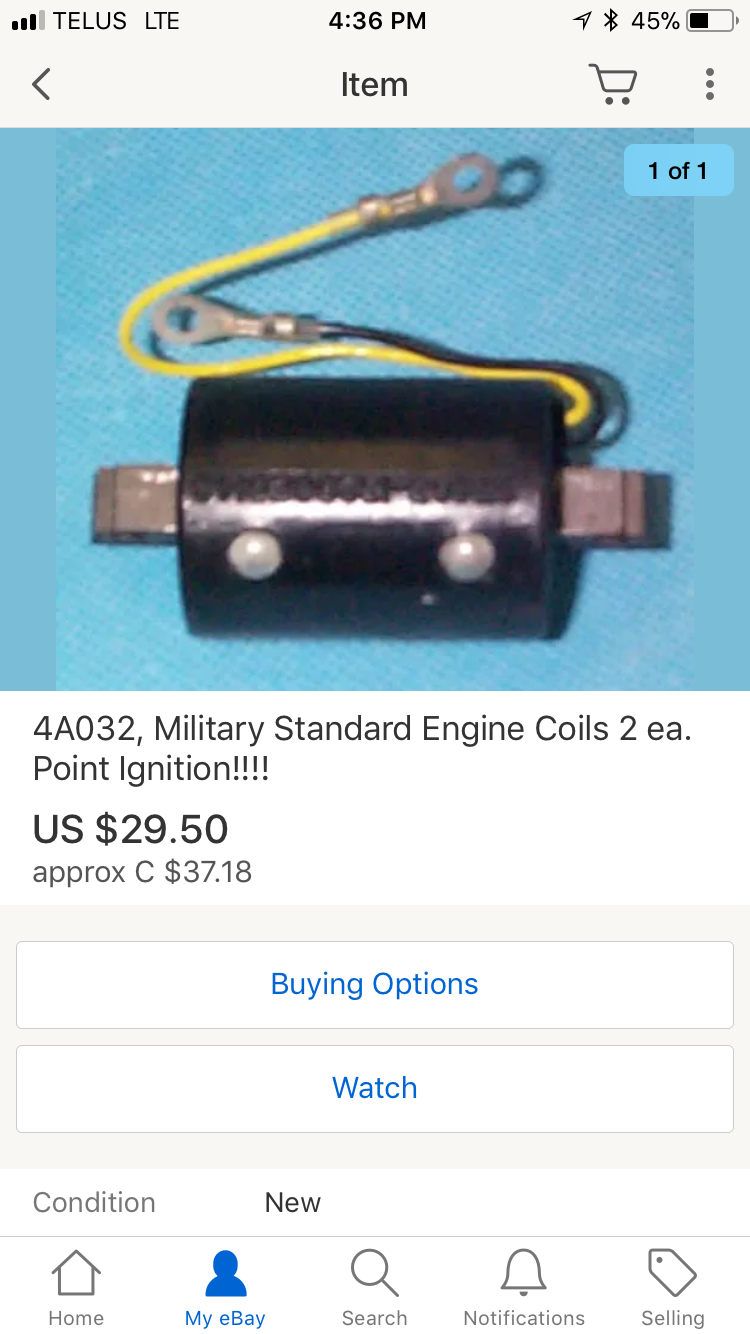

          I bought four of these coils. They were cheap enough. I have not tried them, yet.
          Wayne

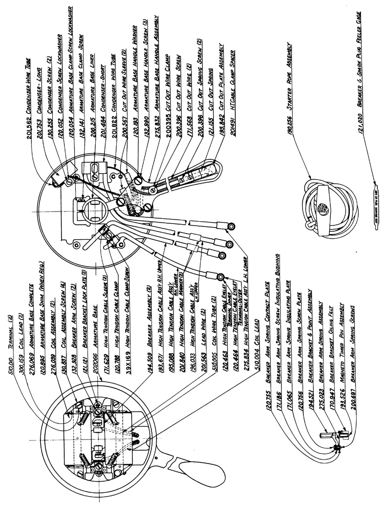

              Lightfours use the same coils – 276039 . . . 😀
              Lightfour
              Zephyr
              #67493
                They show up on eBay from time to time also.
