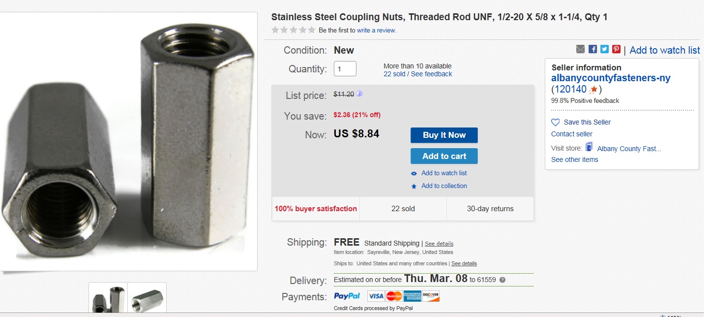

        https://www.youtube.com/watch?v=RWgE9XiIBnk&t=2s
        If you don’t weld Home Depot, Lowes, or a good hard
        ware store will have some of these.
        Sent you a PM
        #71751
        George Emmanuel
          Needs a fine thread though….
          George
          #71770
            quote George Emmanuel:
            George
            The Local places may not have the fine thread coupling nuts.
            Company’s like Granger will but probably the cheapest place
            you’ll find the fine thread nuts is on eBay,
            #71992
            Doug Wilson
              Tubs thanks for the suggestion soaked it with kroil and used your suggestion fly wheel came right off. Now have tank and ignition lose. Crank now will move a fraction of an inch will let it keep soaking.
