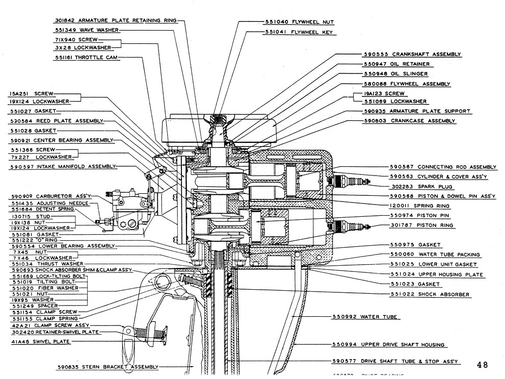

        2fast4me
          Any one know what the P/N of the flywheel is???
          Any one know if there is an alternate flywheel for an ELTO Speedster flywheel maybe a Johnson or Gale.

            Flywheel assembly 0580088 common on Gale built 12 horse outboards. . . 🙂
            #47797

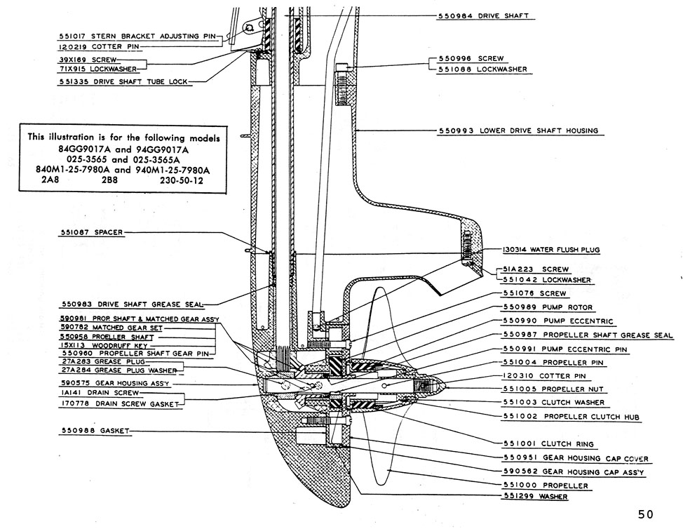

            2fast4me
              Garry, thanks for the print, I think it answered some questions that I haven’t even thought of asking yet. Looks like eccentric water pump and a plain bearing motor. I thought you would come through with the necessary info. Thanks again.
