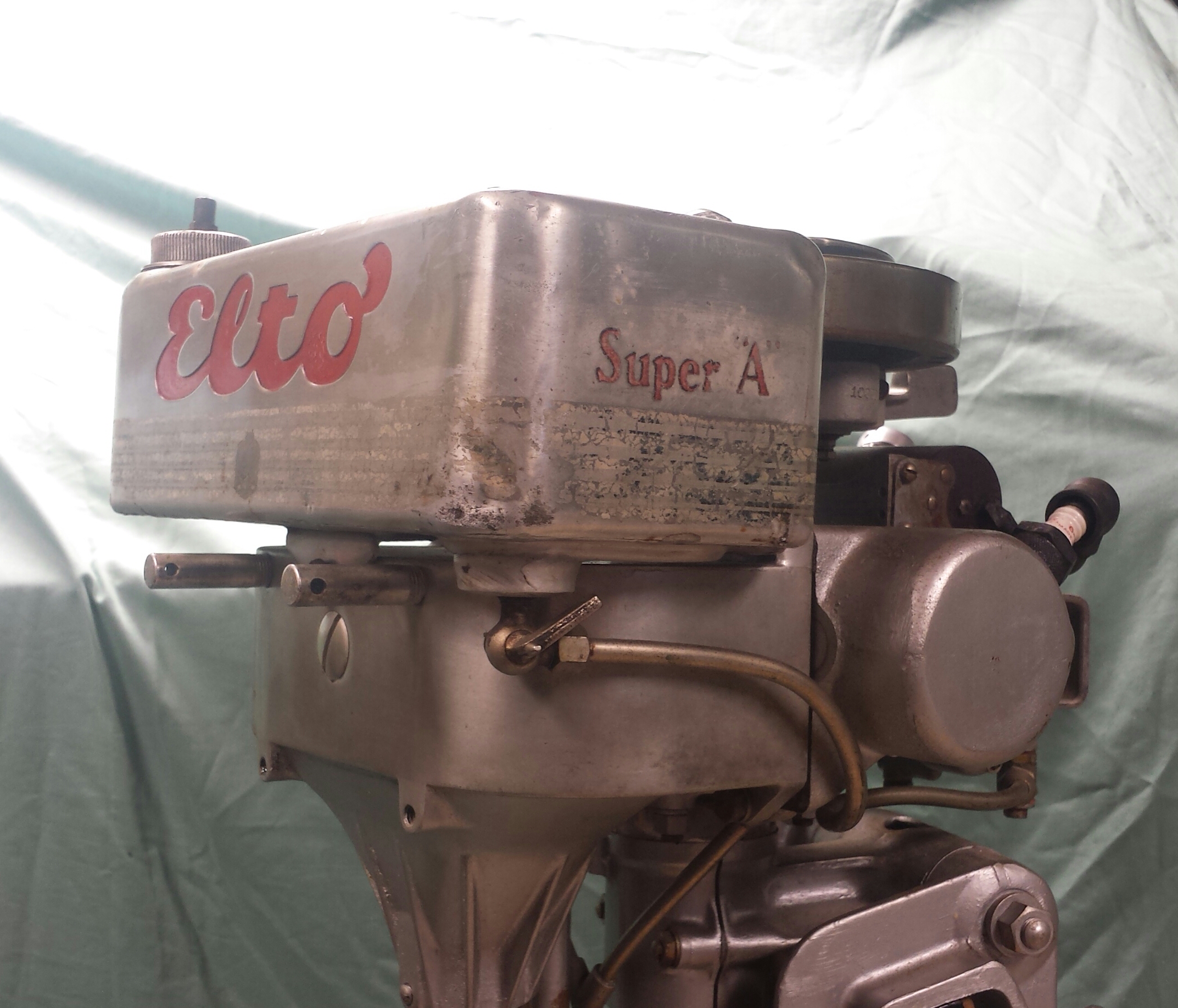

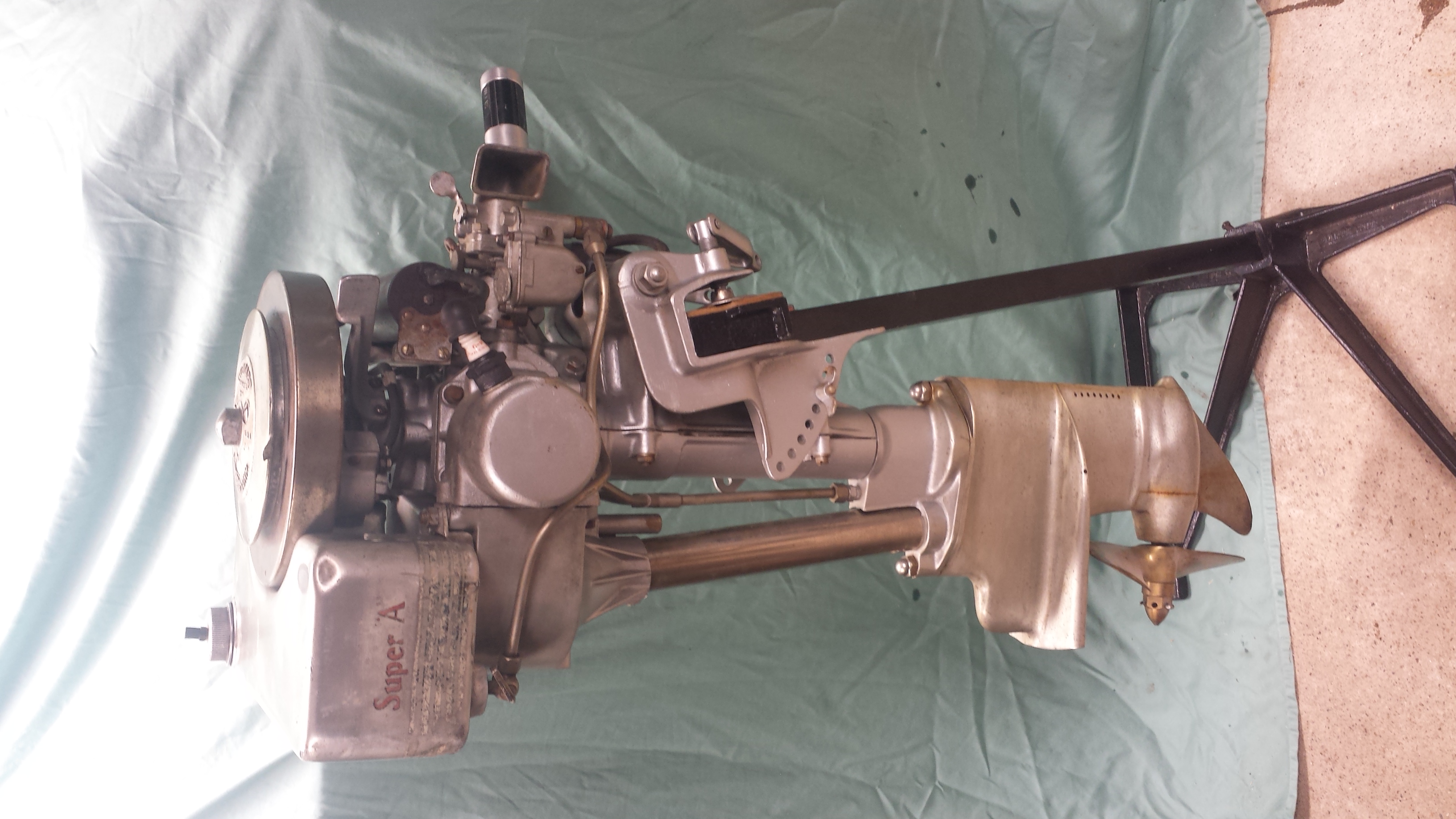

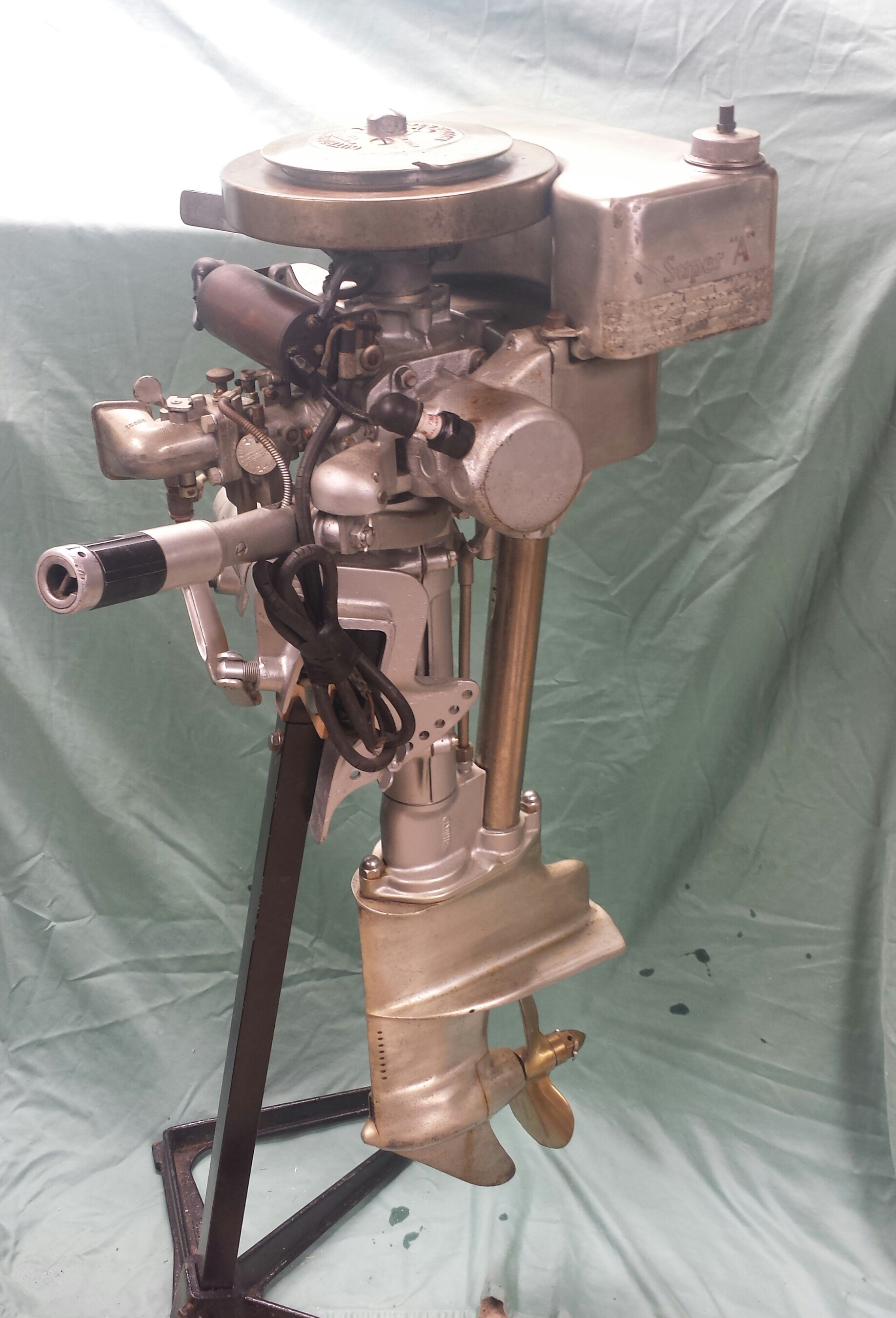

                #78789
                bill-loveland
                  I picked one up on Thursday at a club member’s auction. Been after it since he first got it twenty-five years ago 🙂

                      #78820
                      melugin
                        I’ve also found silver paint over the plating. Plating was to prevent corrosion, rather than cosmetic.
