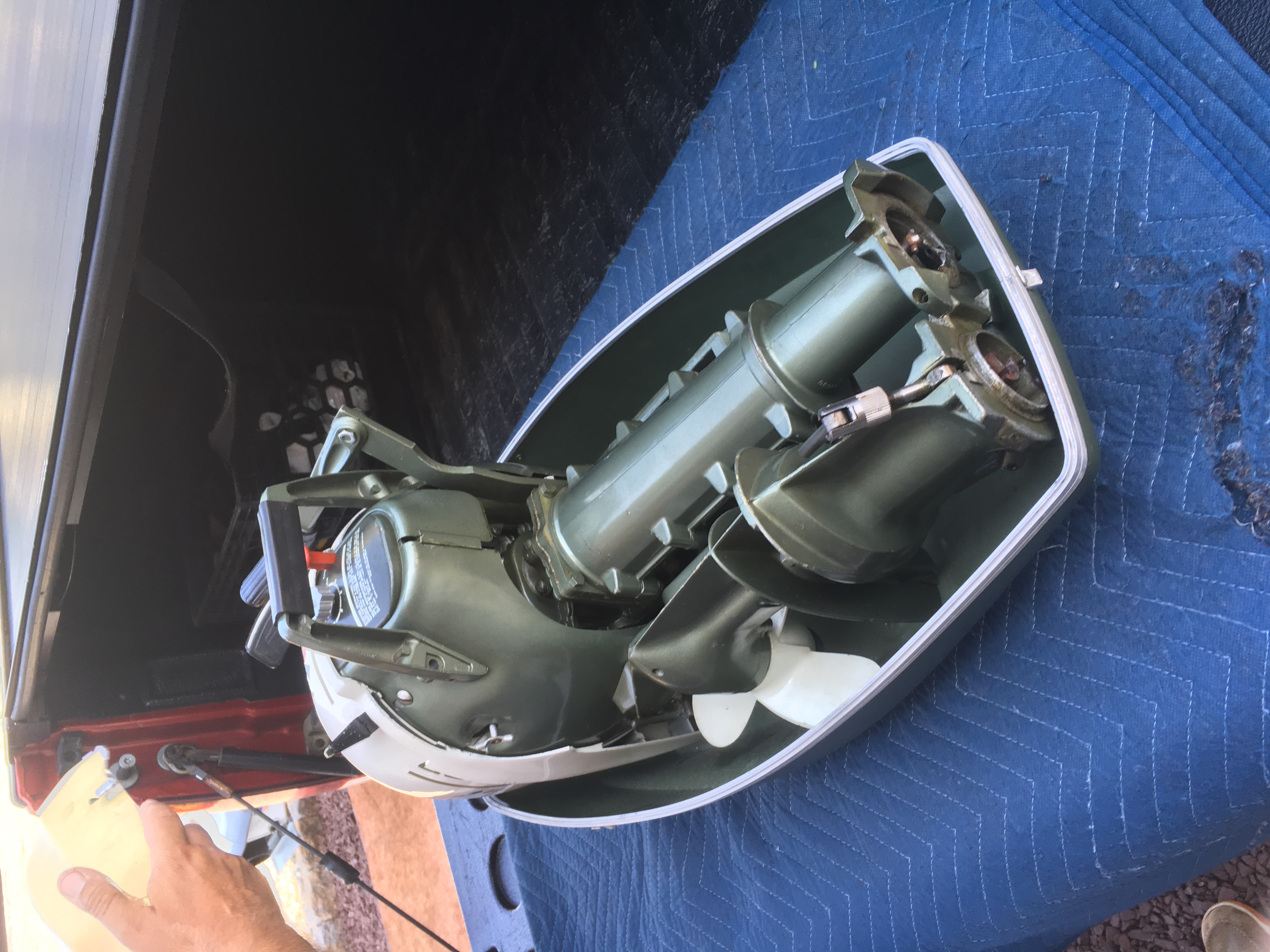

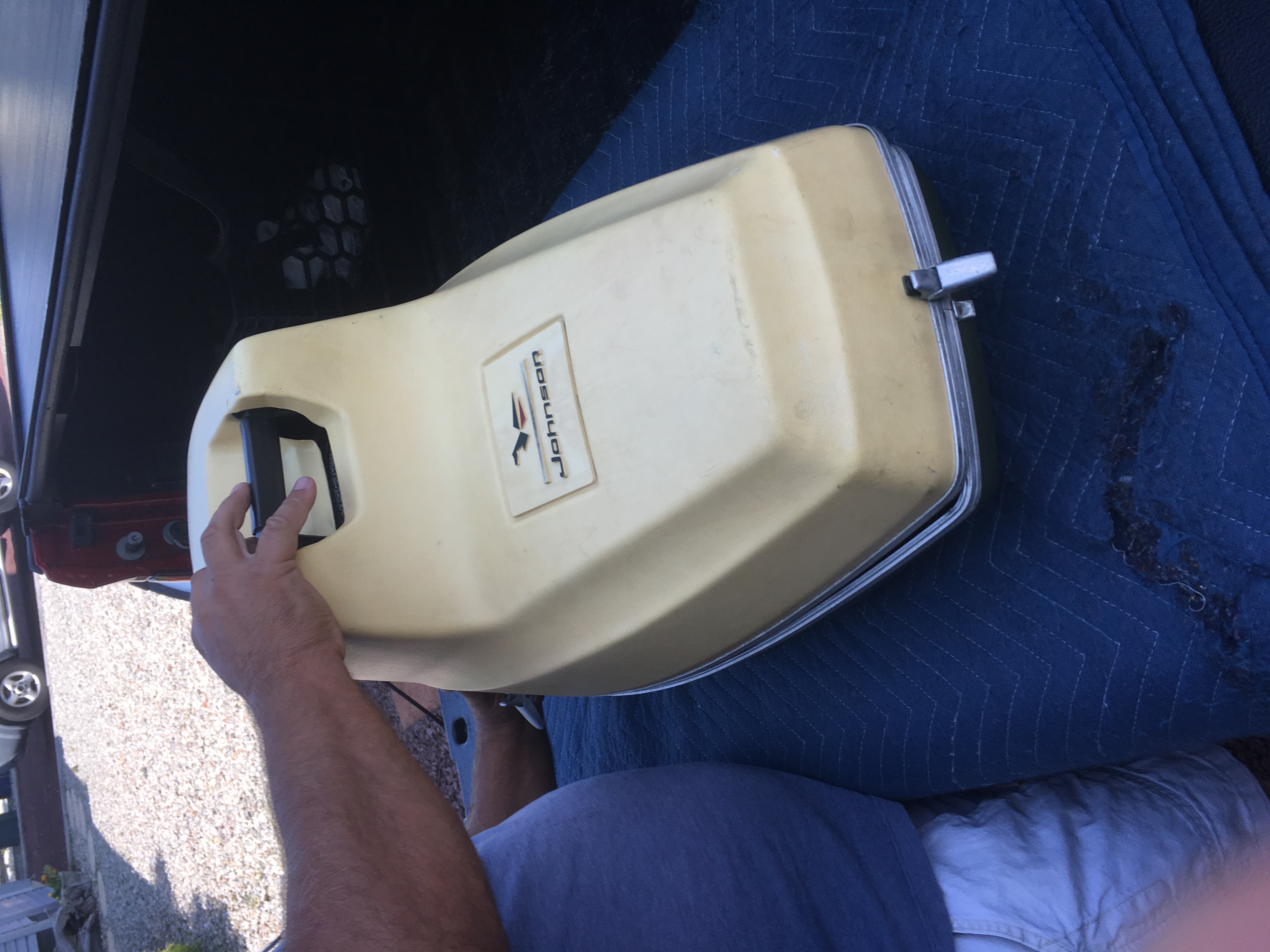

      Hello all. This weekend I was fortunate to acquire a lightly used, very well maintained 1967 Johnson JHF 22C 3HP with case, as well as a second identical parts motor.
      It purrs, and I’d like to keep it that way, but would also like to use the friendliest oil I can get. I am definitely NOT an expert, but I have done some research. It looks like I should be using an oil that is both "readily biodegradable" and "tc-w3".

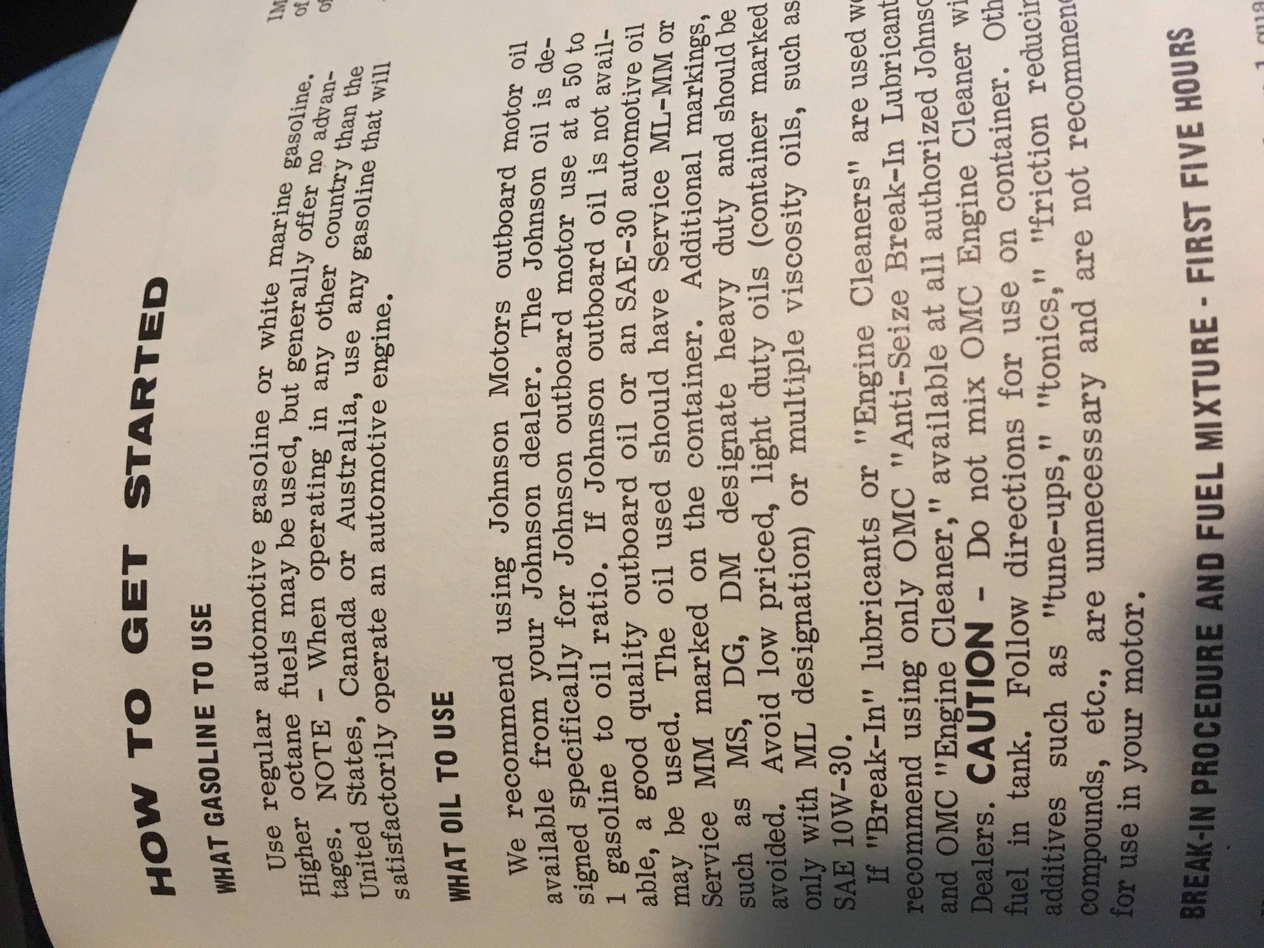

              First, thanks for the reply. I wonder about the ratio you mentioned. The motor also came with a pristine original manual that clearly says 50:1.
              quote Chris_P:
              She looks like a real beauty!
              Please don’t let Bob the Builder down the street convince you to run that at a 50:1 ,mix! 24:1 would be my minimum. I run mine at 16:1 as I share the gas can with other small hp motors requiring 16:1
              #64723
              kerry
                Yes, the manual clearly says 50:1. What it doesn’t say is the powerhead is relatively unchanged from the 1952 version. Trust the members that are trying to keep the motors alive, not the bean counters. Its always easier to add extra oil than rebuilding the powerhead… if it doesn’t melt or blow up.
