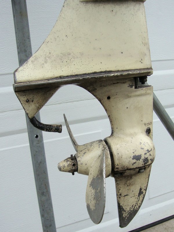

      I’m sure you have heard this story, ‘if you want this motor, you have to take the Eska too’. Anyway, it followed me home, it’s an Eska Arrow with a Tecumseh powerhead. It has a cooled leg that uses pressure from the prop instead of an impeller, which I kind of like. It has spark and compression so I put a bit of gas in and it seems to want to start. It runs for a bit with the choke on but quickly stalls when I try to take the choke off. I’m guessing the carb needs to be cleaned, it has a diaphram instead of float bowl. Any info out there on how this compares to a standard float bowl? Any thoughts on crank seals causing an issue with these motors?

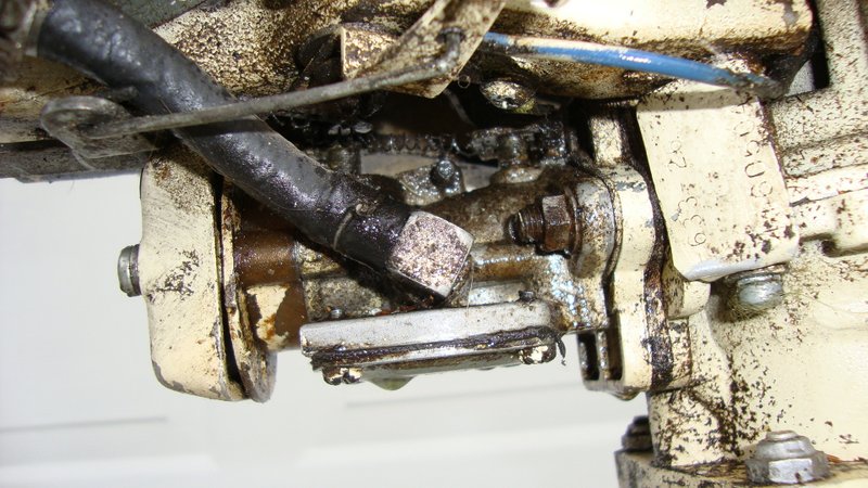

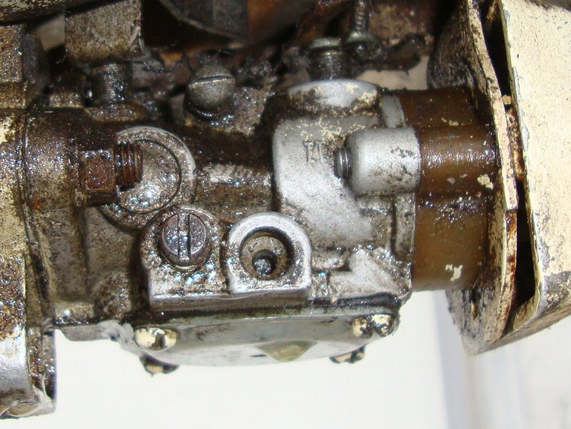

            Ron Devries
              Here are some pictures of the carb.

                #57173
                  2nd picture–is the high speed needle busted off in there?
                  #57176
                  Ron Devries
                    I was thinking a fixed high speed, hopefully not busted off.
