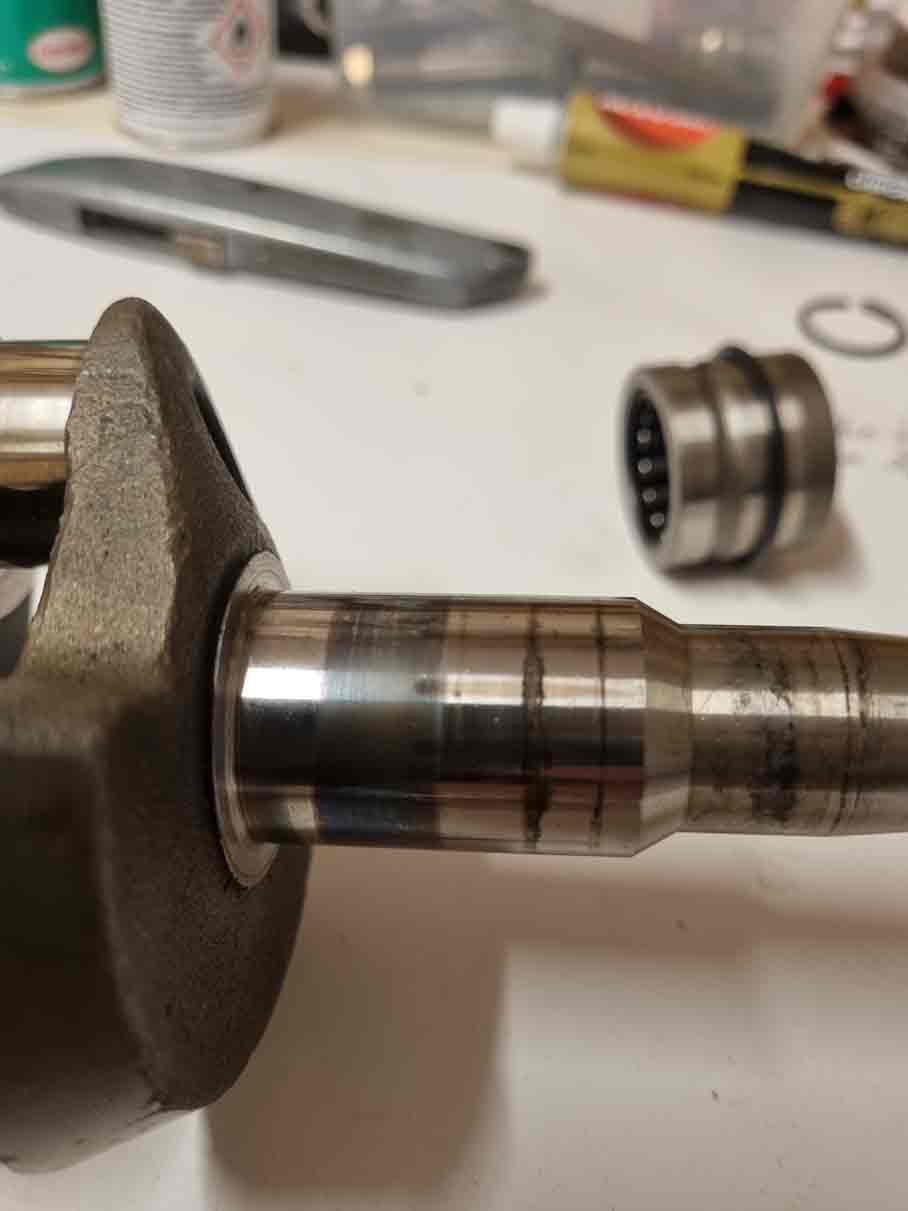

            Thank you for helping me, fleetwin. Sideways slop on the upper end? Not likely, I doubt it. I did a total overhaul myself. The Power head was completely dismantled in 2022/23. Crankshaft, rods and pistons went out. New pistons and rings, new seals (upper and lower in crankshaft), all gaskets are new. There is no O-ring mounted on the upper crankshaft bearing . All passages are open, guaranteed. I cannot see that the intake gaskets are wrong either.
            My concern is rather the condition of the upper end of the crankshaft. It had a blueish color and was a little pitted.

            Do you think fuel/oil it’s likely to pass between the new upper seal and the crankshaft? If so, do I have to dismantle everything again and buy a proper crankshaft in good condition? Or is there some quick fix?

              Here’s a picture showing the crankshaft upper end before assembling.
              20220925_155313

                Yes, I see there’s an o-ring on the outside of the upper bearing lying on the bench. But after some talk about this here on aomci I removed it before assembling the crankcase. There’s a topic on this matter:
                https://www.aomci.org/forums/topic/seal-upper-crankshaft-bearing-evinrude-18-hp-1960/
                I’m more worried about the pitted area on the crankshaft.

                    Would it be possible to replace the needle bearing with a bronze bushing?
                    The pits in the crankshaft might be less damaging.
                    Of course, after all the time and money you put into it, a better crankshaft
                    might be best.
