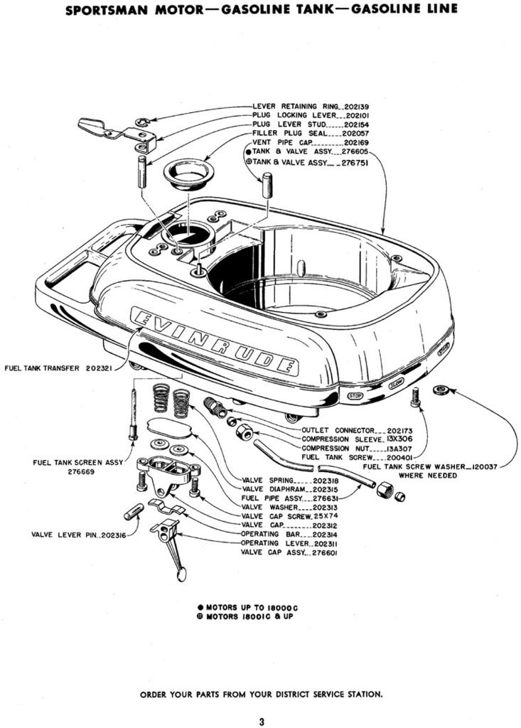

                Mumbles:
                You post a diagram of the lower unit, would you have one for the power head and fuel tank

                    #28878
                      quote fishingnuts:
                      Mumbles:
                      You bet.
                      https://www.youtube.com/watch?v=VSjBwb9esxM
                      #28904
                      fishingnuts
                        Thanks for the prints. Came up with another problem, Fuel valve diaphragm needs to be replaced. Trying to come up with a material to make one out of. Any ideas out there????
