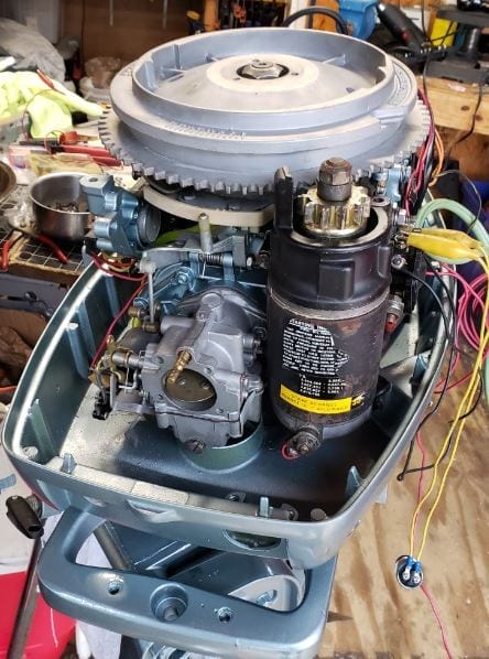

      I completely rebuilt a 1983 Evinrude 35 hp motor and runs great.
      The only puzzling issue I have is fuel starvation at WOT between 4500-4800 RPM and the engine starts surging.
      The surging can be eliminated by squeezing the fuel line bulb.
      I have thoroughly went through all other possibilities of the cause, timing etc.
      After some research I noticed that there are two types of fuel pumps for this motor, one vacuum and two vacuum connections.
      Does anyone know if Evinrude made this change due to fuel starvation issues with this motor?

              This motor was completely disassembled, stripped, block rebored to 20-thousands over, new pistons and rings (150 PSI both pistons) , new bearings, water pump replaced, new thermostat, new powerpacks and CDI, resurfaced head, primed and painted. I mounted it on a 1980 14.5-foot Alumacraft with a jackplate and actually use it for bass fishing here in Florida. I used an OMC repair manual and followed the step-by-step instructions to rebuild the motor. My only disappointment is the surging issue at WOT and I am determined to resolve it.
