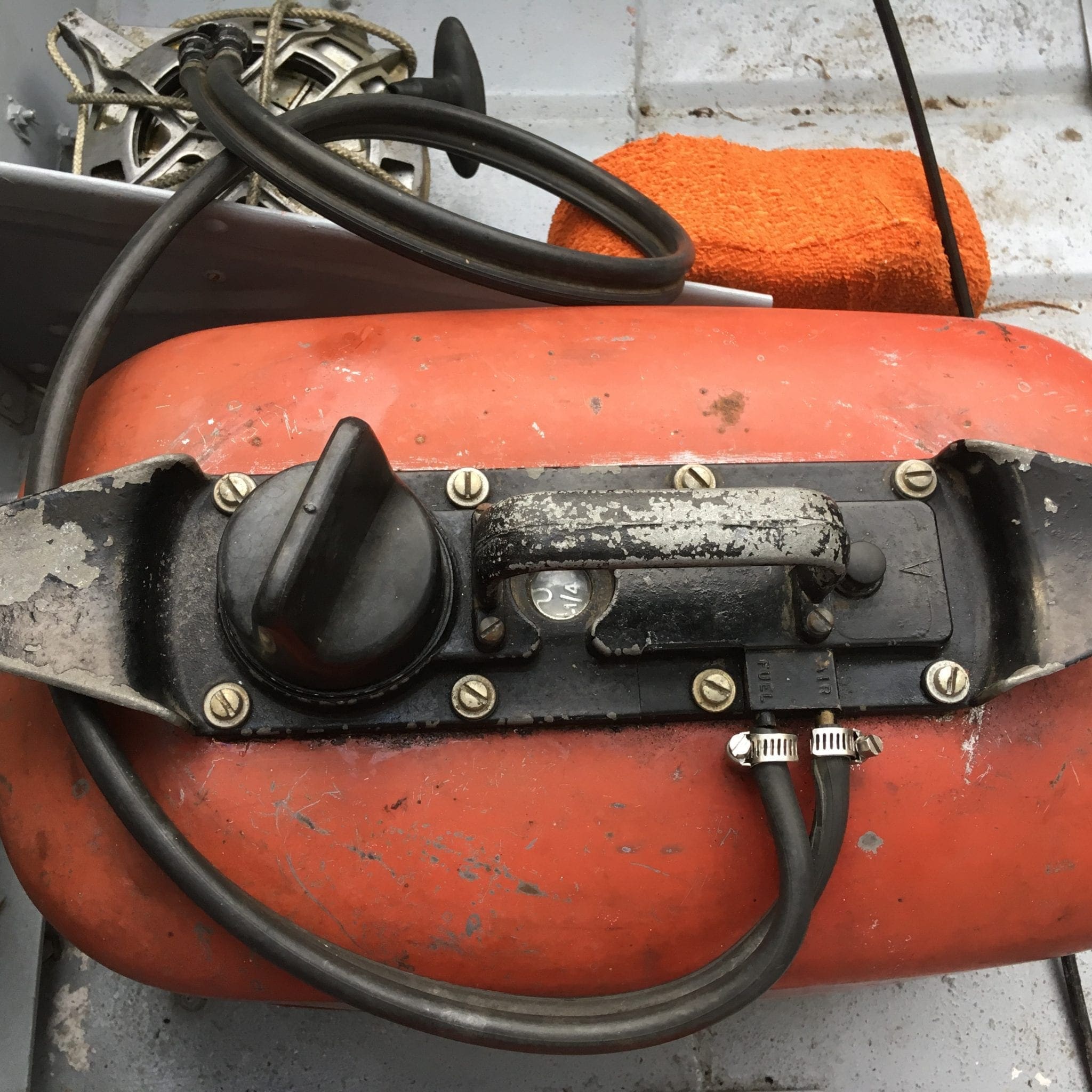

      Have a question—should this fuel tank hold pressure when not attached to motor and should you hear the pressure release when fill cap is opened slowly?
      Thanks trying to figure out why no fuel to motor.

      #181058
      Steve Martin
        Yes to both questions.
        #181061

            #181126
              Is there a check valve in the pickup that is stuck open or closed ?
              #181133
              chris-p
                So you are saying if you have the tank hooked up to the motor, and you prime the button it will not fill the carb bowl?
                Or….it will not pressurize while running to keep fuel flow flowing?
                #181158
                benji41
                  Chris-p I had it running a very short time then quit (with fuel in carb bowl) now will not start. Very good spark and rebuilt carb and plugs not very wet just like a light mist of fuel on them.
                  With tank disconnect and I pump the prime button then open cap no pressure.
                  Jim Benjamin
                  #181159
                    That button does not pressurize the tank.. it only sends fuel to the carb. The motor when running sends pressure to the tank
                    #181163
                    ED
                      Time to disassemble tank and clean. Replace diaphragm and top gasket. Inspect lines for cracks. Make sure valve in pick up tube is free and functioning. See above, primer pump does not pump air
                      #181165
                        As stated, the primer button on the tank primes the carb. If the tank is nearly empty, you may have to keep on pumping the button a bit to keep the motor running until it can build up enough pressure in the tank for the fuel to flow on its own.
