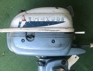

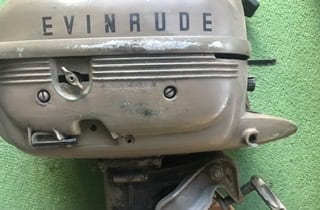

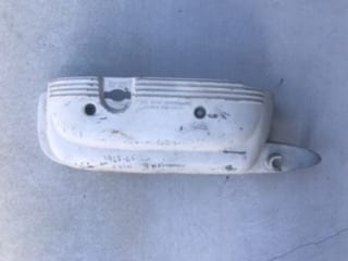

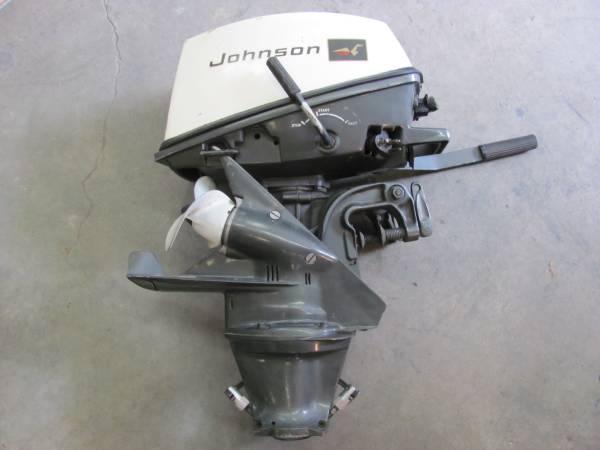

      I do have several nice Evinrudes though from the era, and I recently picked up a nice original 1962 that was missing its lower cowls. In the process of trying to find a replacement pair I noticed that even though the cowls seem interchangeable for many years there are some differences that go beyond paint color and decals. There’s a cutout for a water flush screw on the early ones that’s missing from later ones for example.
      But there’s a semicircular flange in the starboard cowl casting near the handle that shows up somewhere in the mid 60’s that has me baffled (see photos).
      It’s on my ‘67 Ducktwin but also on a cowl from a ‘66 that I picked up. Another’62 Lightwin I have doesn’t heave it.
      Does anyone know what this might be for? My guess is it might be for an external gas tank connection, but I’ve never seen one set up like that.
      Any ideas?
      Thanks
      ‘67 Ducktwin with “C”
      Plain ‘62
      ‘66 with “C”

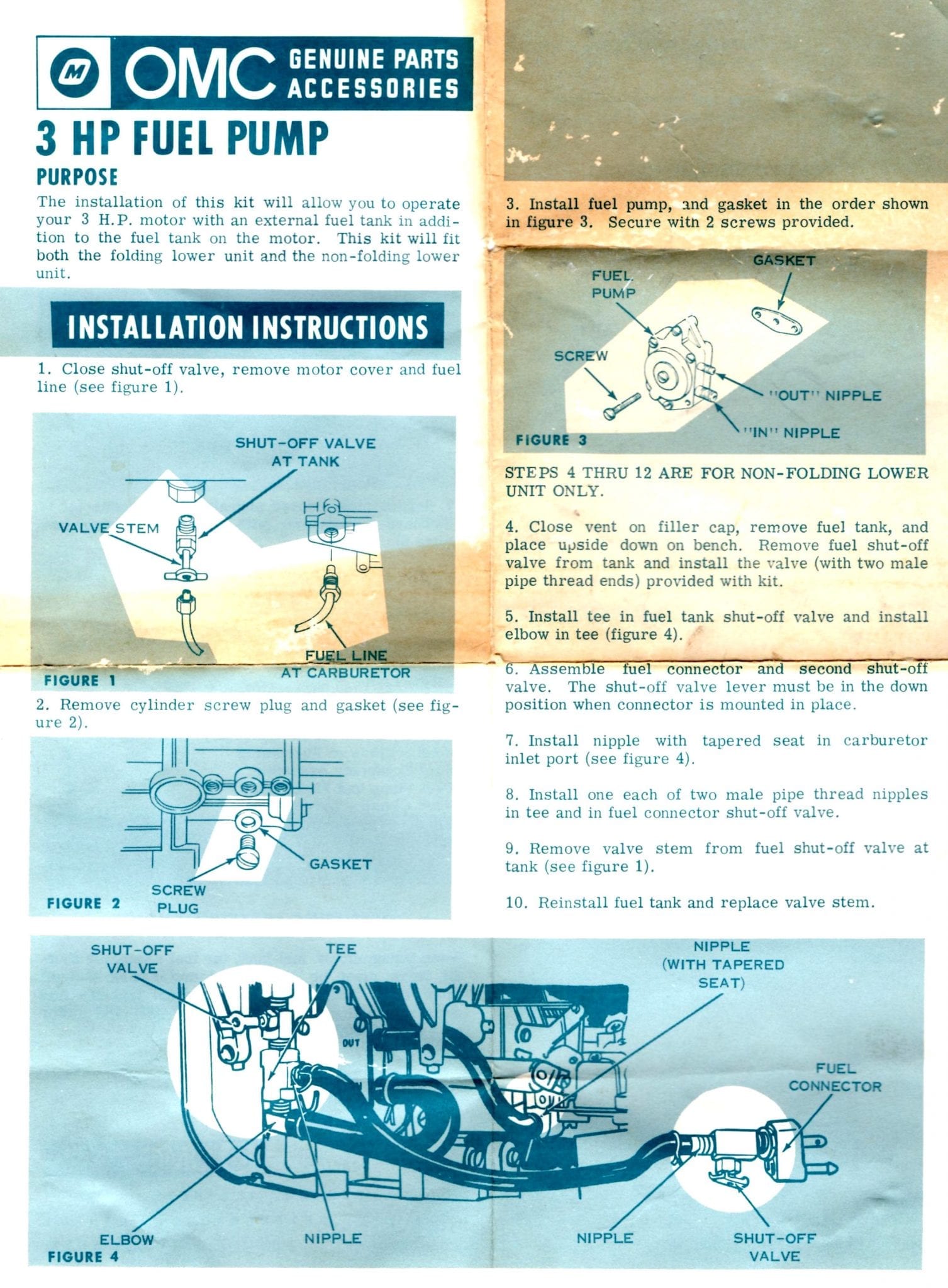

        Your guess is correct. They offered a fuel pump kit back then. The kit allowed the motor to be run on the built-in tank or a regular remote tank.
        3hp-Fuel-Pump-Kit-pg-1
        3hp-Fuel-Pump-Kit-pg-2

            Your Ducktwin was originally a folder and the rear recessed area on the cover is where the bottom of the skeg goes when it’s folded up. The latch keeps it in place.
            • This reply was modified 6 years, 10 months ago by Mumbles.

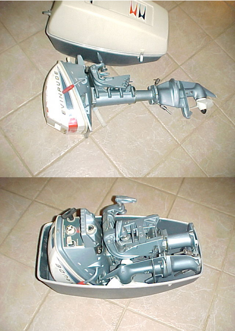

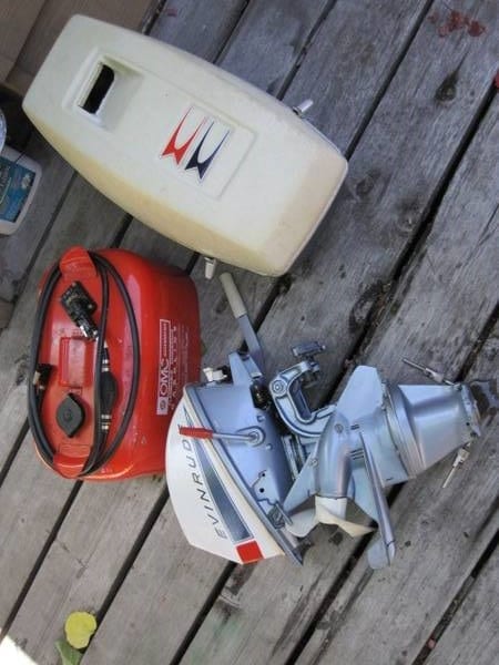

                      Some more folders folded up. Not mine.
                      Folder-W-Case
                      1965-Evinrude-Folder
