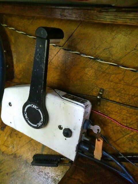

          Post a picture of the control box, there was/is a kit available to make sure those warm up levers stay down/in place. Needless to say, a preloaded/overtightened throttle cable will cause this issue as well…

              Don’t disassemble the control box, please post a picture of your control box, so I can see if it has the update kit on it. The warm up lever should have a black plastic snap/clamp/lever set up that mates up to the black plastic piece retained by the key switch. It is possible that these parts are in place, but broken.
              In other words, you should not be able to pull up that warm up lever (with control box in neutral), unless you pull up on the black plastic locking lever…
              But, once again, if your throttle cable is "preloaded", too tight, this can cause the warm up lever to pop up on its own as well…

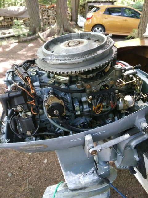

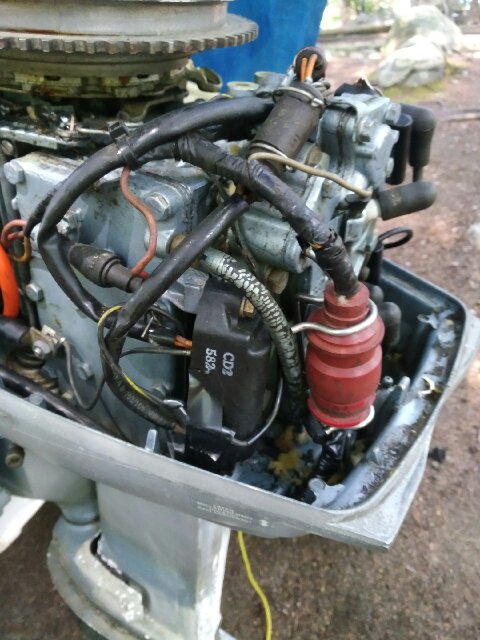

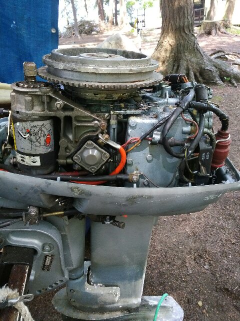

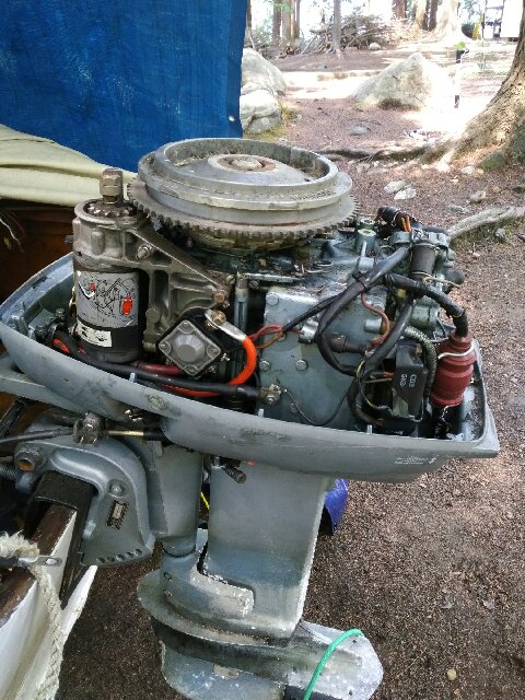

                  you can email them to me if you like, and I will put them up…

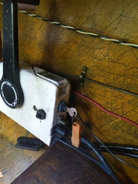

                    Thanks Fleetwin photos sent.
                    #78972
                      OK, well your 35hp is a short shaft mid 80s model, and that control box has never been updated…Does that "kill switch" work, or did someone bypass it? If indeed the safety stop switch works, try shutting the engine down by pulling the safety lanyard off while running to see if it shuts off properly…
                      You will need items 73-76 (two of the screws) to update your control box, you may have to drill the two holes in the warm up lever for the screws to go through. There used to be a "kit" to update the original control boxes, but I don’t have that part number and doubt it is available…

                      mgsolakis
                        No the kill switch does not work on this control. Where do I drill the holes to update this control? I have another control I might be able to use as well I’m not sure if it’s newer or older, it looks a bit different.
