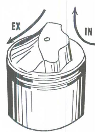

      hey guys . need a little advice . pulled the pistons out of the 3hp and forgot which way they go back . also , cylinder clean up . what grit would be best on a hone ? thanks
      #269442
      wedgie
        Long side of slope goes to exhaust. I think 40 grit is good. Just a caution not to overdo the honing. Do the minimal to achieve the crosshatch.

            Crossflow-Piston
