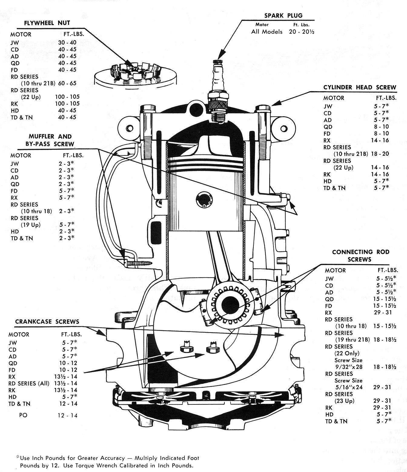

      hey guys . need help with a 3012 evinrude . does anyone have the torque setting spec’s ? need rod , crank case , flywheel , exhaust , etc . maybe a chart ? thanks in advance .

          This is a nice handy chart to have too. Use the JW values for your 3 horse Evinrude.

            Thank you both for posting these data charts … very timely for I’m just starting to put back together a 3034 3hp.

                HEY . thanks to both members for the info on torque specs for the jw/3012
