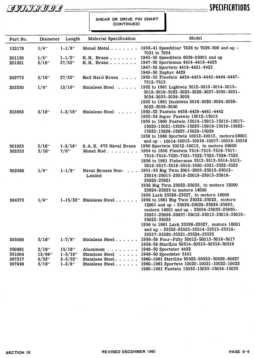

      Can anyone give me the shear pin/ drive pin size dimensions for a 1966 Evinrude 3hp? Im away from my PC so I don’t have my notes and manuals.

        I think it is 1/8″ X 0.815″. Size #2

          #175581
            see list

                  I picked up a ’53 or ’54 Evinrude Lightwin (3012; #46506) yesterday and the shear/drive pin is brass.  Does it matter whether the pin is brass or stainless steel?  The chart above says SS for this model but I would think that brass would be better protection as a shear pin.

                      I just found a copy of the owner’s manual and it discusses the “propeller slip clutch”  Should I trust a 70 year old piece of rubber to not have hardened and become less of a slip mechanism?  The illustration in the manual does label the shear pin as “shear pin” and not drive pin.

                        OK I have to admit they get petrified with age. Still, it seems better to replace the rubber ring and restore the fine feature it was built with.
