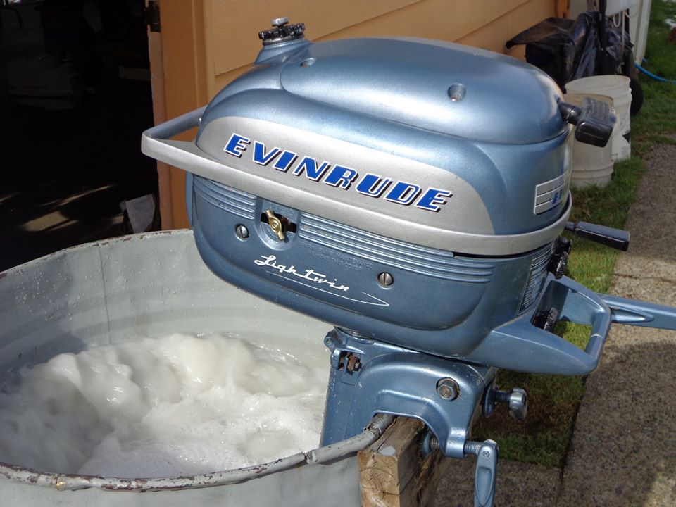

      hey guys . need help with the 3hp 1952-54 . what models correspond with what model year . thanks

              If it’s not a three horse Johnson JW, it must be an Evinrude Lightwin.
              Early-Lightwin
              #247778
              JEFFREY PLITT
                yes . thats the motor . my problem is the correct colors . i need to transpose a model number into a specific year so i know the correct color . there are a couple of different blues
                #247800
                  Lakeland Blue and Dull Aluminum were used on the ’51 and ’52 motors while Polychromatic Blue was used on ’53 thru ’58 Evinrudes.
                  #247833
                  retiredoz
                    My semi-impeccable source says the ’52 ser no starts 01501, the ’53 starts at 34000 (as does the ’54).
