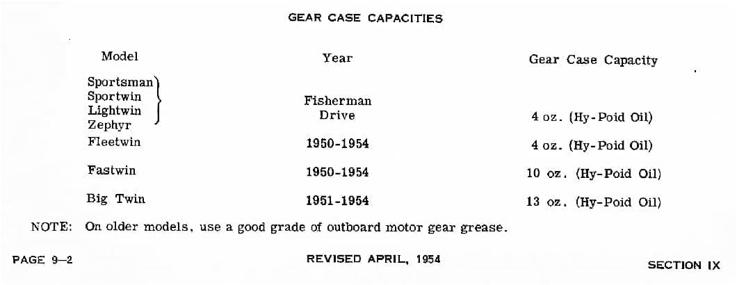

                  As as general rule, angled drives require gear oil as they have a ball bearing above the pinion gear and lip seals on the shafts. Older right angle drives without lip seals had bushings and used grease otherwise the oil would leak out and water would get in.
                  Gear-Lube

                  todd281
                    ok, mine is the right angle drive so it looks like stiff grease for me . How much grease does it get? packed full or 1/2. thanks for all the help so far
