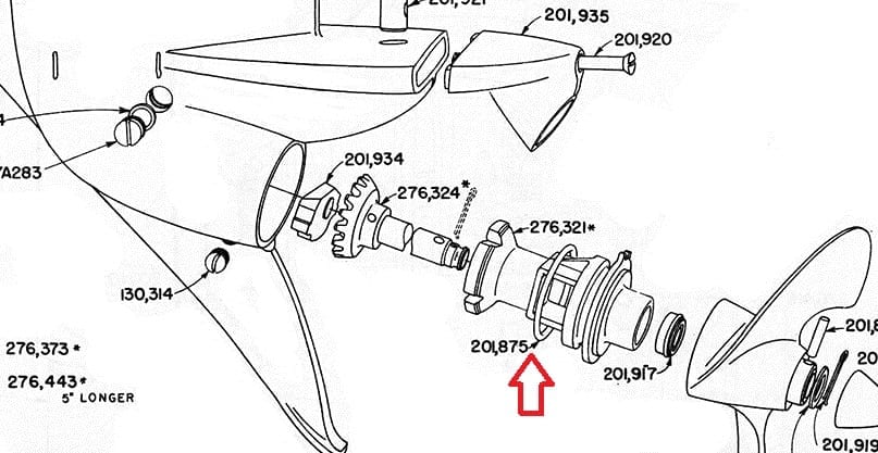

      While disassembling my Evinrude Sportsman Model 4416 gearcase One of the parts broke. The gearcase had some really nasty hard grease and some aluminum oxidation . The drawing I have lists it as part number 276-321 . I am wondering if anyone has a updated part number? [or perhaps that part in their parts box] Thanks in advance

        That prop shaft and bearing assembly was also used on the Sportwin from 1948 through 1951. I know of no superseding number. Well over 100,000 were built, you should be able to find one –

            what broke exactly on 276-321 the main body unit ??
            or the part pointed by the red arrow….? the red arrow one looks like a o-ring

              the o-ring is part #201-875 the part that broke is the casting # 276-321 thanks

                  The 276321 P/N for the bearing carrier doesn’t appear in any of my superceded lists so the number should still be good.
                  If you can’t find that part, I have a 4416 donor motor sitting here you are welcome to. You just have to pay me for the shipping costs.
