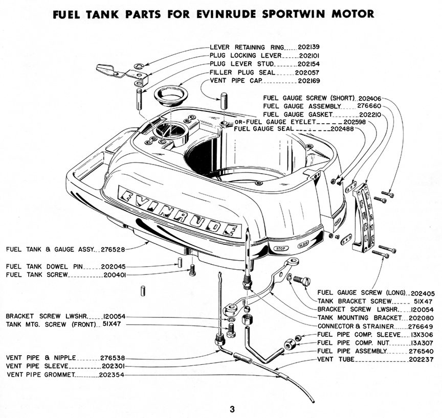

      hey guys . need help with the sight glass fuel gauge on the 4423 . i have 2 gaskets but the plastic gauge is warped and they leak . also have 2 small o rings and 2 small gromets that go with them . orginal part numbers . i cant figure the configuration to install . any ideas ?
      #287534
        This diagram should show you how those itty bitty parts stack up.4423_Tnk

          • Where can I find parts for 4423 Evenrude 3.3?
          • 202488,202598,202210
          #297000
          David Bartlett
            202488, and 202210 are available on eBay!
