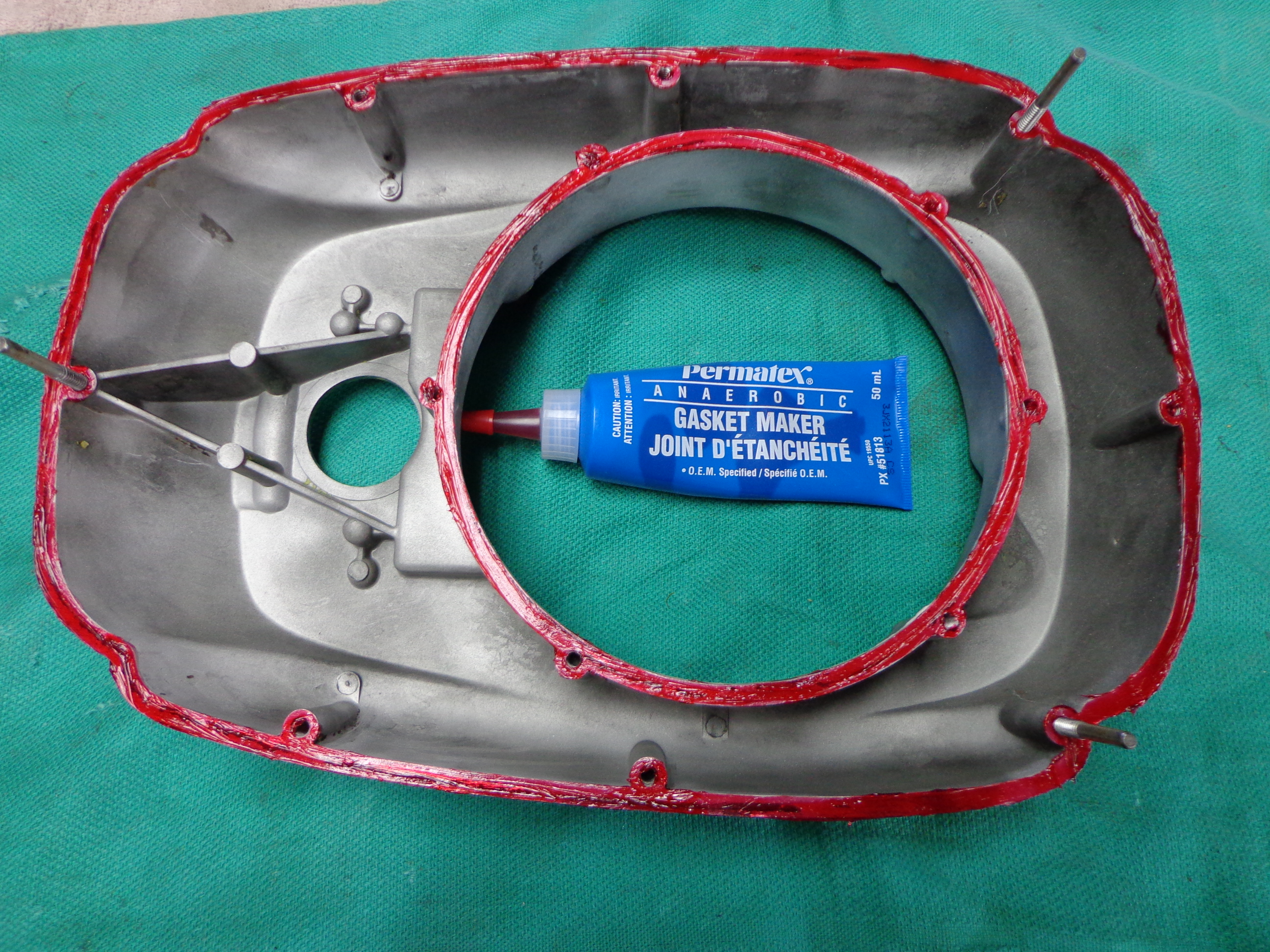

            You did the right thing taking the tank apart, especially because it was leaking. The hard part is now getting everything clean and especially the area to be sealed. There are several products that you can use to seal it up. One readily available one is the Permatex Anaerobic Sealant No. 51813 https://www.ebay.com/itm/PERMATEX-ANAER … -1&vxp=mtr.
            The screw threads also need to be coated with the same sealant used for the tank. A Phillips head screwdriver is helpful to line up the two halves for initial placement. Be careful not to use too much sealant on the tank, or you can have trouble getting the halves completely seated. Some light taps with an impact driver can help pull it together after hand tightening.

              The 51813 Gasket Maker was used on this 4425 tank with good results. You can see the three coil screws (with the heads cut off) used for the alignment of the two halves. It’s been close to four years now and no leaks yet!

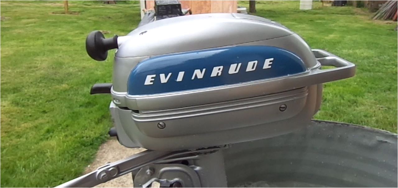

                I am also working on a 4423. I wished mine looked like Mumbles last picture…except all the fun would be over already. Ready to paint the tank. Have appropriate paint colors, but I have no clue about the letters, except that they stand proud of the tank, look like the silver paint, or the aluminum itself.. Are they a decal? Are they painted? Sure looks like a masking tape nightmare if not a decal!

                  if the letters are raised just hand sand with 220 wet-dry sand paper. sand front to rear. just my thoughts that is what I did years ago.
                  #70475
                    On the raised letter Sportwin tank, I painted the whole thing and then block sanded the paint off the letters with 440 grit wet or dry paper working to 1600 grit and finishing with jewelers rouge polishe. . . 😀

                      Great idea from Mumbles with the "coil screw" alignment pins for cementing the tank halves. I hope to remember that trick. The anaerobic sealant is somewhat unforgiving if the halves get put together misaligned. I found out the hard way. 😯
