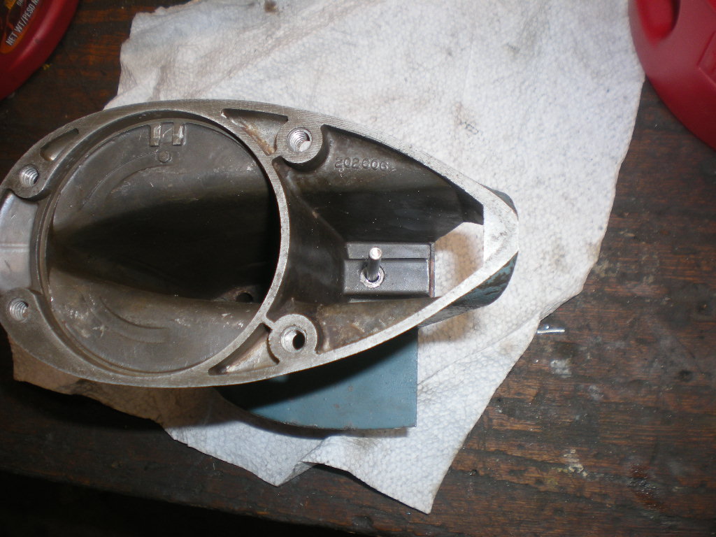

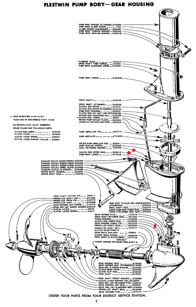

      I’m trying to get the upper shift rod seal removed from
      the pump body. The diagram shows a retaining washer
      and seal. I tried prying the washer out with a punch
      but it didn’t budge. Then tried screwing a long #10
      machine screw into the washer then pry it out,
      but still didn’t move. Then wondered if I could drive
      the whole thing out from the bottom, but my rod
      stopped about 1/2" short of the washer, so not sure
      if I was taping on the seal assembly or part of the
      housing, and I didn’t want to bust it apart. 😮
      The washer looks pretty thick, and I can’t tell if there is an
      O-ring below it or other type of seal.
      The bottom shift rod seal that goes between the two
      housings was just a flat rubber washer. Perhaps
      I could put an O-ring there.
      Anyone have experience replacing the upper shift
      rod seal on these model Fleetwins, or have info
      from a service manual that tells how?
      The 4447 that I also have apart looks the same as
      far as the seal.
      Thanks!

        Heat on the outside of the housing around the seal and retaining washer with a propane torch may help you to get it pried out with a screwdriver. I find heat works great for removing driveshaft seals at the top of RD gearcases, allowing a screwdriver to loosen it without much trouble – I think it may work here too.

            Thanks for the tips. Will try some heat tomorrow.
            Am curious to see what’s under that retainer washer.
            Hopefully it doesn’t burn up before I find out, lol.
            Maybe I could rig up my slide hammer to the
            washer some how if necessary.

              I tried zooming in to see if it was swaged in place but I ran out of pixels!
              #61076
                Just a little blurry Mumbles 😀
                I don’t remember seeing any swag.
                Perhaps it’s like a tapered plug,
                or has some good sealant on it!

                  Was able to remove the so call "retainer washer" and
                  o-ring for the upper shift rod seal. Used a little heat
                  and a slide hammer with a screw bit in it.
                  The washer in actuality is about 1/4" thick
                  with a hole in it for the shift rod. It may be
                  slightly tapered. The affair can NOT be
                  driven out from the bottom.
                  Of course, the o-ring needed was not one
                  the size in my o-ring kit, so I had to improvise.
                  Have the lower unit, gear case, etc. all bolted
                  together now, and am attempting to adjust the
                  shift rod so everything functions correctly.
