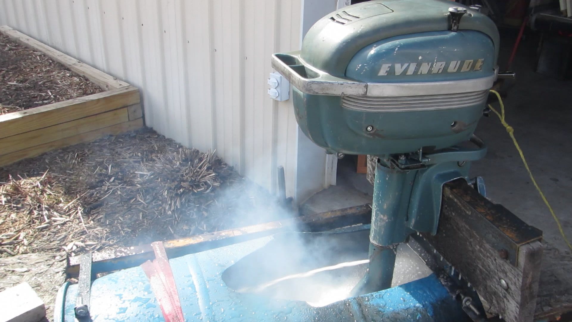

            labrador-guy
              Yes the 5 1/2 impeller will work it needs to be sanded down a little and the ID needs to be bored out a little. The sanding goes easier than I thought it would if you have a belt sander. Take a little of each side and check it often in the housing. They pump like crazy. Mine shoots the water out about 20 inches behind the motor.
              dale

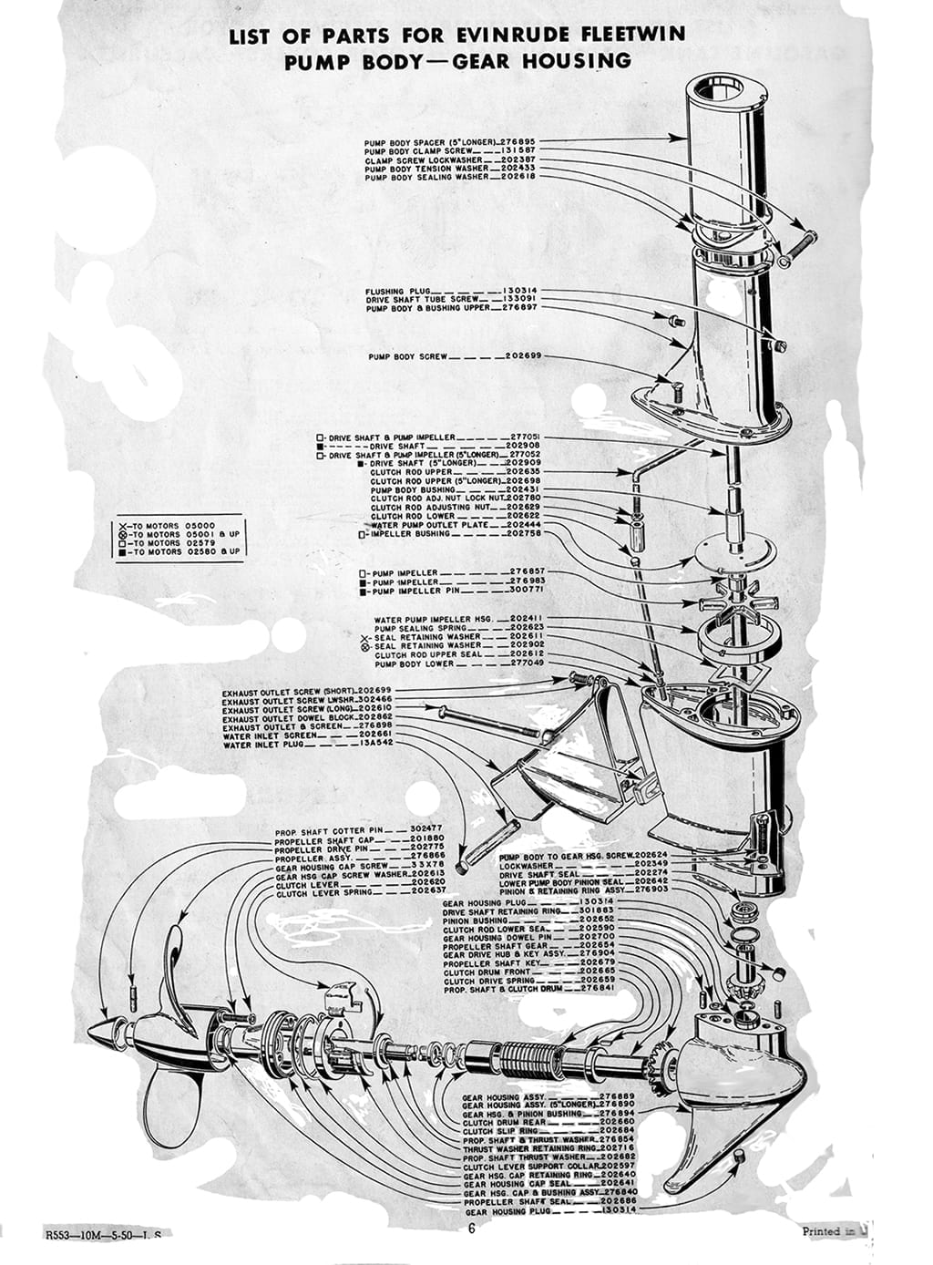

              #189035
                This is what I was trying to post
                1950-Evinrude-FleetwinPg.06w
                Garry in Michigan
                #189038
                  1950-Evinrude-FleetwinPg.06w-1
                  Garry in Michigan
                  #189041
                    1950-Evinrude-FleetwinPg.06w-2
                    Garry in Michigan
                    #189044
                      1950-Evinrude-FleetwinPg.06w-3
                      Garry in Michigan
