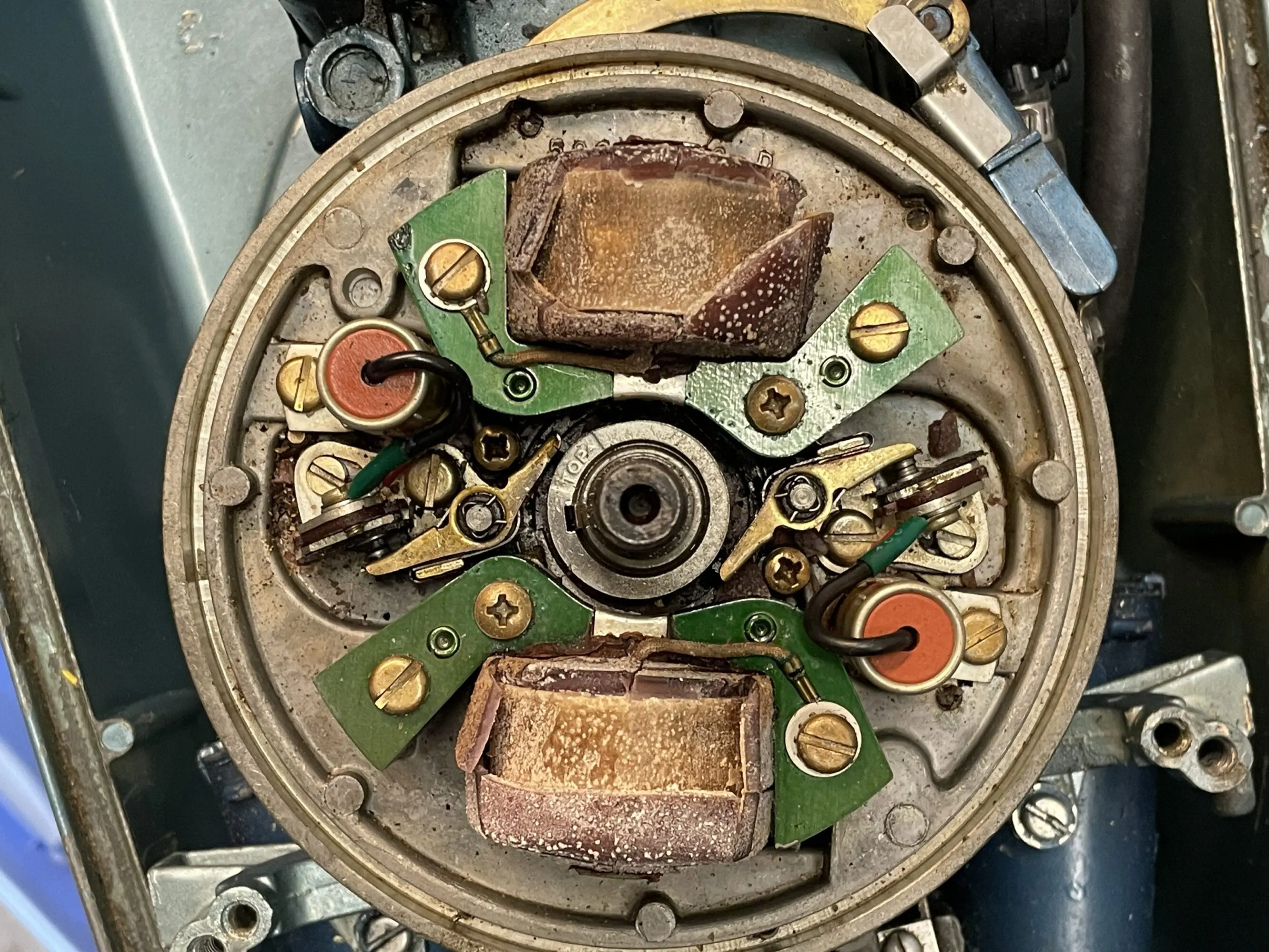

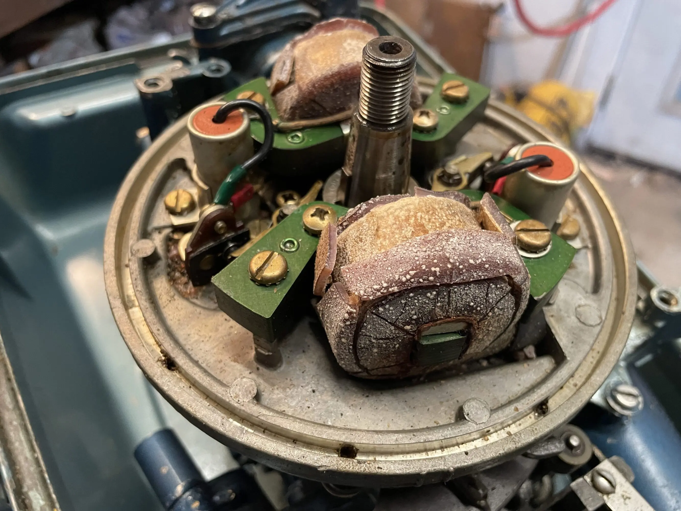

May 14, 2026 at 8:26 am #318753Well, you mention it has no spark. Did you try both plugs to check for spark on either cylinder? It won’t run with no spark. Remove the rewind starter and you will notice an inspection cover on top of the flywheel that can be removed with a few screws. Remove the cover and have a look at the ignition coils/components inside. Pay close attention to to potting on the ignition coils. Is the potting chipped, cracked, flaked off? If so, you will need to overhaul the igntion system. If not, you can simply check the point gap and clean them without removing the flywheel. You will need to clean up/dry any fuel spilled in the lower motor cover before attempting to check for spark again.

May 14, 2026 at 12:33 pm #318777It needs good and strong spark to run. If the spark is weak or non existent, the usual culprits are, in no particular order, dirty or burned points, weak or leaking condensers (capacitors), deteriorated ignition coils.
May 14, 2026 at 2:02 pm #318786and cracked wires from years of bending

May 23, 2026 at 9:31 pm #319751I had a chance to work on the engine recently, and this is what I found:
According to the Kindle book “Cheap Outboards”, cracked coils should be replaced. I think these qualify as cracked. There is debris in multiple places. Even though the previous owner said the engine had been tuned up, I’m thinking since I’ve got the flywheel off I might as well replace the plugs, points, and condensers too. Can anyone provide a link to a source for these parts? I don’t know any part numbers (maybe it doesn’t matter much for these old engines?) so it would be very helpful if someone could direct me to the actual parts I need.Thanks much!
Here are a few more photos:
