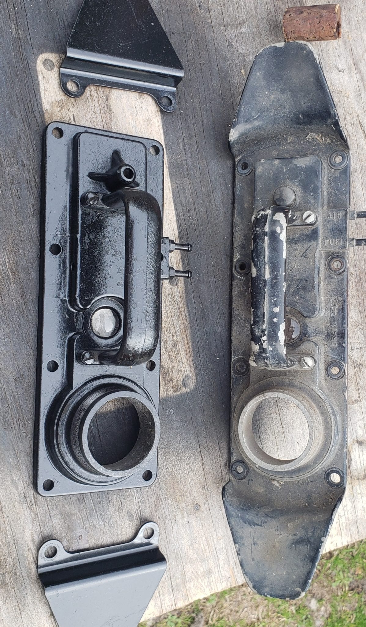

      Which tank top would be period correct for a 1953 25 hp big twin?
      One piece or Three piece?
      Thanks.

      MIKE SIMS
        Parts catalog for RD-14 1953 shows three piece. One piece started with RD-17 1955

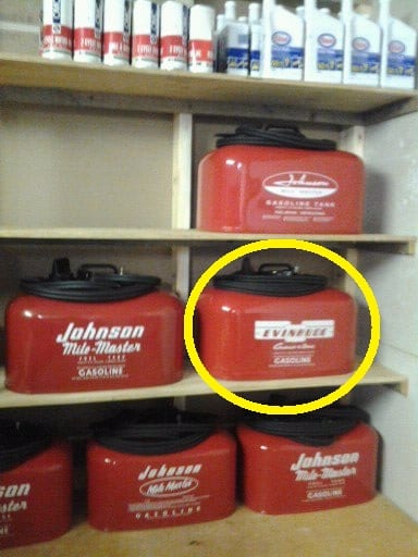

          And this would be the correct style decal for it.
          Pressure-Tanks

          Harley Snipes
            Thanks! The 3 piece came with the 25 hp, but my untrained eye thinks it looks like the newer set up.
            #228400
            Harley Snipes
              Cool. I have it ordered. There were remnants of it on the tank but PO had started a sand and paint project with it.
              Nice tank selection there.
