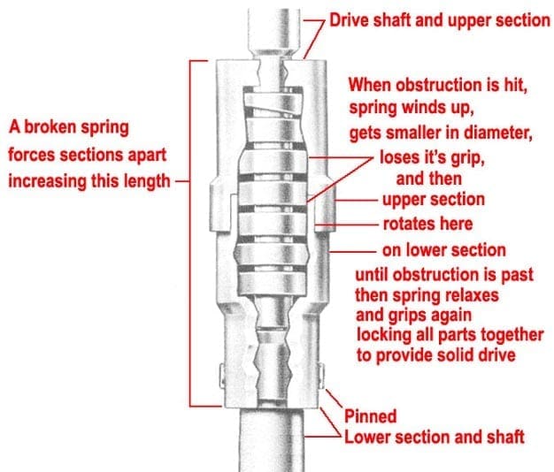

            Shock absorber in lower unit is broken and/or expanded. You disturbed it when you unbolted the pump
            Shock-absorber-operation-iboats

              You could try pulling it with the plugs out to see if there is resistance from something other than compression. Some of these motors have a clutch-spring setup on the driveshaft for protection from prop strikes, and these can expand and create high friction. I think this feature begins in 1958 so should not apply to yours, but possibly worth checking.

                Like Frank says, that driveshaft shock may have expanded causing the driveshaft to bind on the upper bushing seal housing in the gearcase….Was the gear lube clean when you changed the impeller? I have never seen one of those old 7.5hps with such high compression….Usually see only 80PSI….So, I would recheck compression with another compression gage…. There is something unusual going on if the compression readings of 120-130PSI are accurate readings…

                      Frank, could be a damaged spring. Is it a hard to replace – worth it?

                        The shock absorber thought came because that is the usual reason a 7.5 or 5.5 is hard to pull. But now the question arises, is it the motor or is it you? I dunno. But I do know that I just recently bought a new cordless electric chainsaw because I can’t pull the rope on my gas saw anymore. This from a guy that used to rope start the biggest V-4 outboards. Embarrassing, huh?
                        Anyhoo, if it is the shock absorber, that doesn’t automatically mean it is broken. They sometimes expand just from hard use. If it is just expanded, just mash it back together and run it another 50 years. But if broken some people weld them. My only attempt at that did not turnout well. Replacement is the other option.
                        Only an inspection can tell for sure.
