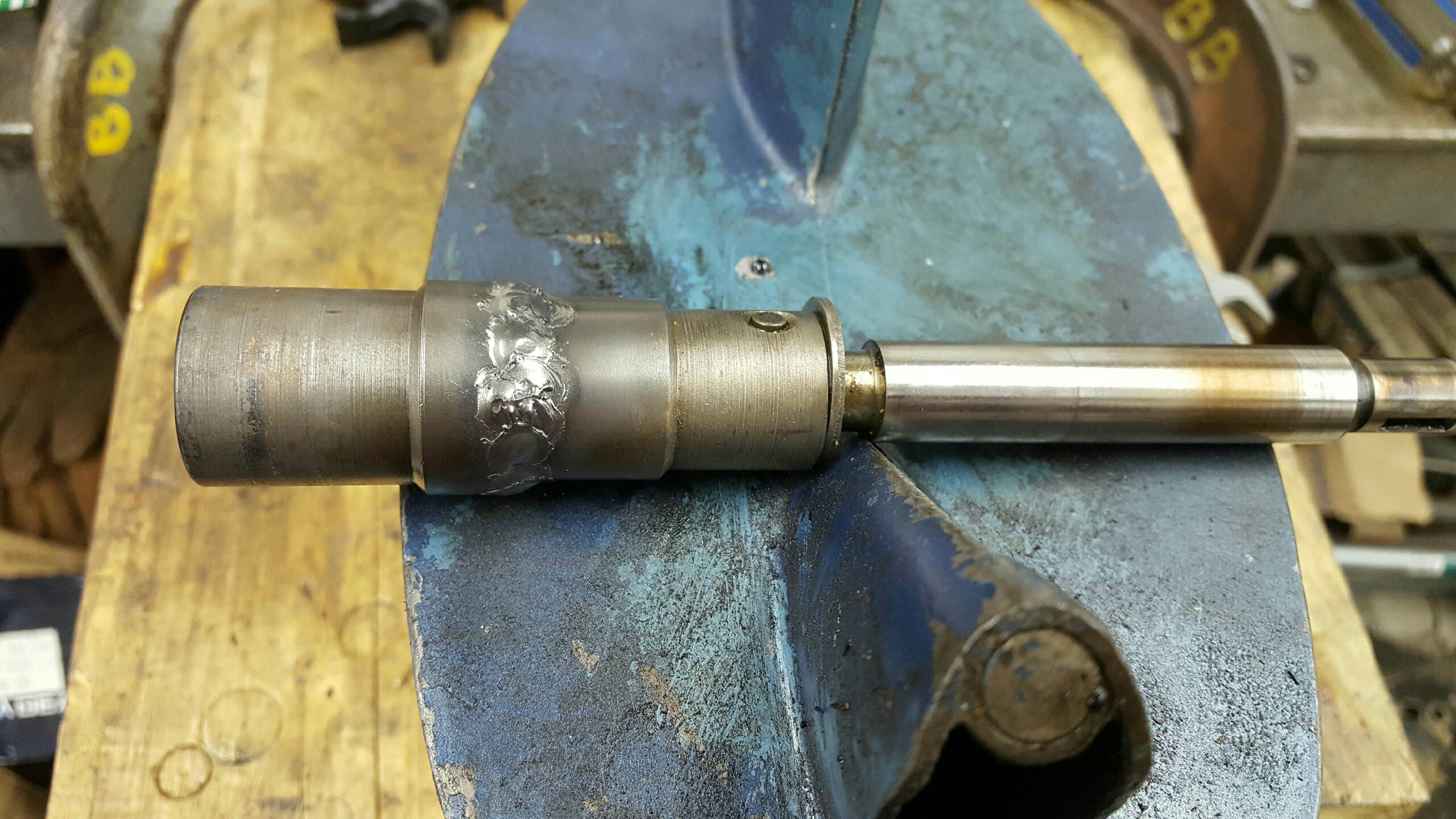

January 25, 2017 at 8:41 pm #51728I posted this in another thread earlier today, but here it is again. When I find a sprung or broken shock absorber in one of these, I squeeze or beat it back to within spec length, clamp it in a big C-clamp and weld that thing up so it can’t ever do that again. I then use a brass shear pin in the prop to save the gears. Here’s the last one I fixed.

If the surface above it is worn I would squeeze it and then weld it and then use a brass pin like Ben said.
January 26, 2017 at 12:32 am #51748Welding up the shock sounds like a good plan. I need to see if my
72 year old Lincoln welder is still working anyways!Prepare to be boarded!
