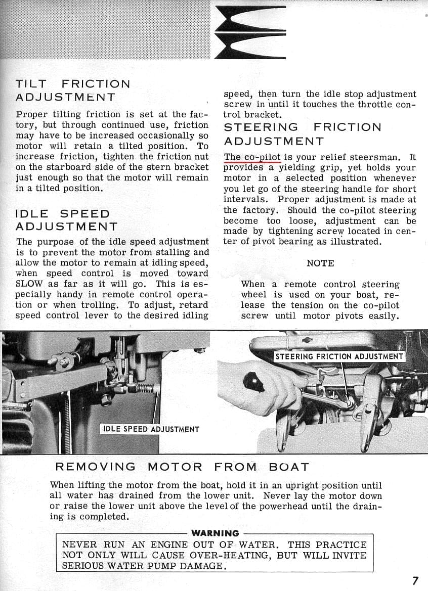

            I like that ad David. Not sure where it’s located on that motor but this was the location for that adjustment for many years shown in this ’62 Evinrude 10 HP manual.

                With a tiller motor, you want the co-pilot tightened just enough to hold the motor in place when you let go of the tiller but with remote steering, you want it loosened right up so the motor is free to flop around.
