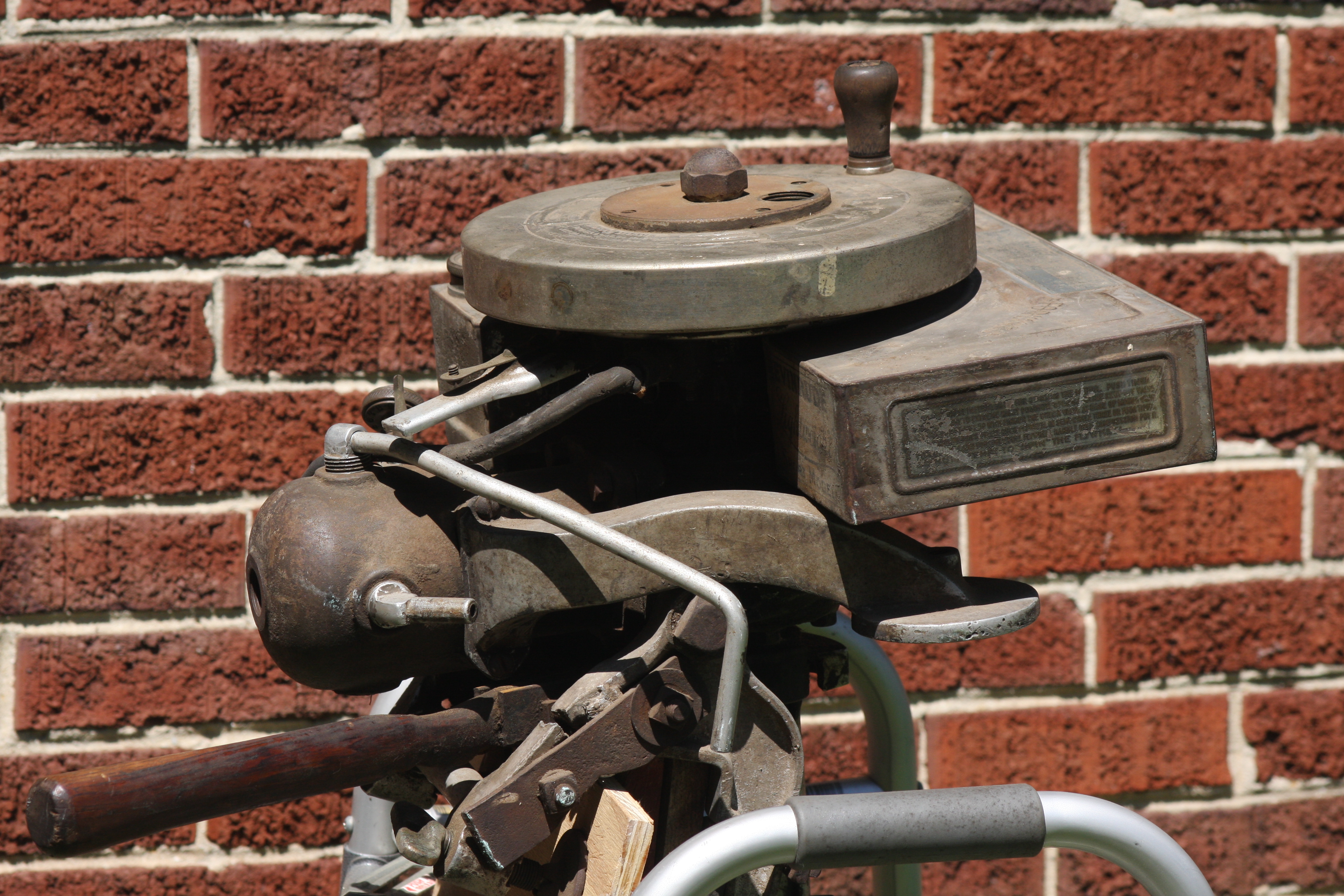

This is a new motor to me, it looks to be a pre 1925.

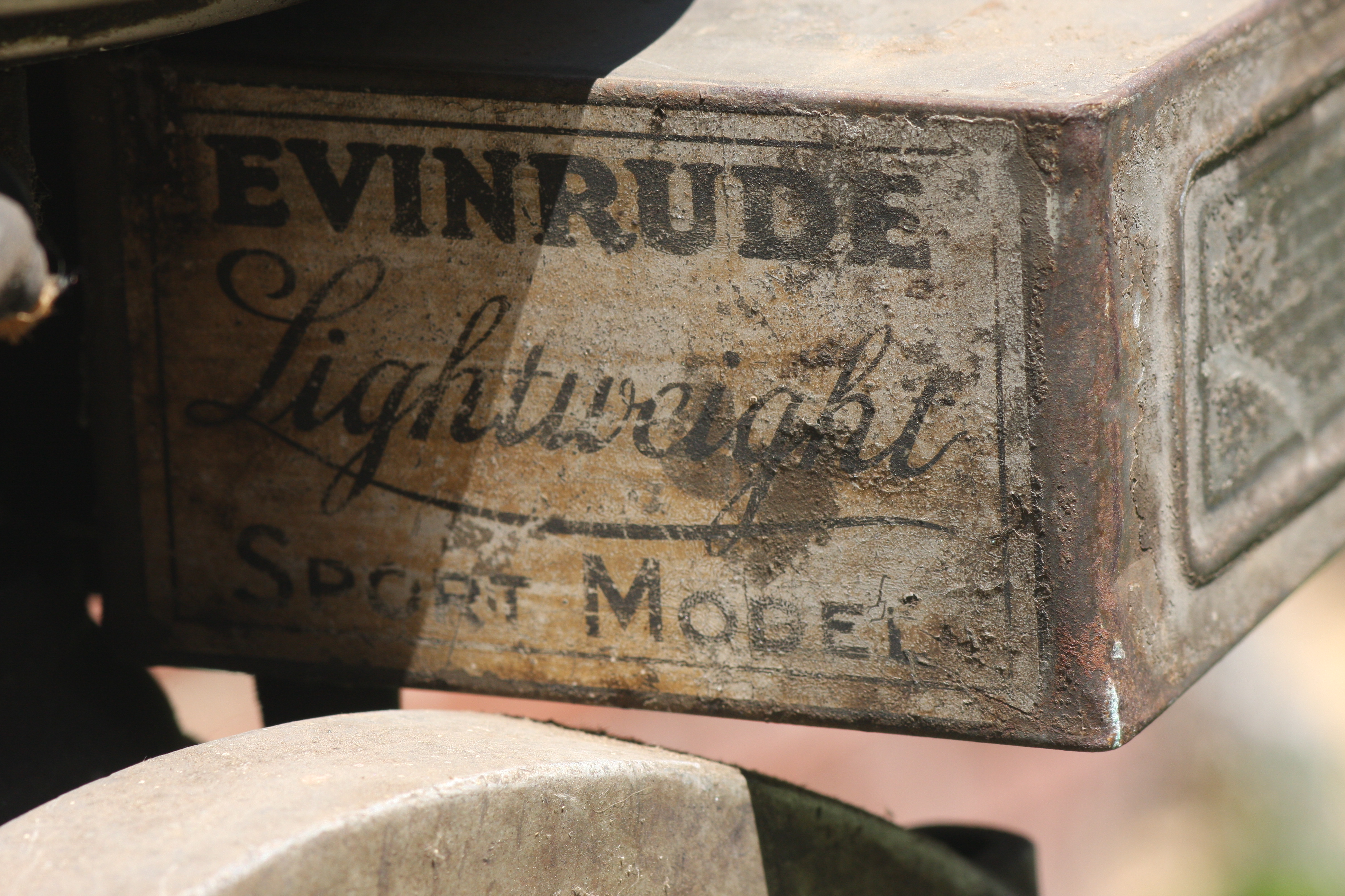

The Knuckle buster knob and flywheel look to be an Evinrude Model B. Transom clamps are aluminum. There is one decal on the gas tank that is very readable it reads "EVINRUDE Lightweight Sport Model". The Serial Number reads K 1598
I’ve done the preliminary "POSTMORTEM" and I know some of the parts that I need. what have I got here.
Pictures yeah I’ve got ’em, could not attach.
Thanks for any help.
Jim2Fast4Me
June 11, 2017 at 4:13 am #59451The aluminum model "K" was only produced in 1922 as an answer to the aluminum Elto. They used the same patterns as the cast iron model and so although lighter, it wasn’t as sturdy. So many aluminum parts broke that it was an embarrassment and quickly dropped from the line. It isn’t even included in later Evinrude model lists. So you have a very rare bird for which parts are impossible to find. . . 🙄

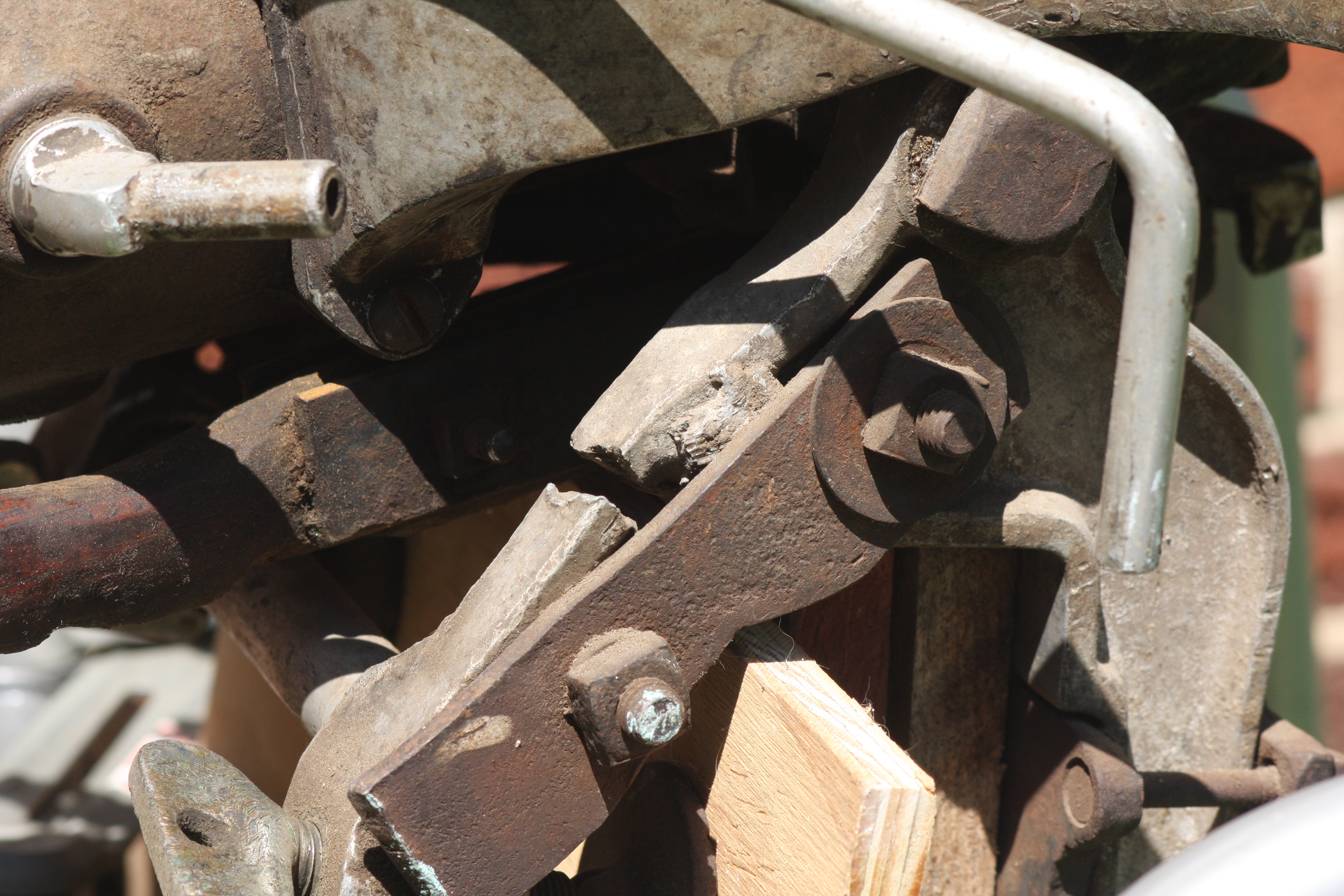

July 23, 2017 at 7:15 pm #62083July 23, 2017 at 7:24 pm #62085I saw Evinrude K-1598 at Constantine, and have photos of it in my archives. I guess it was you who brought it to the display tent.

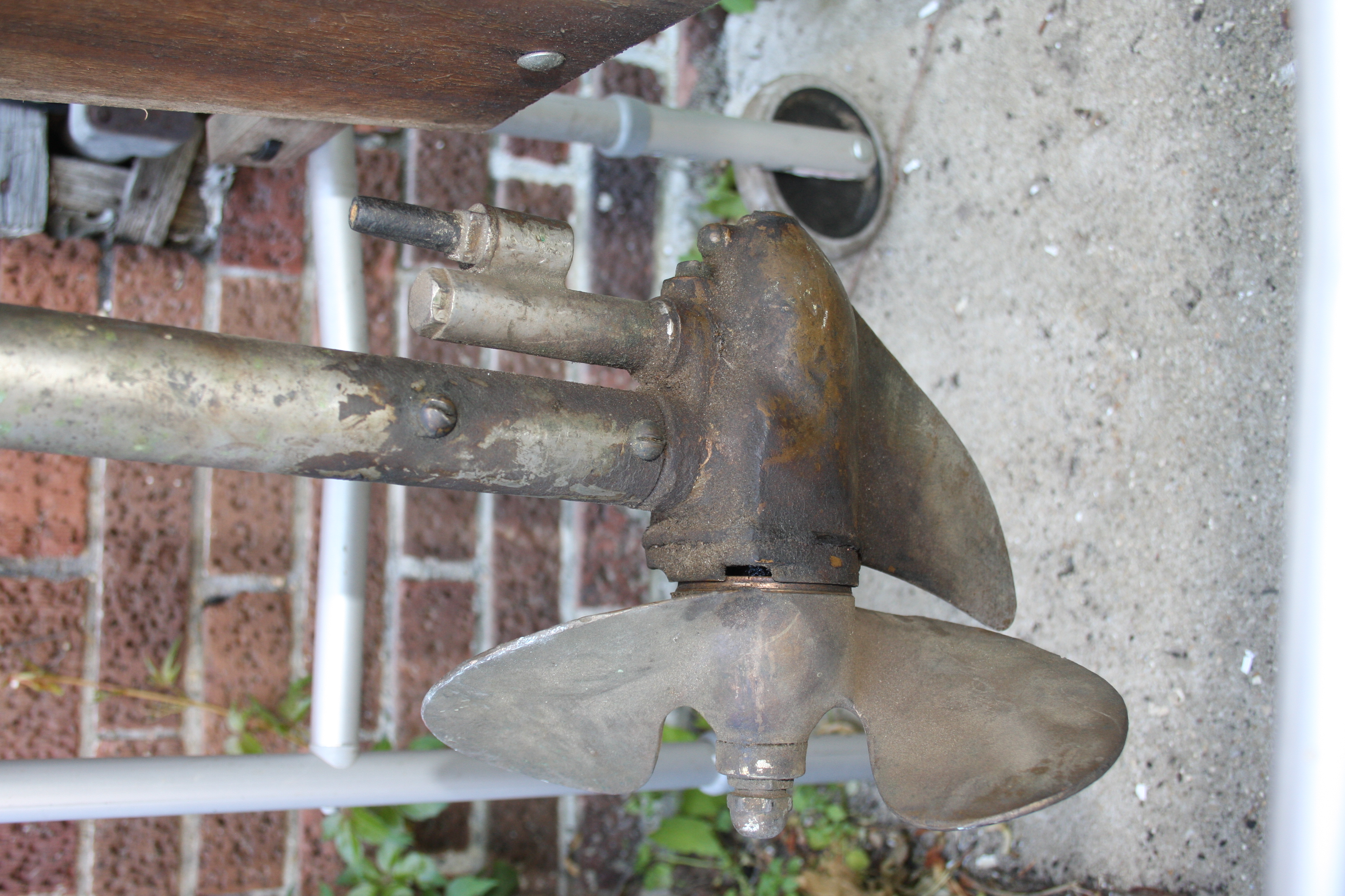

Chances are the lower unit also broke, they originally were aluminum housings, not bronze. I have seen aluminum lower units that survived. Funny that they replaced the housing but not the water pump.
#1598 has been well "loved", judging by the attempts to bolster weakened/fracture original pieces.
Good luck with it.
