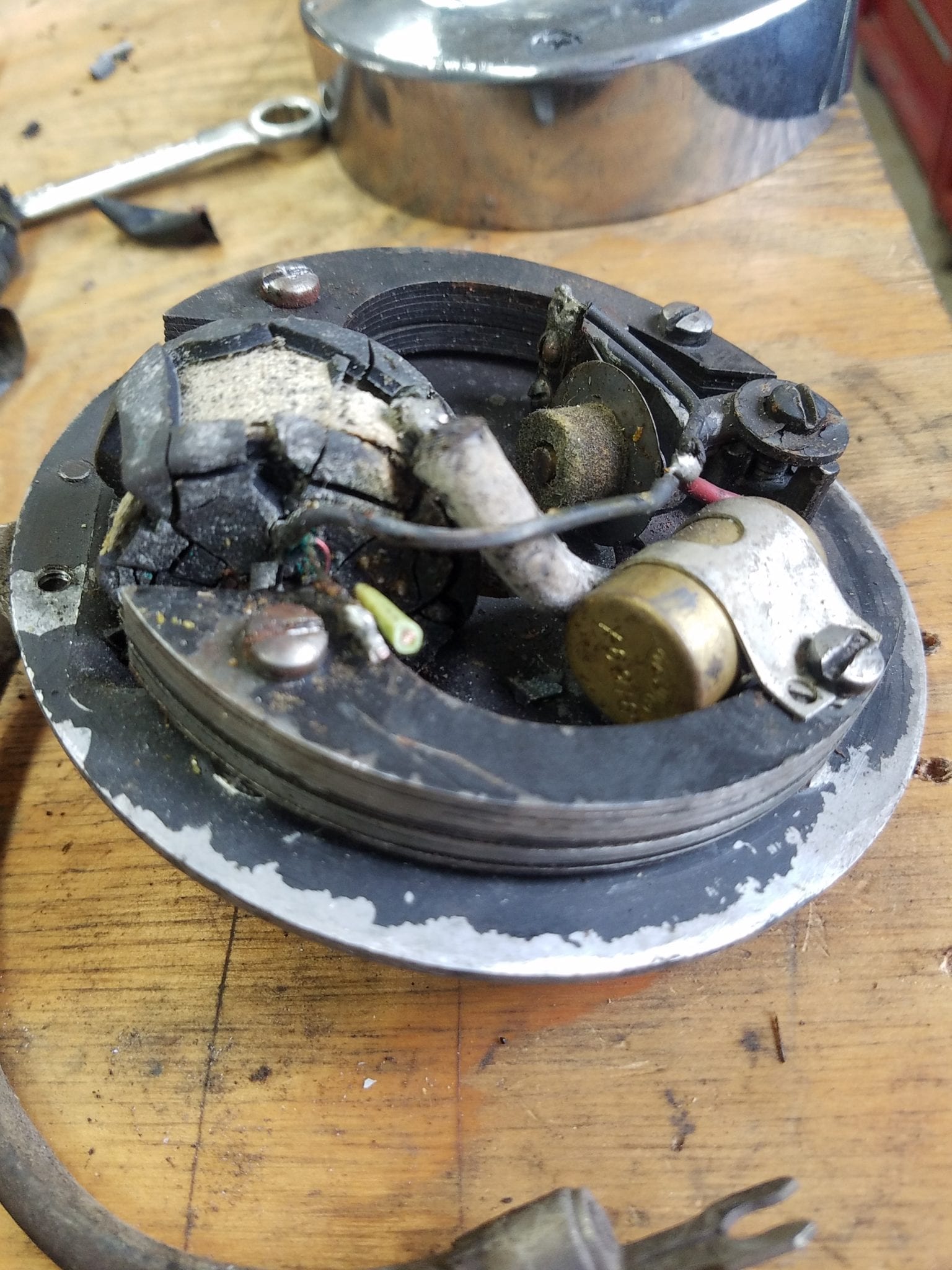

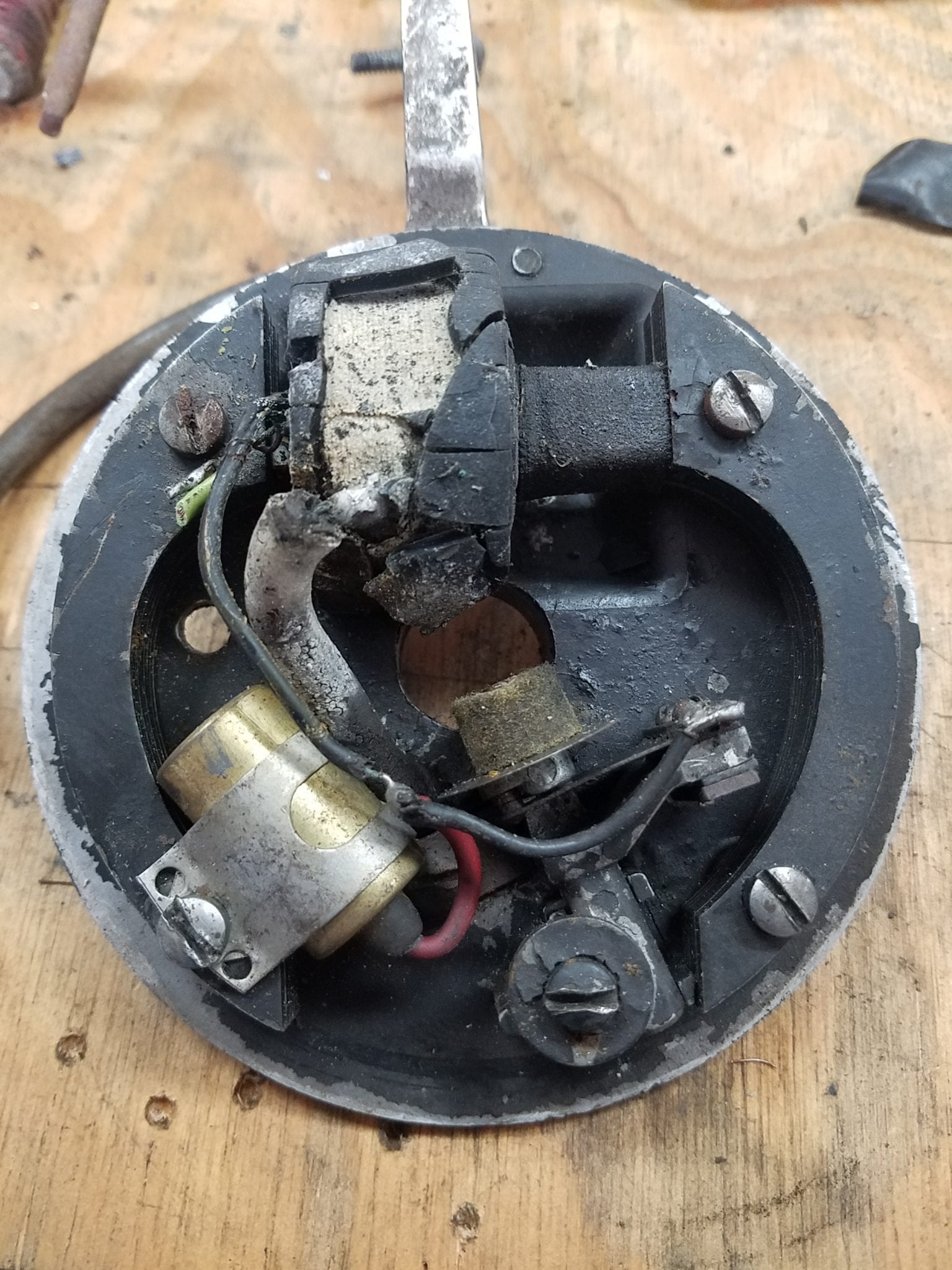

      I just picked up this cub in pretty nice condition other than the rope
      which one side got broke off.
      I am pretty sure from the two wires that were hanging from it the previous owner had ran a buzz coil on it.
      Is there a coil that will fit/work in this little motor that anybody knows of or one that can be modified to work?
      Thanks,
      Paul

        I can’t say for sure, but it looks like a good candidate for an OMC universal
        coil conversion. Should be lots to “search” for on the forum regarding the topic.

                I seen that as well. I also did a little more digging and found that the Andover military coil is the same as the Mercury chainsaw Disston coil. When I was looking on Ebay I found they looked the same. When I zoomed in on the pictures of each type I found they had the same numbers stamped on the outside. The main difference was the cost. The military coil I have listed in the link is $25. The chainsaw coil is listed for $45.
                The second link I had was just for the windings and looked like it could slide over the laminations for the Cub. I don’t know enough about coils to know if this would work or not but is sure seems like it might. If so that one looks small enough that it could possibly match in size to the Cub coil. I am hoping the seller emails me the dimensions. If it is right, then it would just be a matter of do I toss $25 at it just to satisfy my curiosity. Either way I am going to buy the military coil.
                I am also going to peel back some of the windings on the cub coil to see what I find since I have nothing to lose at this point. I might even learn something.
