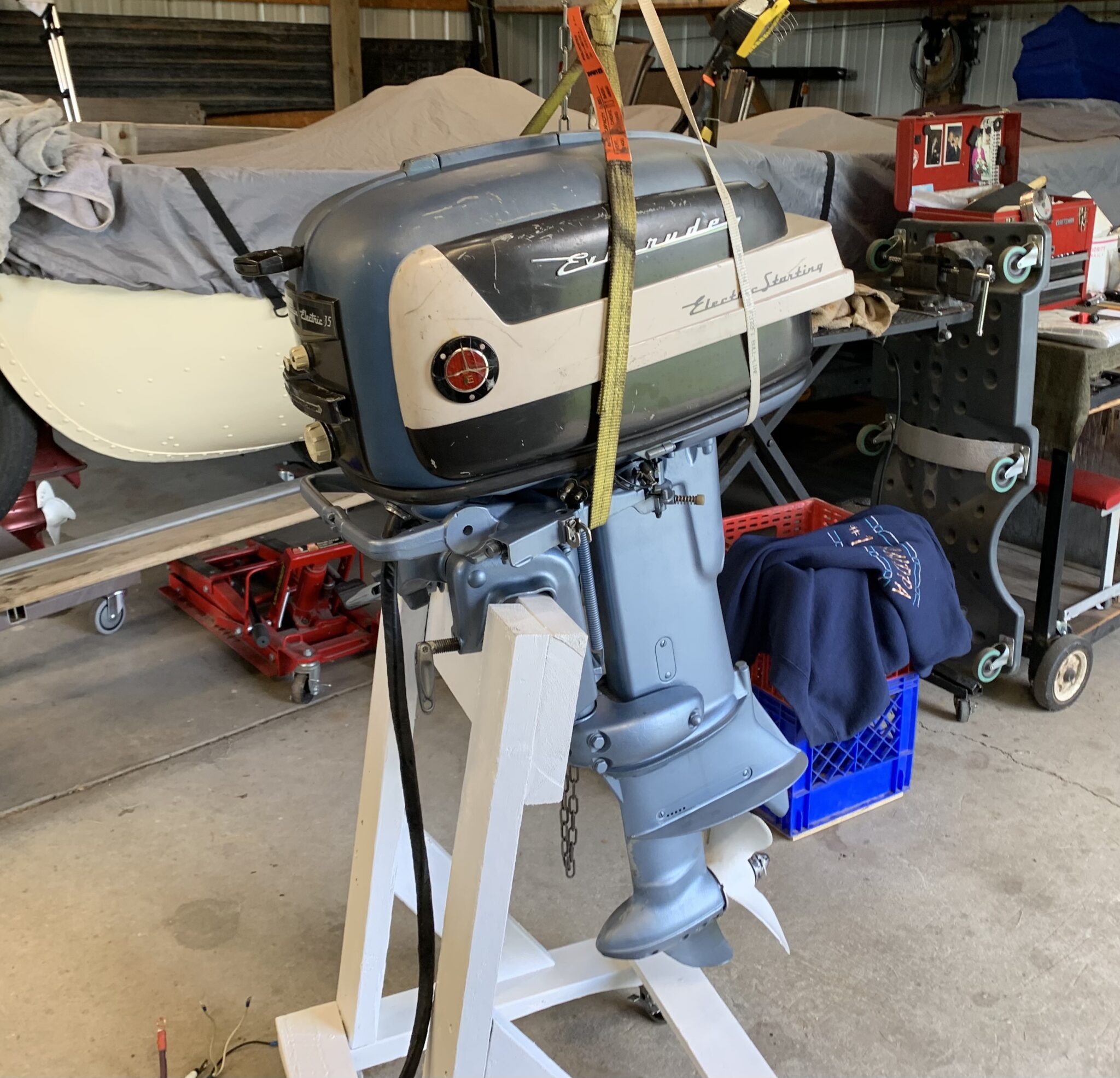

        One more quick question: I’m going to attempt to restore this cowling to its original look. I’ve been cruising the internet looking for images of cowlings for the 35 HP Big Twin to use as an example for how mine should look when it’s done. I’ve yet to find one that looks like mine. My cowling has a chrome Evinrude script  on it. See attached photo. I’ve not found a photo on the internet that has that. Thoughts?
        #296779
        CHUCK
          1957 Evinrude Brochure
          #296783
          aquasonic
            Your cowl may be the one with the “Electric Starting” badging. The “Electric Starting” 18 Hp has the same chromed “Evinrude” badge on the upper part of the cowl just like yours.
            Improvise-Adapt-Overcome
            #296789
            labrador-guy
              I have one with an original hood.  The electric start wire plug has been deleted for a pig tail hook up.  The hood is correct.  I was surprised it only weighs 130lbs.   Feels like lots more.
