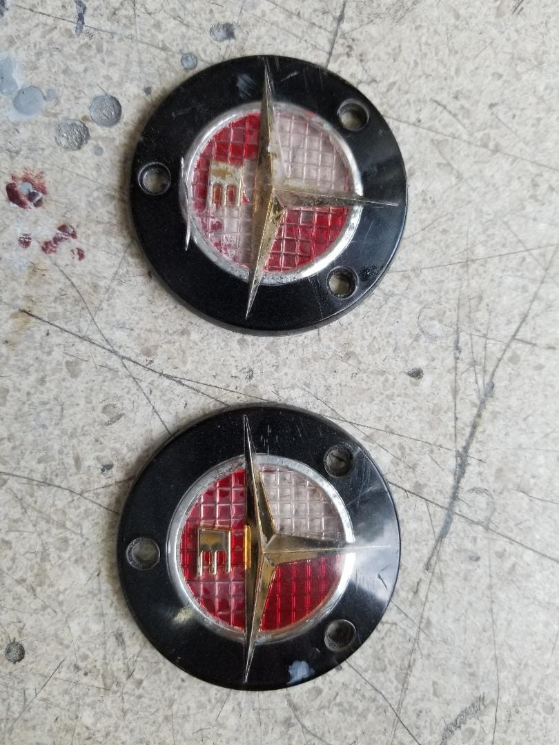

      Working on a mid 50’s Evinrude 15020. These emblems are scratched, the paint is chipped, you know, normal wear and tear. Has anyone restored these? Are there any procedures to restore these documented or available? Does any one make repops of these?
      Any help would be appreciated. Thank you
      Bill

              I have tried painting the worn areas with nail polish before but wasn’t too pleased with the results. Model paint might work better.
              #178363
              lindy46
                I believe those are painted on the back side. I’ve touched similar ones up using spray paint and a fine brush with pretty good results. Pretty delicate work.
                #178366
                huntleybill
                  Thank you all for your responses. My first issues is getting the old paint off. I have paint stipper but am not sure that the stripper won’t melt/ruin the plastic.
                  #178391
                  gjonz
                    Yes they can be restored with a very delicate touch.
                    The paint cannot be removed with anything that is too aggressive. It will craze the plastic which must stay smooth and clear. They are painted from behind , then a gray paint over the last color so it is opaque.
                    I use thin viscosity super glue to fill cracks and scratches. Build it up in layers then sand smooth going grit to grit through 1500 or greater wet dry sandpaper, then buff out with McGuire’s Polish…working from aggressive to fine usually by hand with a microfiber towel.
                    I use either testers enamel or sometimes a product for RC race cars that is Alclad Lacquer from the hobby store if the color is available. RC car bodied tend to be painted inside out like the emblems. Use an airbrush for this. The Lacquer or paint may be translucent when done, so that is where the gray back painting is important.
                    Hope this helps!
                    Greg

                    huntleybill
                      Thank you Greg. That helps a lot. What do you use to remove the old paint?
