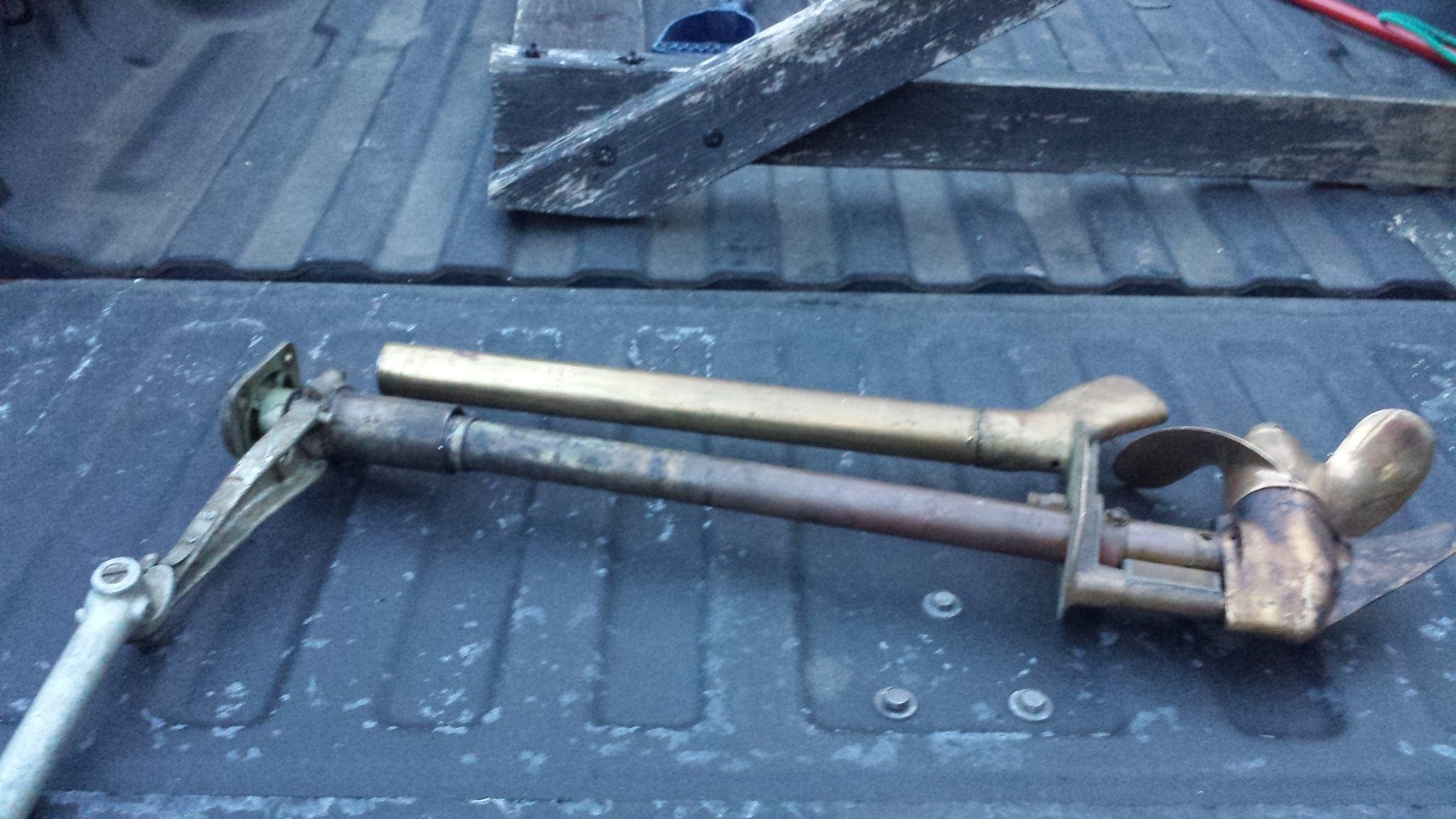

            #172183
            lyks2tinkr
              Thanks for the replies.
              I took a look on the cylinder freeze plugs and didn’t see any model and serial number. Perhaps it was replaced long ago.
              In the box of parts that came with it was a single screw transom clamp.
              The tag on the clamp is 4287 which makes it a 38 Sportwin.
              Did any other model in the 30s of similar size use that bronze lower unit?
              Thanks for the offer pmT2 I’ll consider it.
              20190328_191031
              • This reply was modified 7 years, 7 months ago by lyks2tinkr.
              #172285
              PM T2
                The lower unit was also used on models as early as 1934. The model 4016, for example, which is a 4 HP motor with underwater exhaust.
                It may also be the same lower unit as used on the 1932-33 motors like the Sportwin or Elto Fisherman, as well as some of the brass lower unit single cylinder motors. The difference would have been in the size of the anti-cavitation plate. 1932-33 motors had a very small one, the 34’s were larger. The anti-cavitation plate was part of the water pump, as you can see in your photo. I’m attaching a picture of my 1932 Evinrude Sportwin for reference. Hope this helps.
