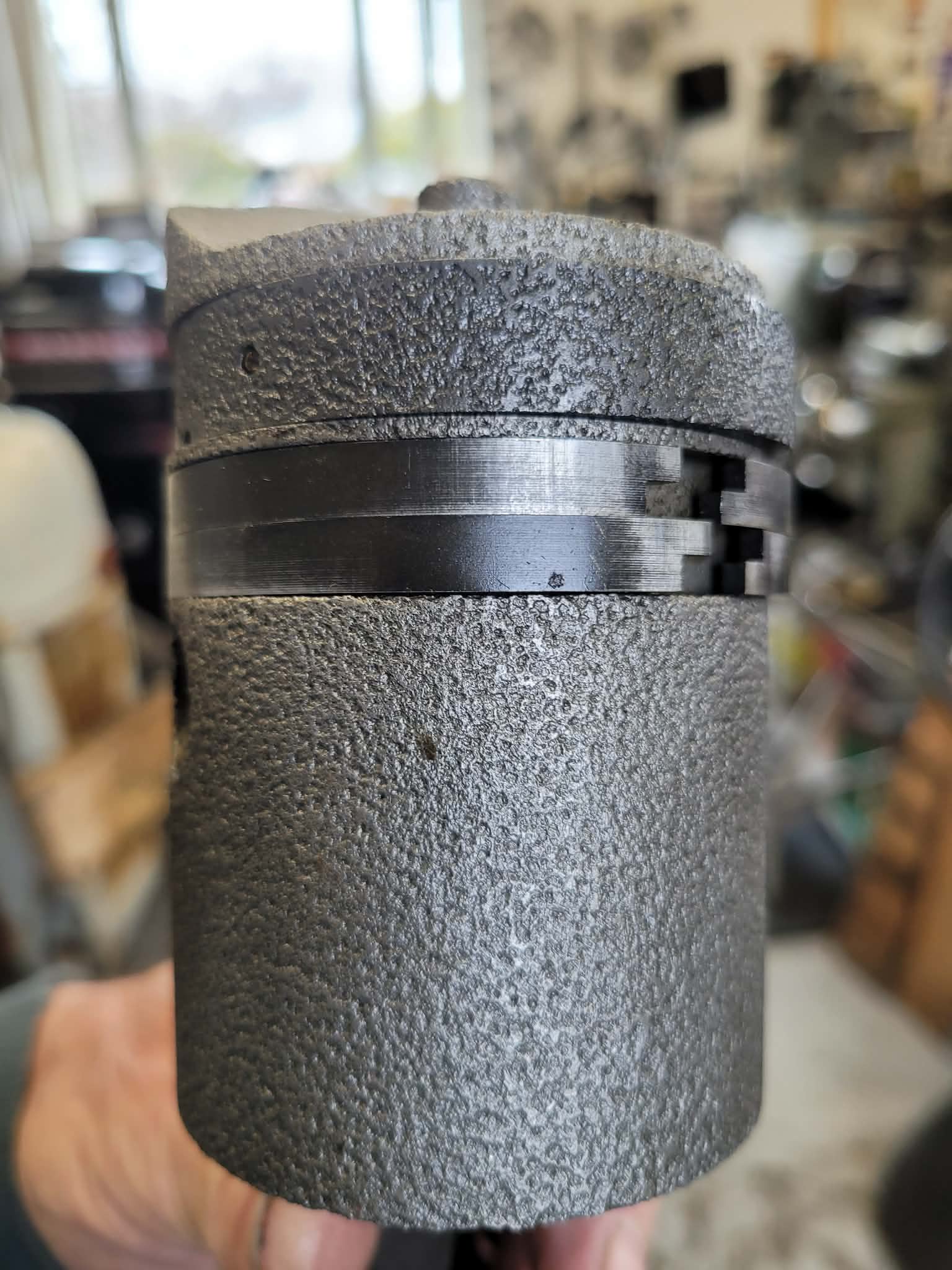

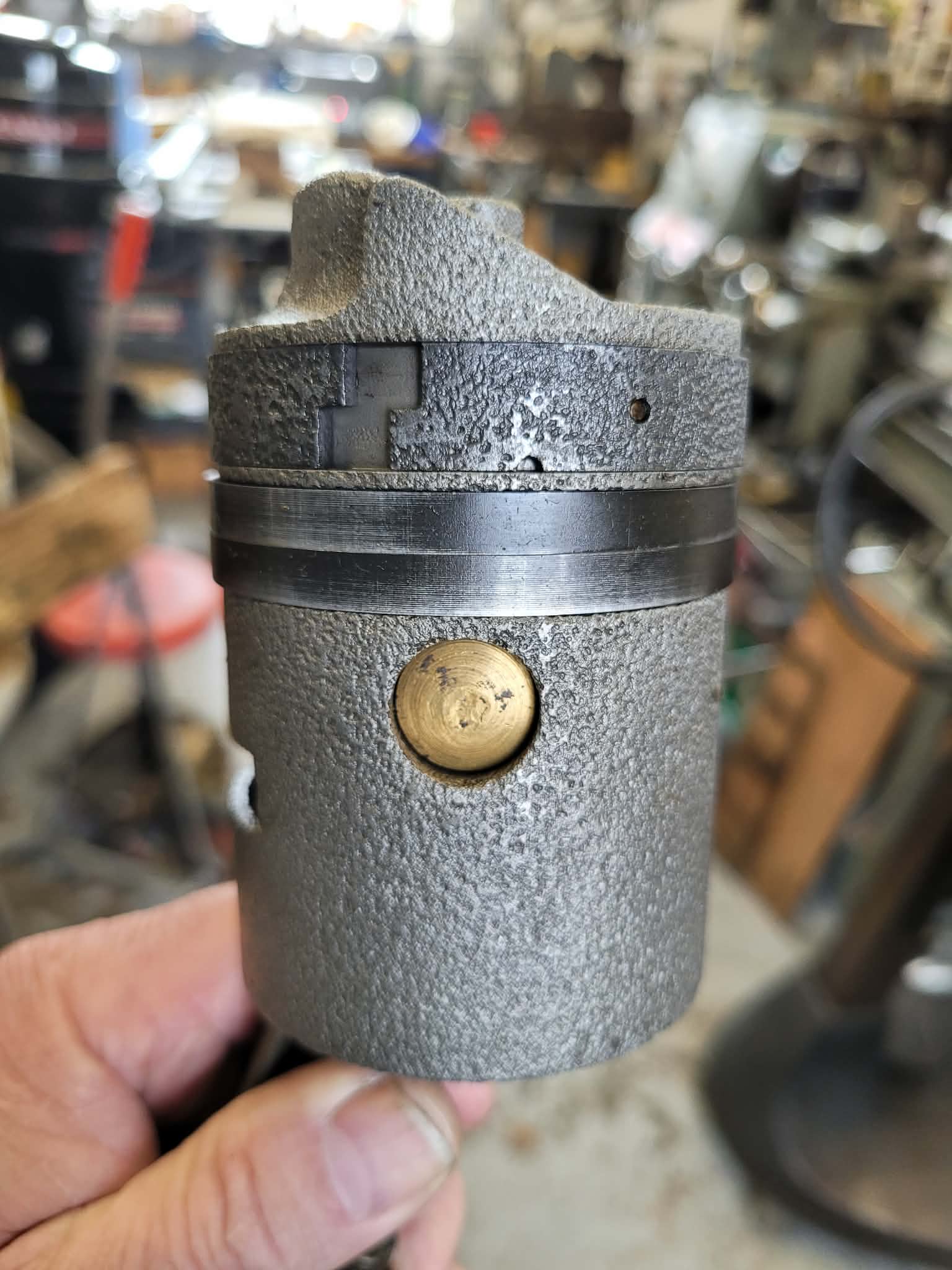

EDIT – As promised, here are images of the piston I extracted from its bore, then loosened the remaining piston ring that wasn’t broken. For the record, the ring was already broken by the time I got the piston out.
As you can see, the rust pitting is quite heavy. The intact ring was rusted into the groove. It took about a half-hour to get it freed up. Granted its a big wide ring which may or may not have helped, but the point is it was badly rusted and still came out in one piece.
