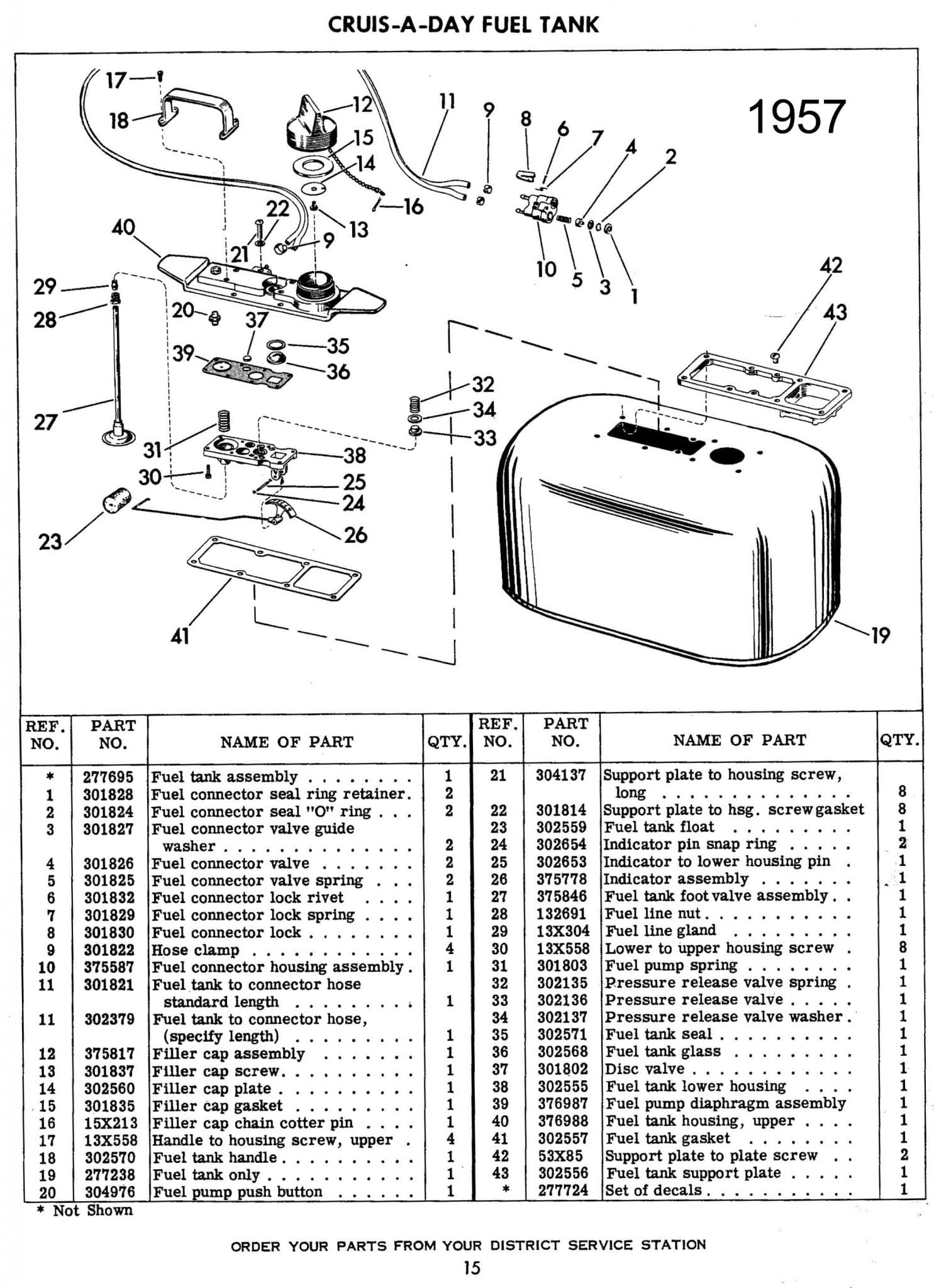

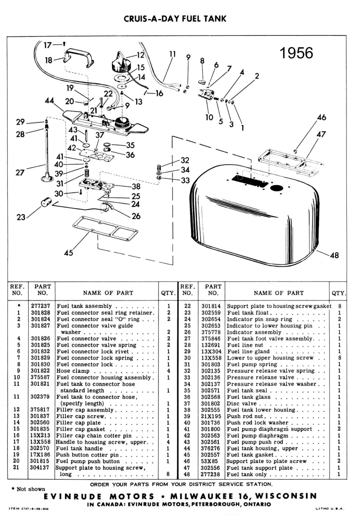

          The tanks with the metal button and push rod/plunger were generally used up to around 1956/57. The difference between those and what came after are the handle assembly housing, diaphragm and the misc. bits related to the push rod/button, etc. (In various 1957 parts manuals I’ve seen some tanks with the metal button, some with the black plastic).
          1956-tank
          1957-tank
